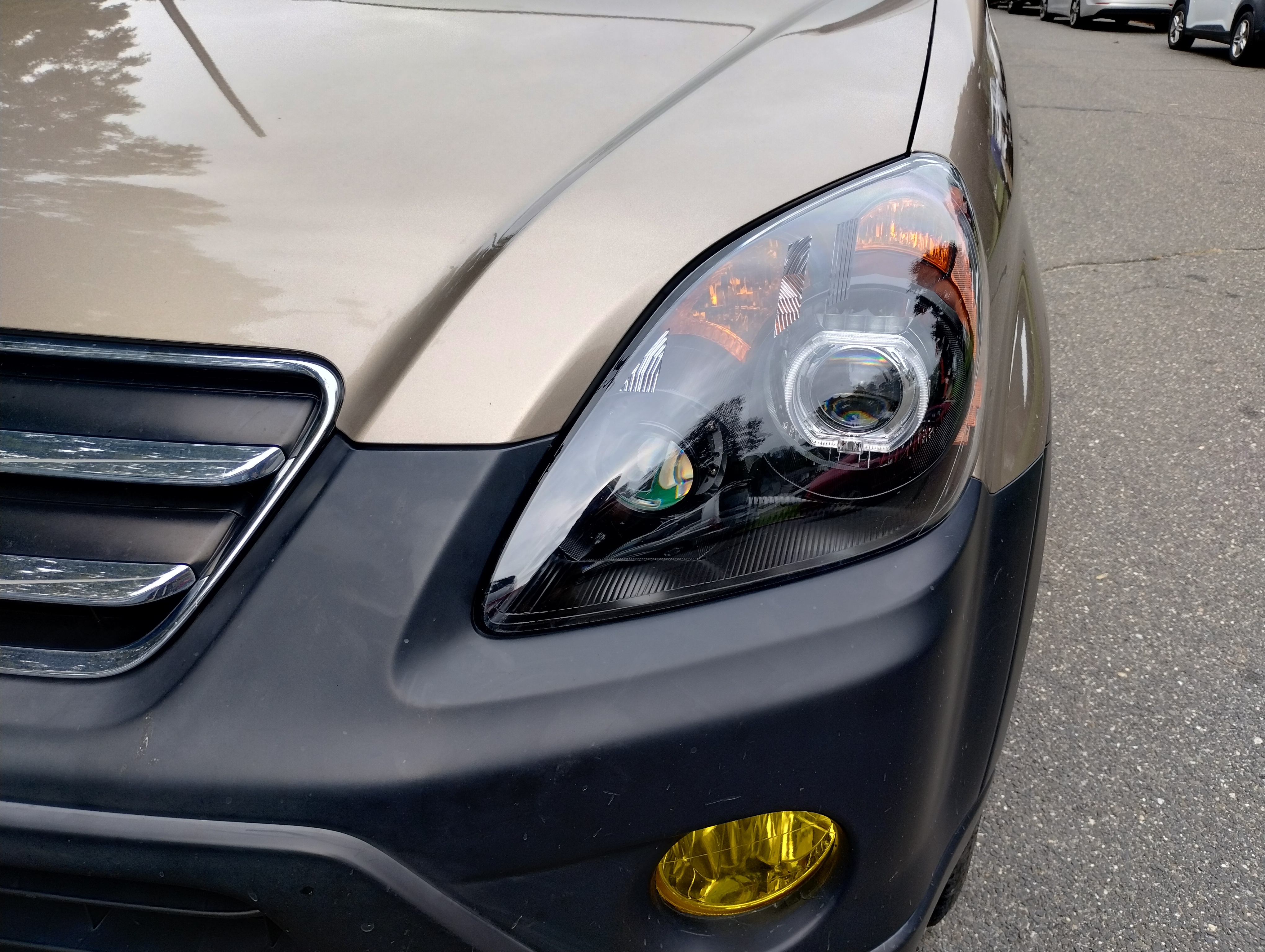

I experimented with LEDs in the stock headlights and failed. the way the bulbs are mounted do not make it easy for bulb mods. so i went full commitment. i bought some black housing aftermarket headlights and did a complete retrofit with led projectors. 4 of them. i also installed ebay yellow lens fog lights with amber LED bulbs.

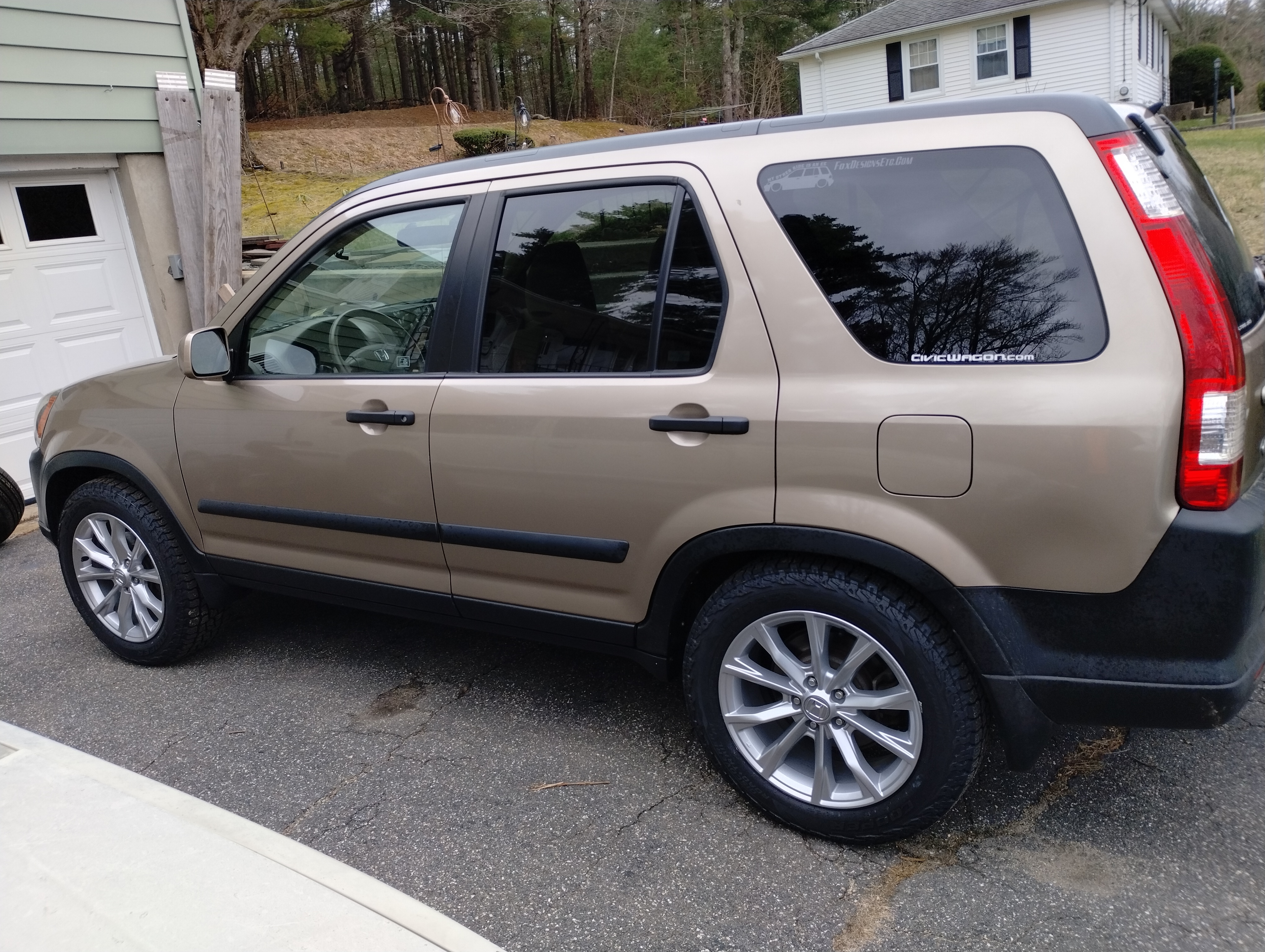

i came across some 23 crv wheels for free99 from work. i put some cooper discoverer road and trail a/t on them. complete with full size spare.
the tires in the rear rubbed from the saggy rear springs. i got new replacements and got the HRG rear leveling kit. sits perfectly now.
The CRV looks super clean, That’s a real nice color too. The wheels look great, retrofit headlights are so much better with light output.
I always wanted to attempt to retrofit my 9th Gen stock housing but I paid someone local to do it but bueno think I can do it myself
