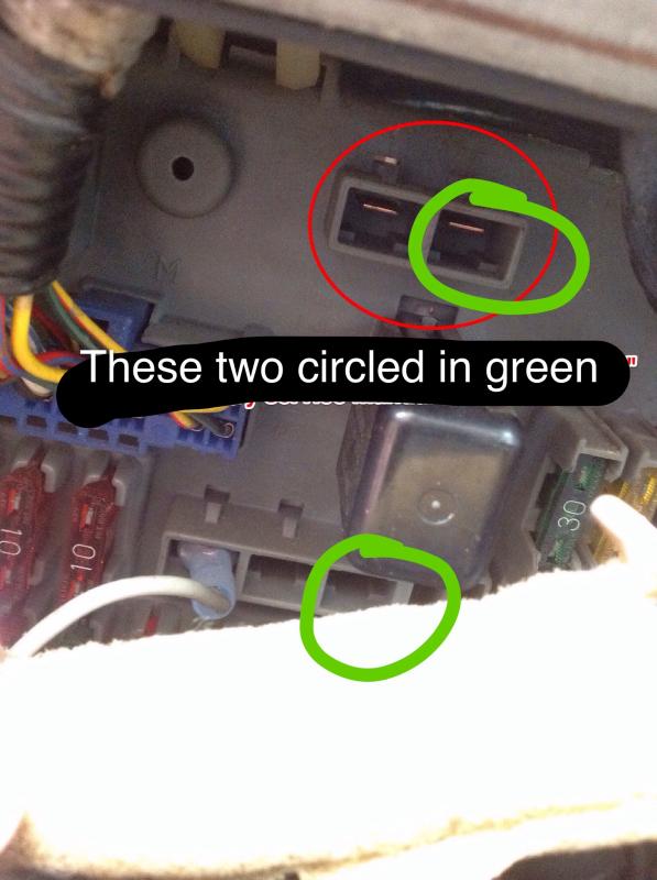

After that, where to put this fine dandy?
Right there! Like I said in the pic, this is labeled as "optional" in the fsm. Maybe someone else knows what goes there? Perhaps some higher trim level option or jdm/edm stuff?
Either way, just access your fuse panel under the steering wheel and at the top of it you should see these empty sockets. You simply connect the little piezo module to them, you may need to flip it if it doesn't come on, but beyond that you should now have an annoying little reminder if your lights are on and the engine is off.
Tiny, and easily tucked away.

Though there would be a relay involved for the fog lights right? So maybe it flips over to there. Either way, not sure, and the factory service manual isn't very clear on it either. If anyone knows for certain, chime in.
