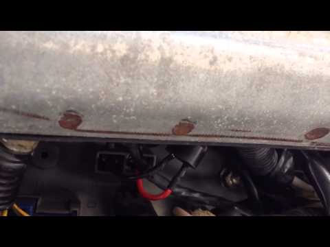

After that, where to put this fine dandy?
Right there! Like I said in the pic, this is labeled as "optional" in the fsm. Maybe someone else knows what goes there? Perhaps some higher trim level option or jdm/edm stuff?
Either way, just access your fuse panel under the steering wheel and at the top of it you should see these empty sockets. You simply connect the little piezo module to them, you may need to flip it if it doesn't come on, but beyond that you should now have an annoying little reminder if your lights are on and the engine is off.
Tiny, and easily tucked away.

    I tried this on my '91 and it didn't work. I left the red lead in the port on the right, and plugged the black lead into the open far right port at the bottom of your second picture(there are 3 ports, you have a lead already in the port on the far left) and it works fine.

    thats gotta be a plug for a oem foglight id assume! would make sense if it clicked on and off with headlights right? good call i never saw this before. i never trip off draining a battery though ive done fred flinstone methods always tried and true.
  • I'm not entirely certain what it's for, I'll have to check what the fuse cover said, it was sort of ambiguous from what I recall though. It might be for some additional lights, but the power cuts out to those terminals when the motor is running, otherwise that thing would be squealing the entire time the lights are on.
    Though there would be a relay involved for the fog lights right? So maybe it flips over to there. Either way, not sure, and the factory service manual isn't very clear on it either. If anyone knows for certain, chime in.

    Sorry it took so long, my phone is being a putz and won't take a good picture. I wrote on yours where I plugged my buzzer in instead. Still works perfectly with headlights or marker lights on.57.jpg
  • Interesting. Good info though, I wonder what that other port is for. Either way, glad that works.
