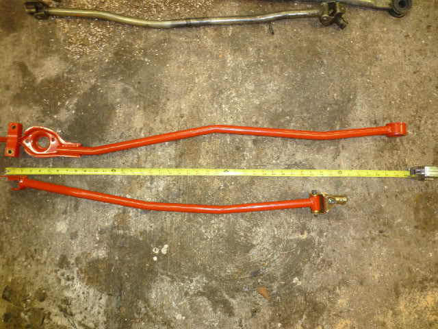

bought the linkage for my 1990 wagon dx with b16a swap (ys1 gearbox), and each piece is just under an inch too long.

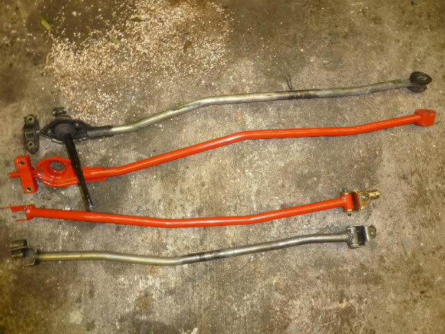

Here are some pics

I guess it would also be prudent to measure both the cut and uncut stock linkage, as well as the after market one.
