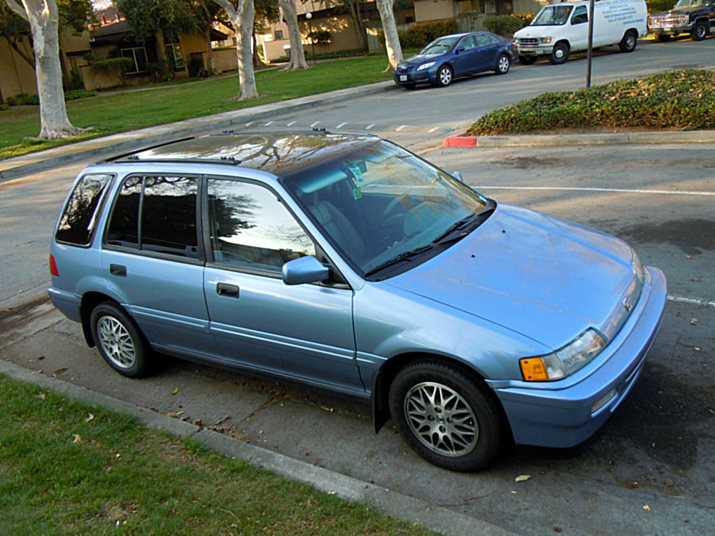

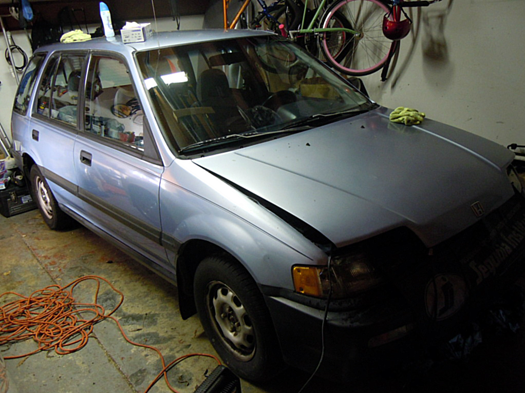

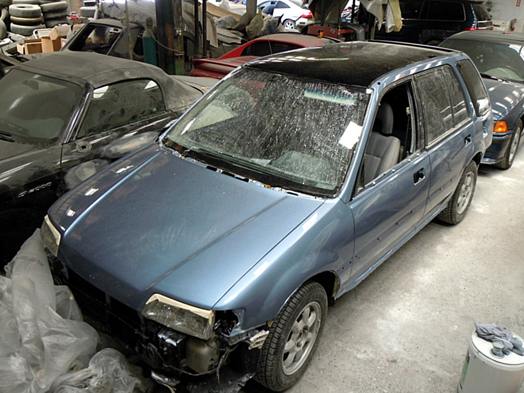

I saw it at Craigslist and i bought her for $300 last summer. 180k and a broken timing belt. Luckily, none of the valves were bent and it runs smooth after the timing belt was replaced.
Sorry, this is the only picture i took when it arrived at my house.

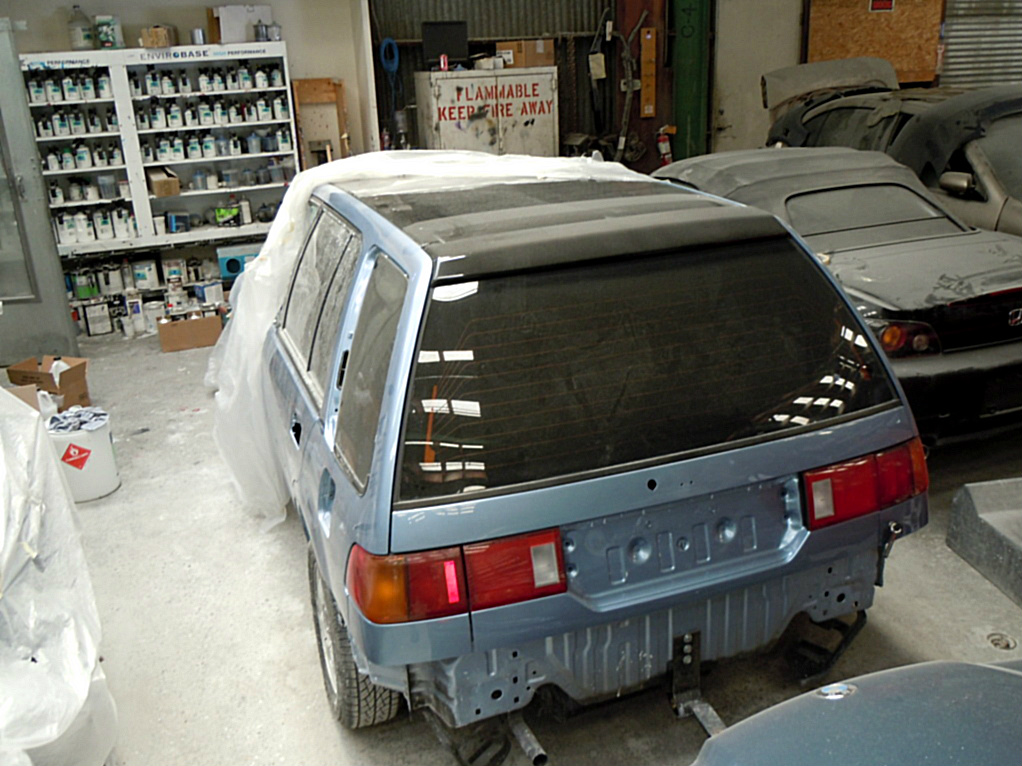

At the body shop painted with S2K Suzuka Blue.

with the roof rack removed

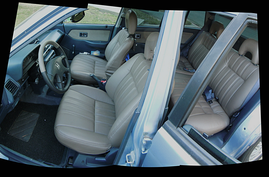

seat upholstery replaced and steering wheel re-wrapped.

Seats are bad a@@!, did you do that yourself?
thanks guys for a comments! trying to do smoethign different with the molding so i got them painted.

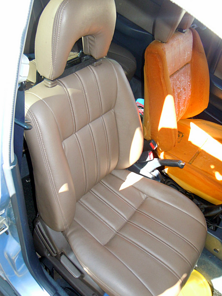

about the upholstery, i went to the junkyard and strip the seat upholstery, headrest,and steering wheel out of a wagon i had it made overseas. all in all costed me $210. And i installed it back myself when i got it back.

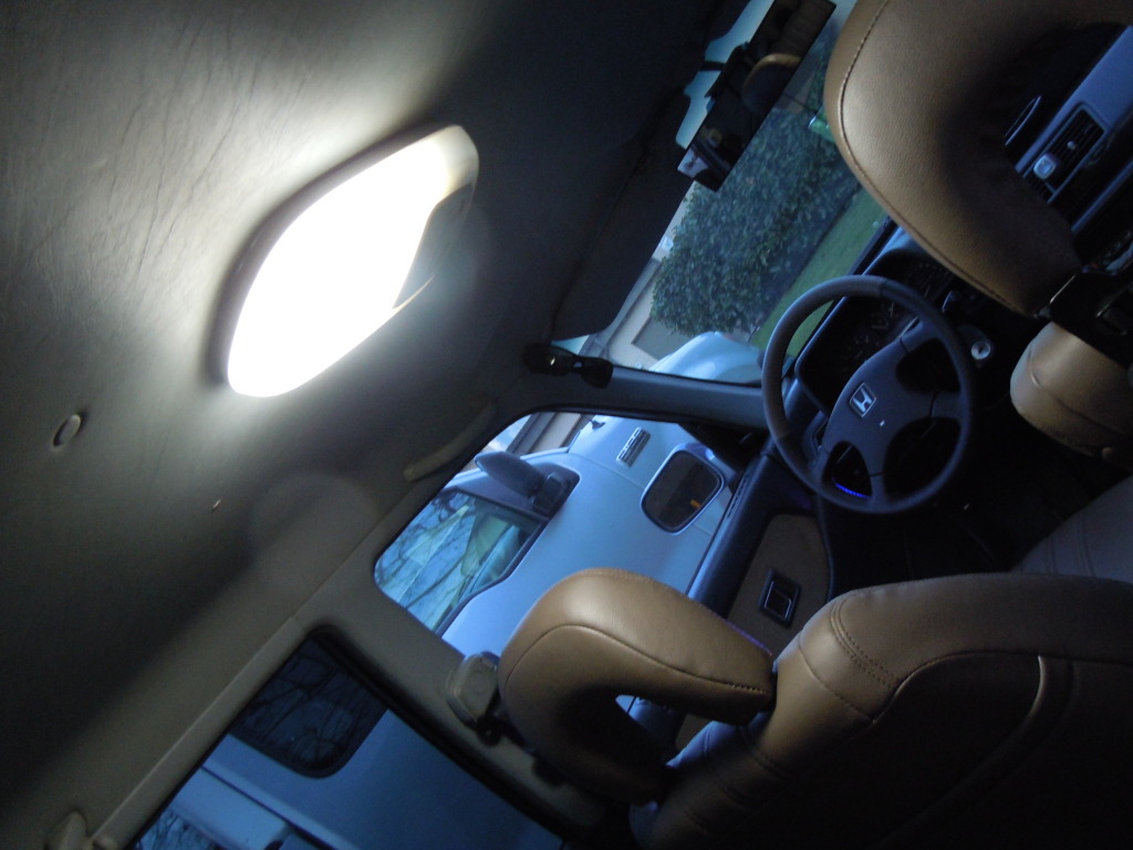

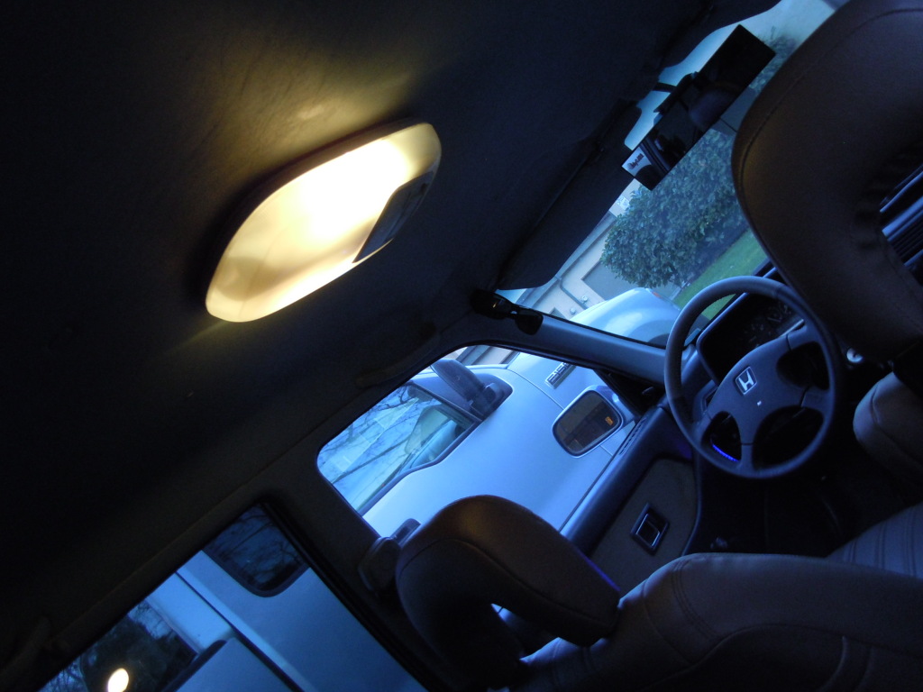

Flourecent light on.
Door light on.

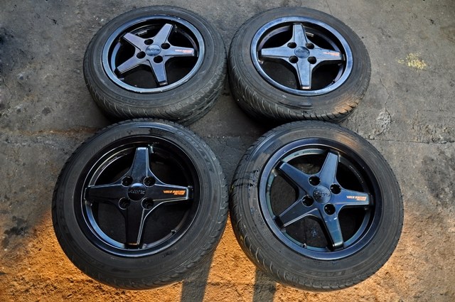

I am waiting for this sets i bought overseas. hopefully i get them soon.
It is Volk Rays 4/5s 14inch +40offsets. something different for sure.

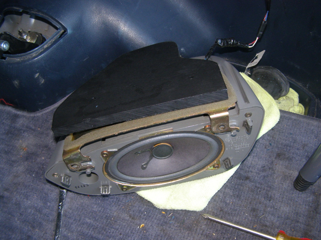

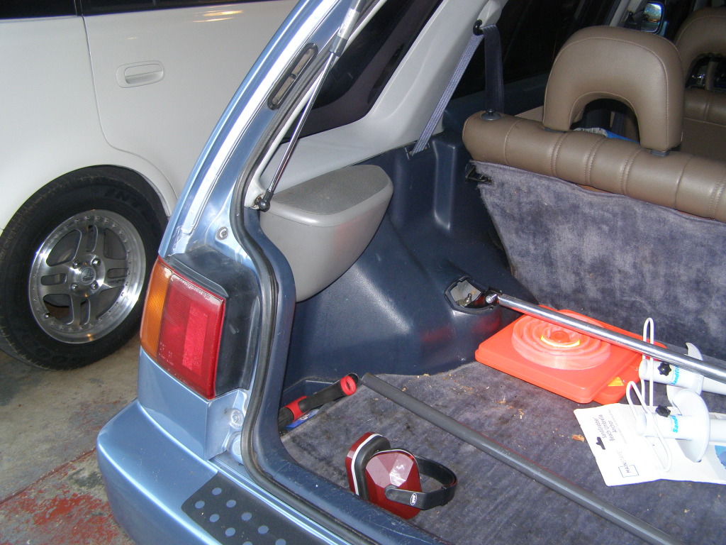

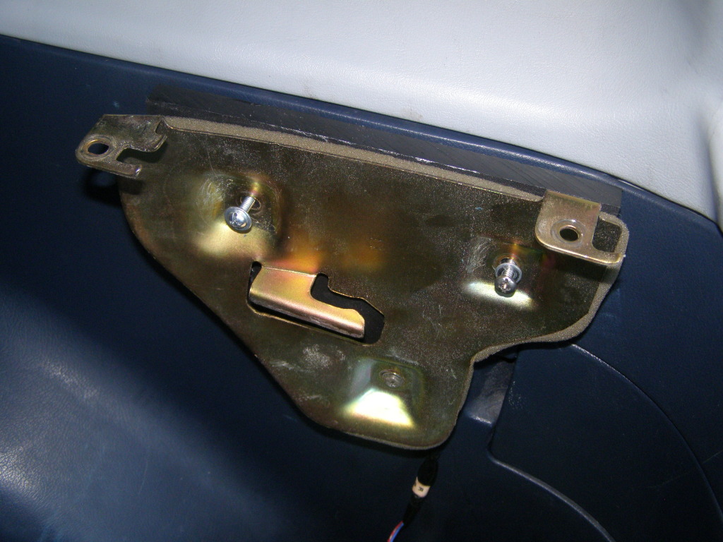

Found a set of rear speakers off an Isuzu Rodeo (95-97 i think) for $20 for the Pair at the junkyard. Also bought a half inch plastic spacer from TAP plastics. Cut the plastic same shape as the speakers metal mount.
mount installed using a threaded rivets riveted inside the cars frame.

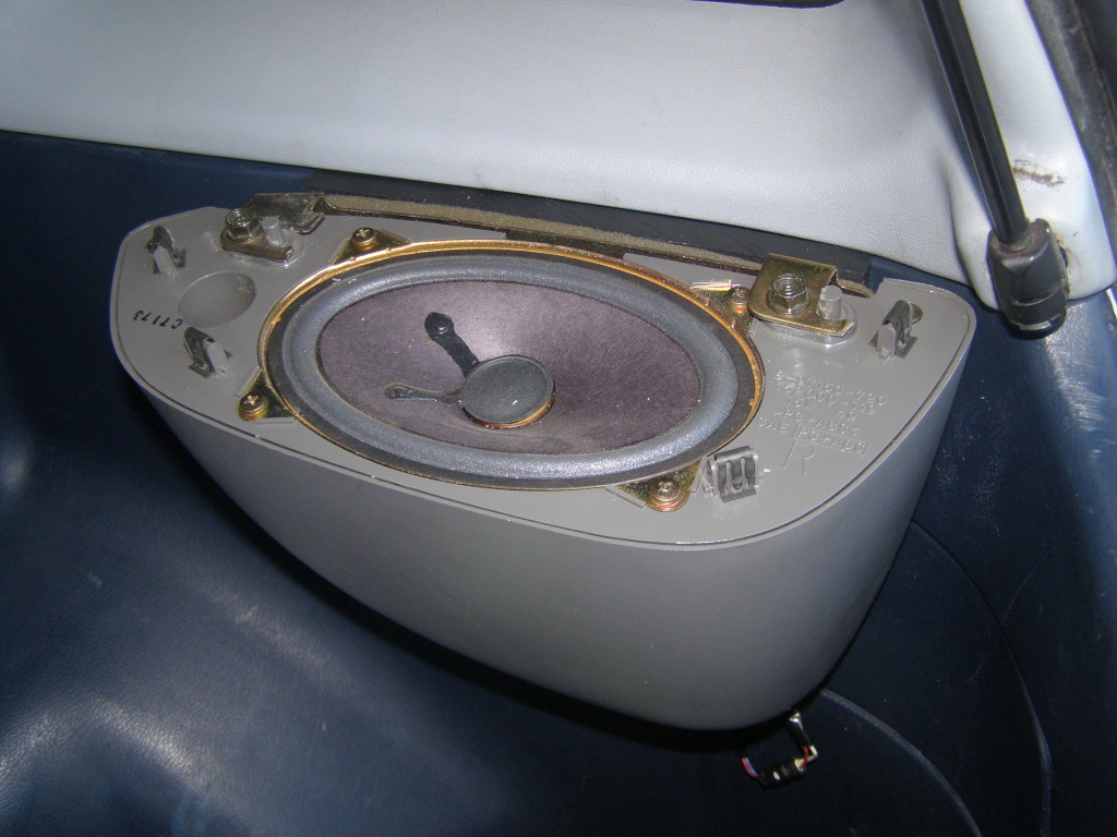

Speaker installed :smug:
