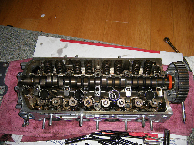

I have a problem with the engine. I got the head back from the machine shop for replacing two bent valves. I got everything put back together exactly the way it came off. The timing is correct and the wires are connected correctly I believe (on the head 4-3-2-1, and distributor:

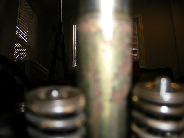

As you can tell, the valve on the right is taller than the one on the left. The two bad ones is the right exhaust valve on the number 1 cylinder and the right exhaust valve on the number 3 cylinder

Sorry the pictures are so blurry lol
