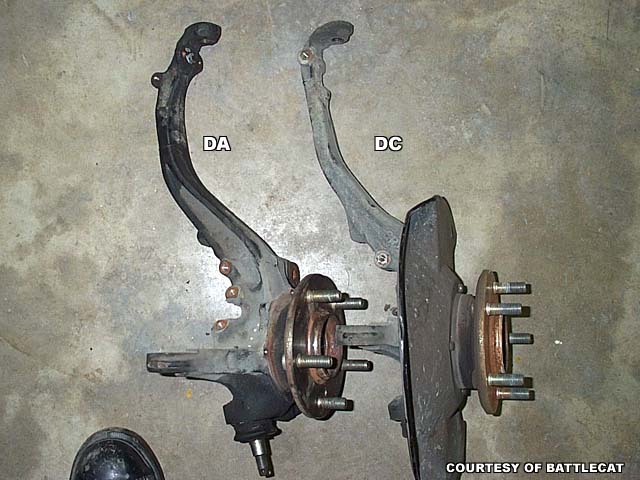

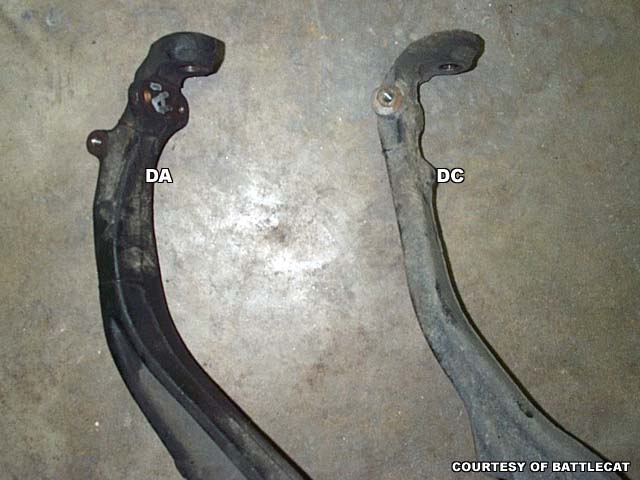

    Off topic but it sounds like you are putting eg brakes on a ef/da? If so that isn't going to work very well, knuckles are very different.
    On the brake lines, I went through the same thing on my brake swap. For the most part all factory disc hondas use the same brake lines, just different lengths.
  • cstanya88cstanya88 New Wagonist
    Oh damn.. Will it fit and work...? Cause I was looking at them side by side and they look exactly the same..
  • I wouldn't recommend. Your geometry will be off IE(massive amounts of negative caster and positive camber) If you still want to run them you will need a camber kit, depending on how low you are other issues may apply.
    Stick with DA or EF EX knuckles/brakes.
    Note, DC are the same as what you claim to have 92-95 civic ex
    Okay kool... Thanks man.. I guess i can hold out for awhile.. Back to the junkyard..
