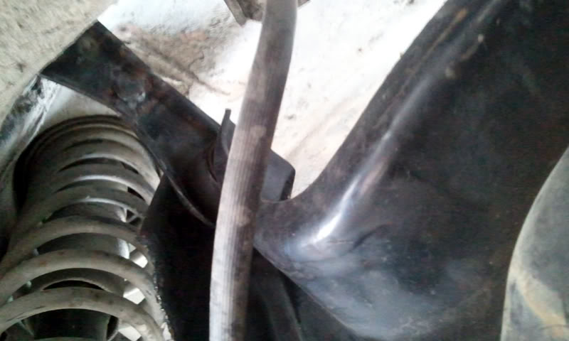

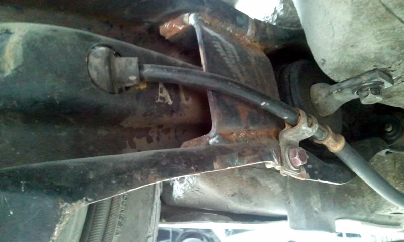

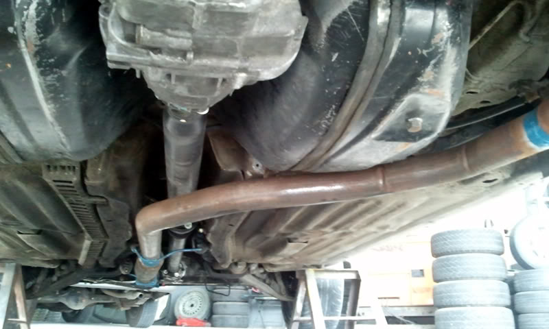

anyway ive finally done what i was going to to ages ago. i didnt get to take pictures while i was on the build but hopefully some aftershot will suffice. thanks.

Did you reinforce the trailling arms at all or just cut and weld?
fabbed up some transmission mounts
fabbed the oil pan (got too hot from the acetylene torch and warped, got to buy a new one to make because its leaking
cut the driveshaft 80mm
cut the fuel tank to make room for the diff mount and shorter chasis
cut trailing arms 45mm(beleive it or not the easiest one to do)
cut upper trailing arm 50mm, should have been 40mm hehe
these are the easy ones to do...except maybe the fuel tank(hardest). its the small bullsh*t that takes time.. you can spend the whole day measuring and thinking what to do but sometimes doing it on the spot makes the best out of it. for instance the rear differential mount its the simpliest, lightweight, strongest, fastest to do, yet before that i thought of all the design and scratching my head on the process of doint it...
