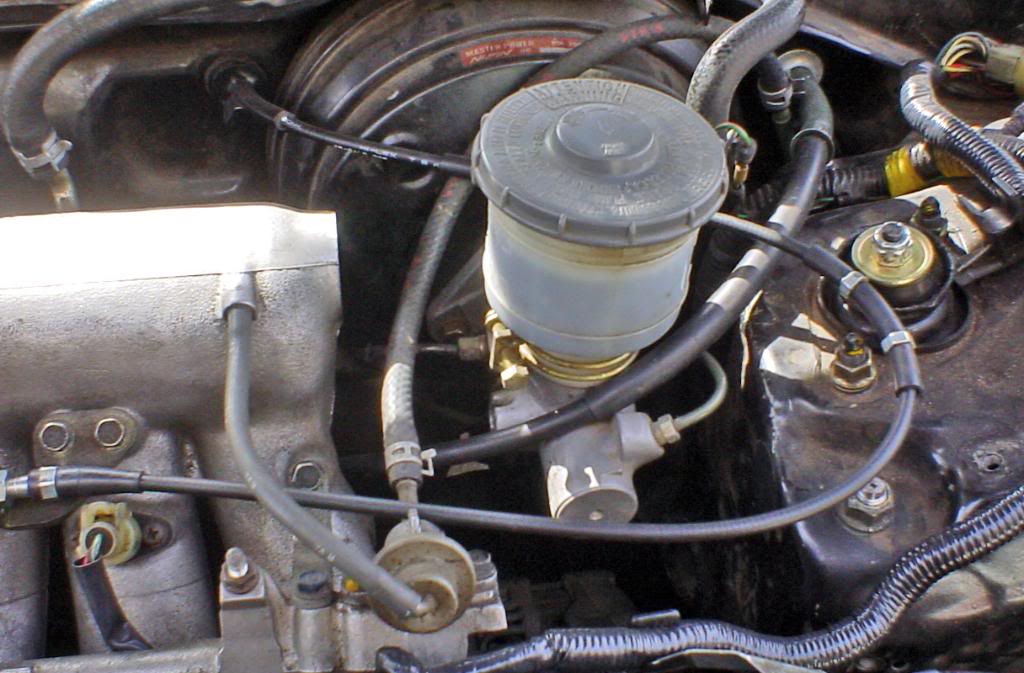

Ive got a 91 RT and am looking to do a huge brake setup on it for future time attack events and so forth. I picked up some 05 Acura RL front calipers and am working on the rear setup but need to change it to disc brakes first. My real question is a master cylinder upgrade. Id like to go with a 1 inch bore but it seems difficult to find one that is a direct bolt on. I know about the 15/16" masters that can be used but I'm looking to go bigger in order to fill these massive calipers with enough fluid. Anyone have any suggestions?

  • '94+ Integra GSR. You'll have to move one brake line and you'll need the booster, too. I have one in my CRX.

    If the booster turns out to be a direct fit, you can swap to a ITR 1" master cylinder with either a EK or ITR brake booster onto your car.

  • You'd have to keep the GSR booster and it is a bolt-on with the exception of moving the brake line. It's bolt pattern on the MC is opposite of the ED/EE.
    ...and the GSR is a 1" 2-port MC already.

    I do remember having to replace the fitting on the brake line that is moved with the fitting from the master cylinder. The ID is the same, but the OD is bigger.

    After reading this I did some checking, and apperently any Master Cylinder on any 98+ integra (Excluding the RS model) had a 1" bore.
