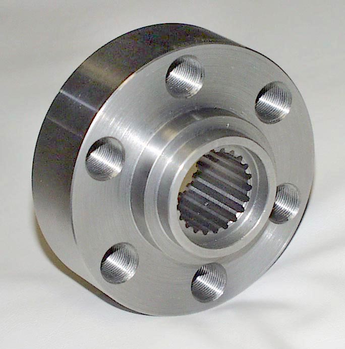

    Here's a recap, for the late joiners and those who don't want to look through the entire thread:
    Have: Stock '88 manual 6-speed 4WD tranny, with 200mm flywheel and matching clutch and throwout bearing.
    Want: Lightest possible flywheel. About $200 all told. Used parts acceptable. The regular gasoline-powered constraints do not apply: the electric motor needs no starter, never stalls, and is connected to the wheels practically all the time, even at stoplights.
    Obstacle: There seem to be no performance parts for the '88-89 200mm setup.
    Candidate solution: There are plenty for the '90-'91, which has a 212mm setup.
    Question:
    Will a 212mm '90-'91 flywheel fit in my '88 4WD tranny? I plan to remove the starter ring, if that's the big difference. Will I need to replace my '88 clutch and throwout bearing at the same time?
    Thanks again
    yes u can use the 212mm flywheel in your 88. i did in mine so i know for a fact.
    :D The only thing you need to change is the pressure plate,when u change ur flywhl.Everything else is the same. :mrgreen:
  • Outstanding! At the risk of overusing the bold tag, thanks to everyone for such prompt replies!
    I appreciate the help. E-Bay, here I come.
  • I recently purchased an aluminum flywheel (7.5 lb) with a stage 1 racing clutch, supposed to be for a '90-'91 CRX.
    It doesn't fit.
    The flywheel looks like it'll fit with little trouble. It might scrape the inside of the case, but that'll stop when I take the starter ring off.
    The pressure plate might fit. The hole in the center looks the same, but there are fewer springs than the original pressure plate. I'm still working on that.
    The friction disk doesn't fit over the transmission shaft. The splines are different; it looks like they're off by ONE FARKING TOOTH. It's possible I can use the old friction disk, but I'm still checking into it.
    And finally, although the throwout bearing looks identical, the pilot bearing is too small to fit over the shaft. More on that as it develops, too.
    So, anybody know someone who wants a brand-new flywheel and clutch kit for his '90-'91 CRX, $225? And what *will* fit in my '88 RT4WD?

  • Well, a more thorough examination shows that the '90-'91 CRX flywheel is actually exactly the same size as the '88 AWD (at least the version I got).
    The friction disk is slightly different, and not just in the transmission shaft teeth: the wagon disk is slightly smaller (both about the same width, but the wagon has a smaller inside diameter). Therefore the pressure plate will be pressing on less area. This is not a problem in my application, but it may be for yours.
    The pressure plate is bigger, but not deeper. It should fit with no problem.
    The pilot bearing -- according to my brother, the ex-mechanic -- is specific to the flywheel.
    Finally, we'll be using the original throwout bearing, since it's practically new.
    All told, the only parts I won't use from the upgrade kit are the friction disk and the throwout bearing.
    Thanks to everyone for their input. I'm ready to advance my project!
