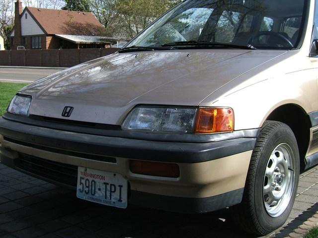

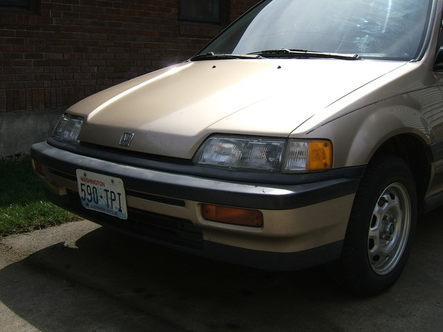

Civic Wagon/Shuttle:
Notice that the lower end goes straight down towards the FRONT of the car without curving, and the use of a plastic bumper filler (the wagon in this pic has a JDM EF bumper and painted bumper filler... but you still get the idea
). Also, 88-89 have two screw holes in the corner lights, 90-91 do not.

I dunno where the all amber JDMness came from?
EDM/JDM had clear corners, amber tails.
all that amber corners stuff i believe might have been passed down from certain JDM CRX's or idk, but its not in anyway OEM/JDM/EDM/etc for the EE wagon.
USDM corners are 1/2 clear 1/2 amber(orange). (USDM outer tails are 1/2 red 1/2 amber)
EF hatch/sedan corners will NOT FIT!! check the first post on this thread
so if you want TRUE EDM/JDM clear corners you are going to have to find someone with them.

This part is wrong, but just barely. The 88-89 headlight assemblies dont have the upper tab for the screw that holds the 90-91 corners on. So if you want to convert to 90-91 corners to eliminate the two screwholes that are visable on teh 88-89 corners, youll either need to make a mounting tab for the corner light or get the headlight buckets from a 90-91 car.
