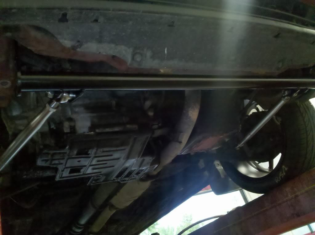

Followed by some traction bars. Got these mainly for the adjustable caster feature, being it has an auto trans and no imediate plan for HP upgrades.

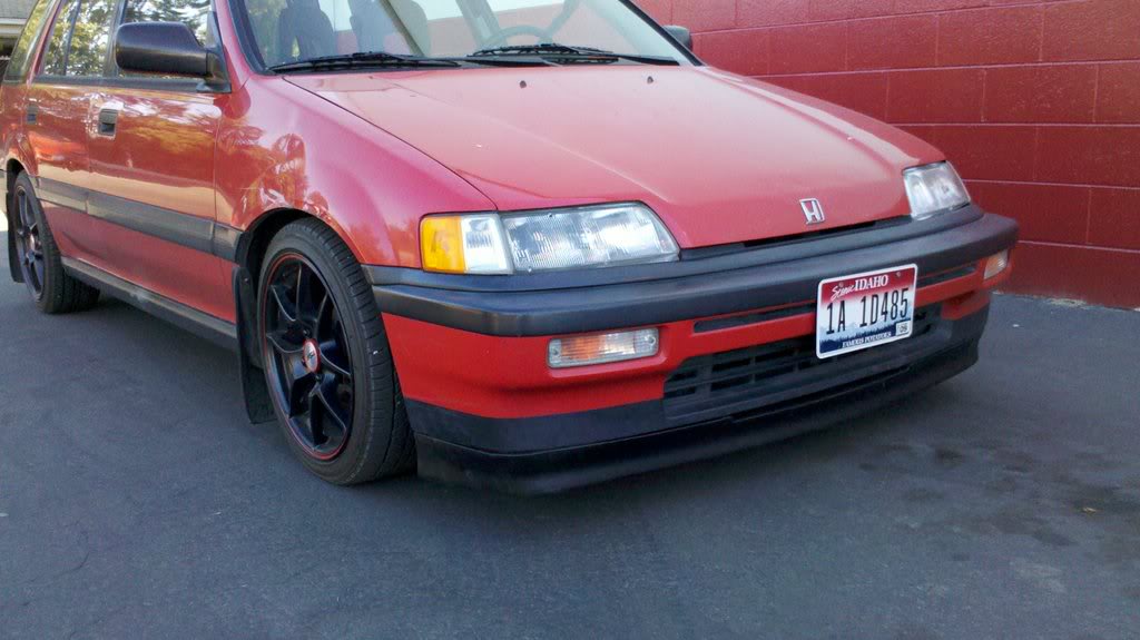

And the new wheels and tires! And it rides amazing! 16x7 tsw trackstar's, 205/40/16 zexuis

    Only thing I feel it needs is maybe some 205/45 tyres, 40 profile looks a little small
    Oh Ehm Gee!
    keep the Original rims, i like em better. (just my taste)

  • She's a bute!
    I dig your traction bar, what make is it, how much did it cost?
    Got one on my Si, but the heim joints are bad, so it makes some noise. alot.
    Lookin to get two.
    Pink coils on a red car is fine

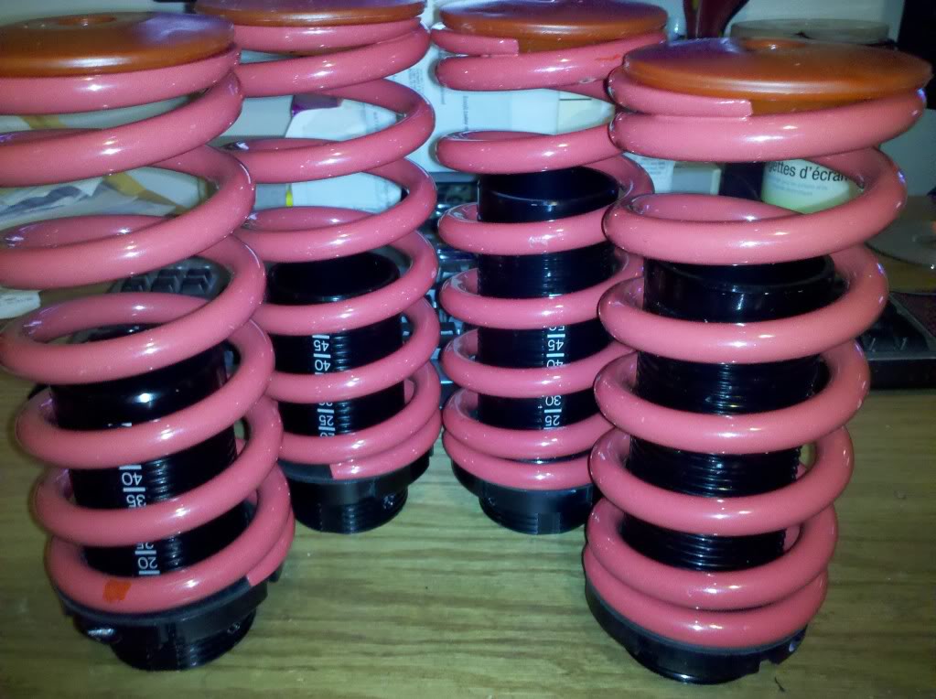

    The coils are actually very red, for some reason the picture turned out pink, didn't feel like retaking the picture. The traction bars are via ebay generic brand. I would recommend a better quality joint personally. I'm sure if you took a few measurements and did some searching you could find a better quality and a reasonable price. The complete traction bar kit was around $130 shipped
    nice stuff thats the traction bar i was thinkin of pickin up.

    What kind of coils are those?
  • tfnaaftfnaaf Band Wagon
    Ebay stuff, it actually rides very nice.

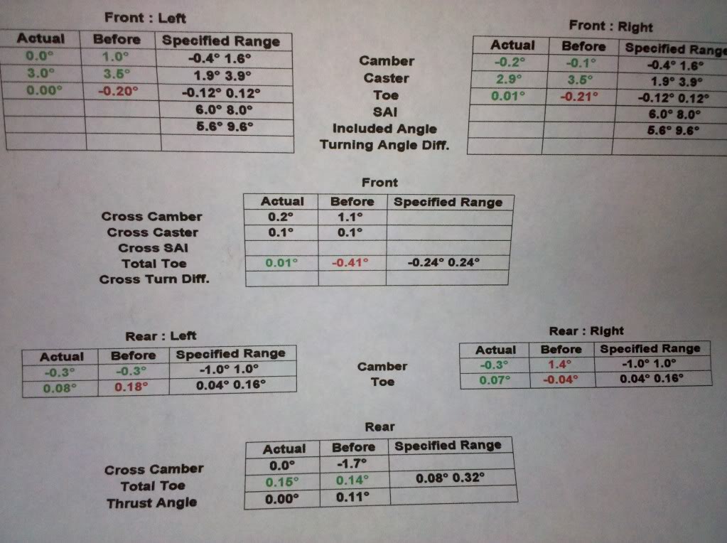

    Well, couldn't sleep this last sunday morning so made it to work around 7:30 am or so. To install the much needed camber kits! And dialed in the wheel alignment.
    Here is the final wheel alignment set for tire wear as i don't plan on dodging cones....

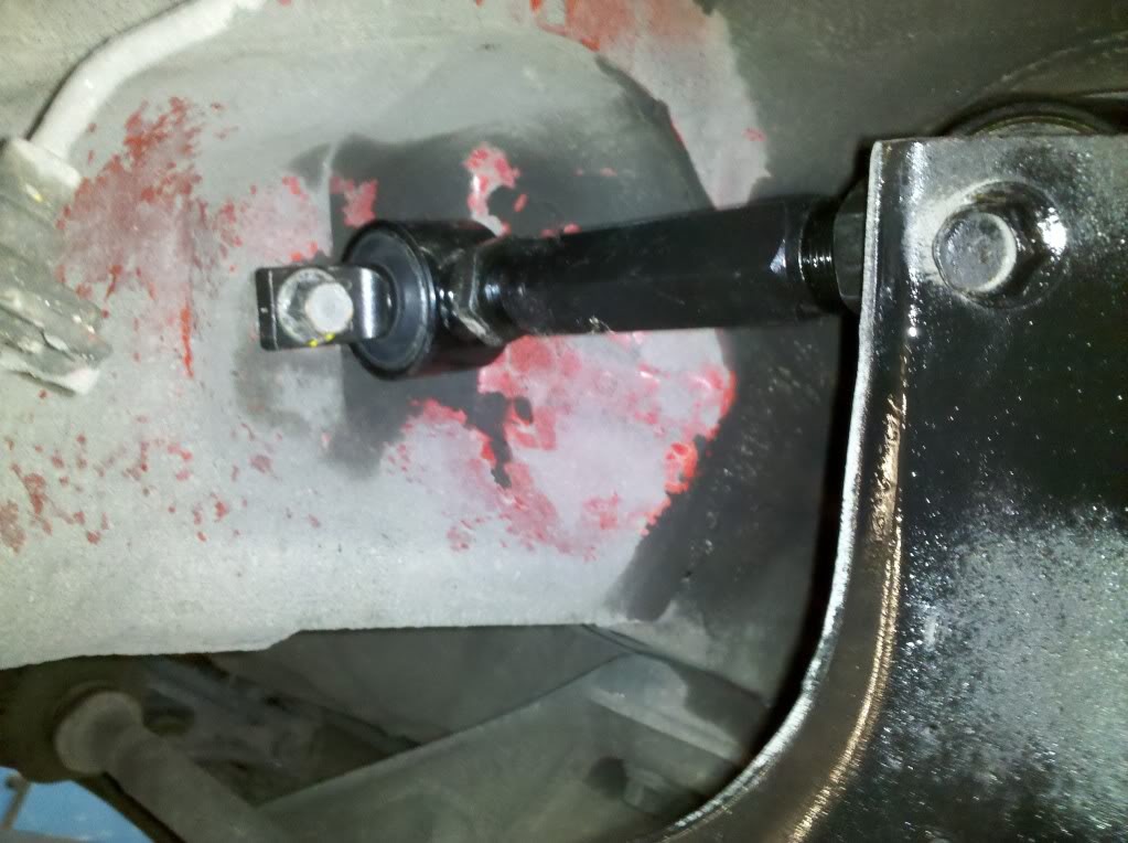

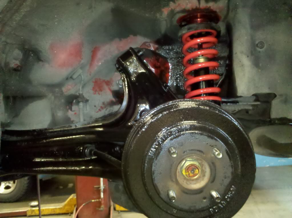

    Camber kits front and rear....
    Front kits installed....
    Rear kits installed....
    Did a little touch up on the drums and trailing arms.....

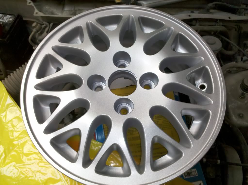

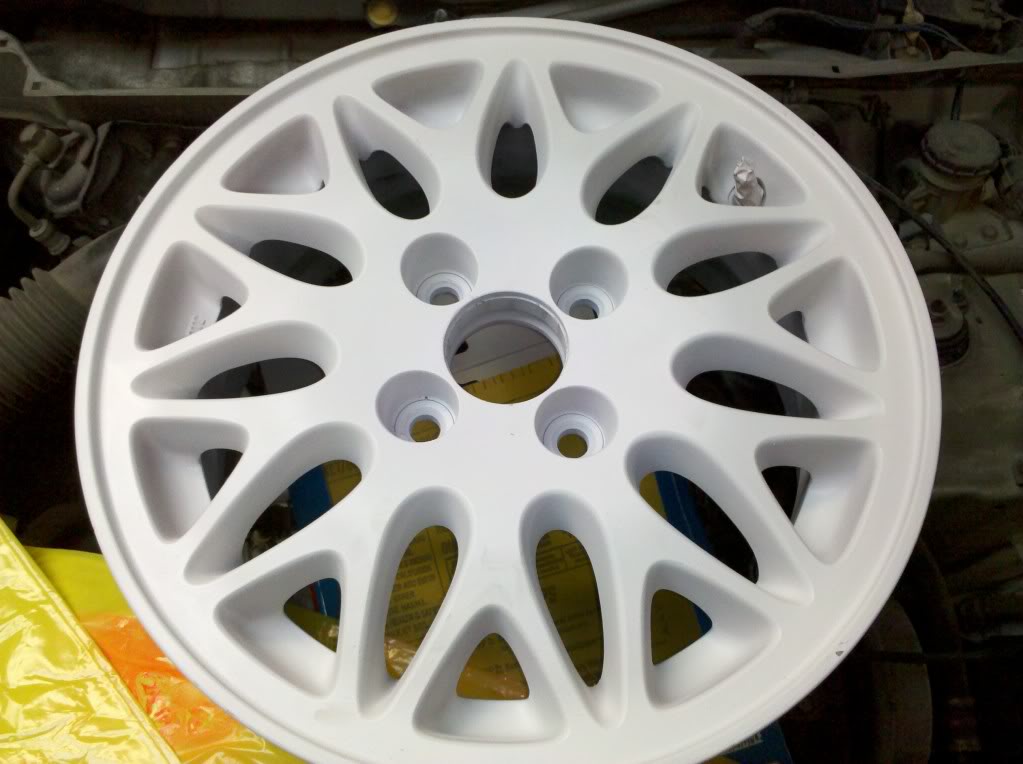

    picked up 4 of these from another local wagon guy
    Got one sand blasted and painted. I think it turned out pretty good, may use for snow wheels on the wagon or for another civic im building.... 4 different colors of paint removed!
    4 layers let me guess white, lime green, purple and black?

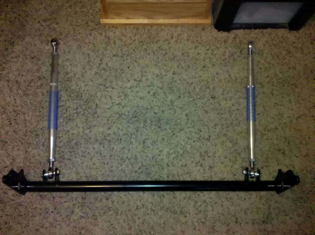

    Oh ya i got my traction bar today looks a lil chincy but for the price it will work.

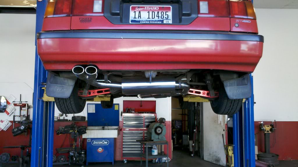

    Been a while since i've updated the build so here is the current status....

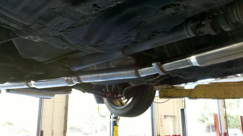

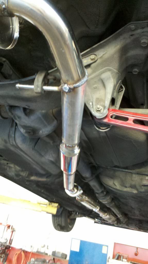

    Started with an E-bay EF hatch as i recall exhaust system. Figured it would get me the key parts and some extra bends that are not needed. Swapped out the single 4" tip for a dual tip and then added an extra resonator to quite it down a bit. Sounds real nice IMO :) Just purchased a wrecked EF EX sedan.... power windows, door locks, and maybe even mirrors to come in the near future hopefully :wink: Should be able to hopefully part out the rest of the car to cover my cost and walk away with all the upgrades i needed! Also scored a volvo front lip in the deal :)
    Here you can see where i modified the exhaust system to fit the RT wagon. You can also see where i addded the additional resonator.

    new exhaust looks great. Looking forward to seeing your progress with the power stuff. You gonna hook up the CC too? Youll have everything you need in that EX. Guess I need to make a plan with ya about the suspension in that car too.
