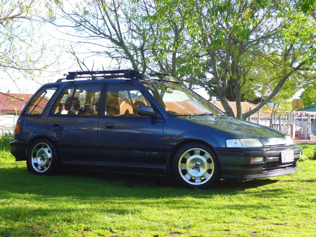

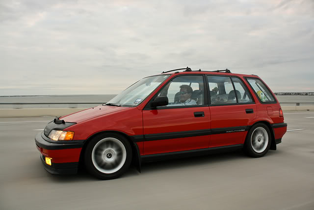

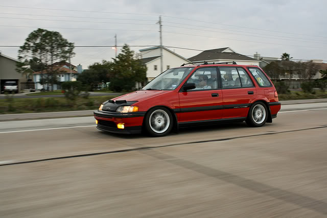

Brand:
Eibach Pro Street Coil-overs (utilize KW dampers with Eibach matched rate springs)
Click HERE for more info and pricing.
Cost:
MSRP of $972.00 - I paid $730.00 or so due to a friend working at Eibach.
Ride quality:
Absolutely excellent for daily driving on roads and highways. They are what I would call "soft" for a lowered set-up. They literally ride stock-like, but a little firmer. I would not attempt to auto-X or road race with them as there is more body roll than I'd like for those applications. These would be what I call literally the perfect daily driver suspension.
What they came off of:
These were purchased for a 90-91 Civic Sedan/Civic - no wagon models offered. The ride height adjustments are very limited though being that the wagon had very different shocks/springs in the rear when compared to the hatch/sedan. What you see for ride height is about the only way you can sit if you want it level. See my note towards the bottom about height settings.

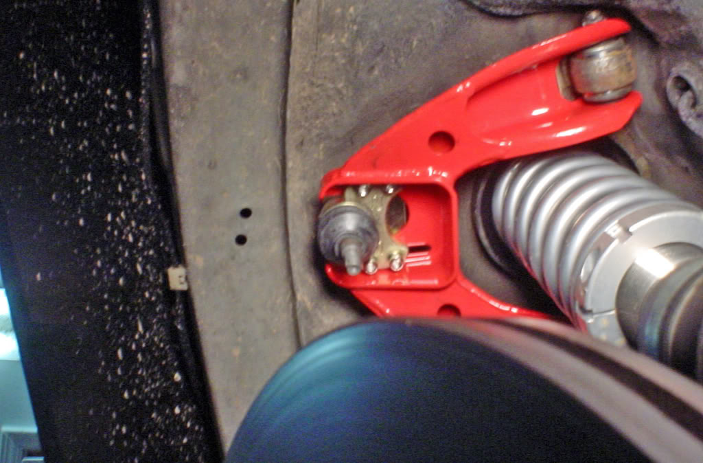

What additional parts are you using in conjunction with the setup:
I would not call the extras "necessary" but they are if you want to have street-able camber settings and factory spec rear toe at the same time.
Skunk2 front upper control arms for EF/DA allowed front camber to be a more tire-friendly -1.7 degrees instead of the -4.0 degrees it had before:
Shimmed the hell out of the upper control arm in rear to bring rear camber to -1.0 or so rather than the -4.5 it would have otherwise.
...and finally SPC rear toe links to allow the factory .08 degrees of rear toe to be adjusted. Once you slam the wagon, and fix the rear camber with shims the toe slot in the frame doesn't allow for enough rear toe adjustment. I replaced the fixed rear toe arm with an adjustable one for much more toe adjustment range.
Any additional thoughts on the setup:
Here is the biggest issue with the Eibach Pro Street S coil-overs on a Civic wagon:
YOU HAVE TO RUN THE FRONTS ALL THE WAY UP, AND THE REARS ALL THE WAY DOWN TO ACHIEVE THE EVEN RIDE HEIGHT YOU SEE IN THE FIRST PICTURE!!!
If you want your ride height like mine, which is pretty much a 195/50/15 tire sitting just off the fender arches then this suspension is perfect. It rides great, sits nice and low, and is absolutely durable.
I've had this set-up for over 2 years now and they still ride like new. The dampers are KW variant, which are top quality, and the springs are Eibach which again are top quality. There's no reason why these shouldn't ride great for for years and years longer.
I'll be back later to post a shock/spring combo I installed on my mom's former 1990 Civic wagon. It's much more budget-oriented and was also great for daily driving.

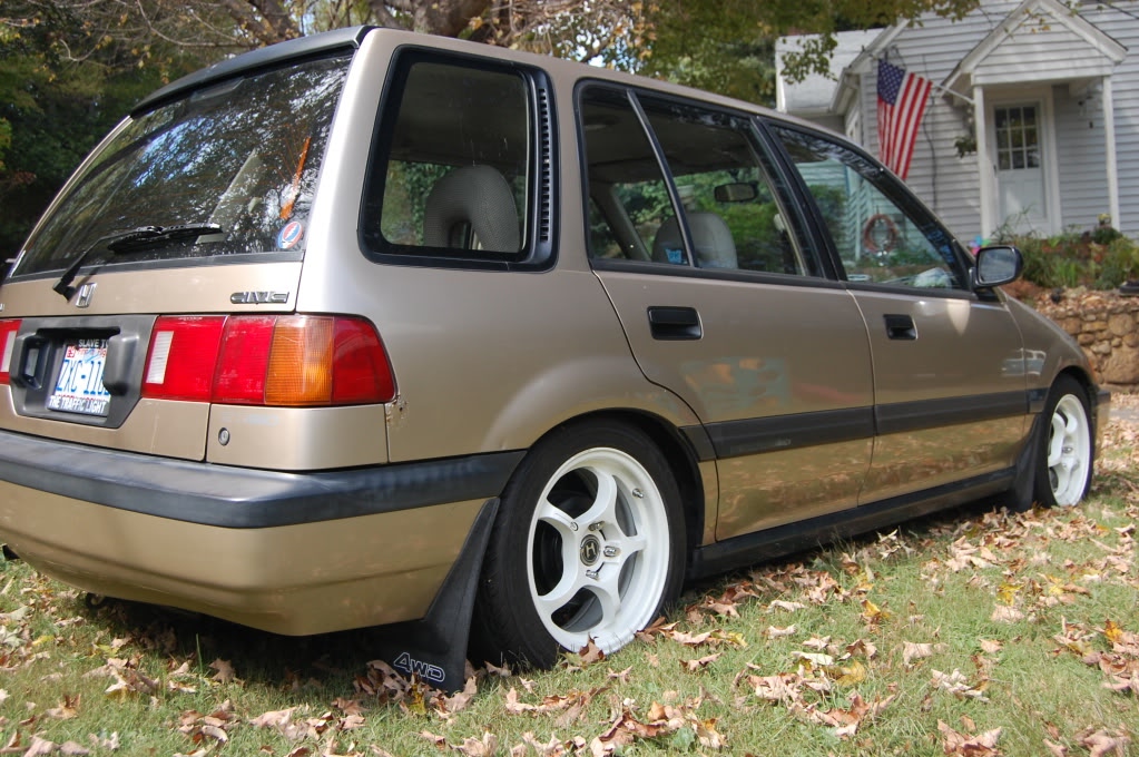

Cost: GCs are $400, Konis were about $400 as well for the set...I forget though as it has been 10 years. Spring rated 350 front, 250 rear.
Ride quality: decent, firmer than stock, but I have poly bushings too. It is a little under dampened, should have used Koni Yellows
What they came off of: all parts were for a 91 Civic
What additional parts are you using in conjunction with the setup: Poly bushings all around, that's it.
Any additional thoughts on the setup: I would have Koni Yellows and slightly firmer springs in the front, significantly firmer in the rear, and with a rear sway bar.

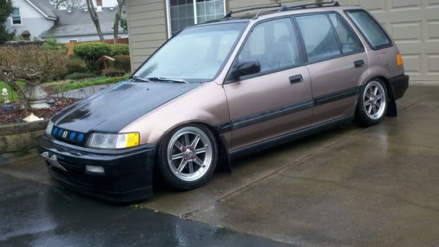

here's my stance

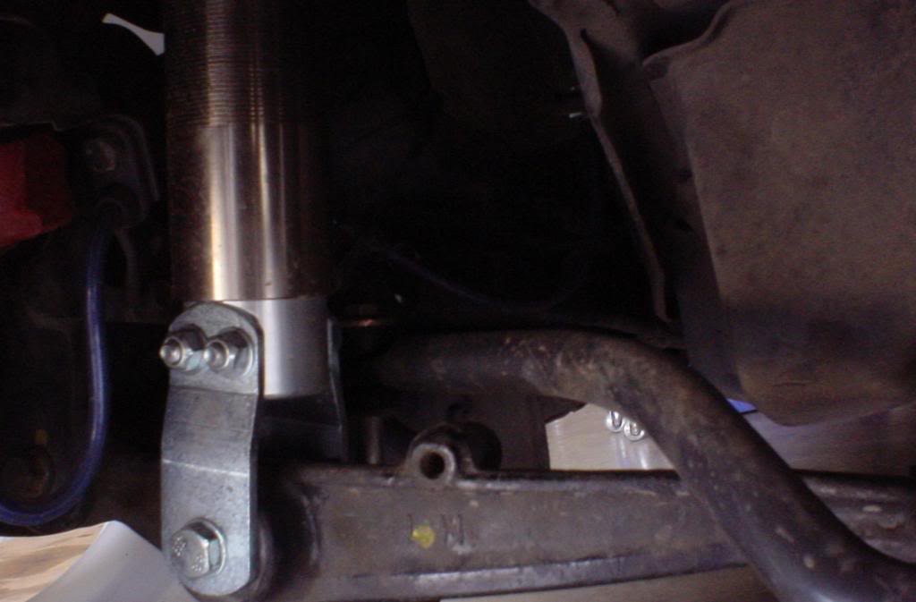

Brand: Koni Shocks, Skunk2 Coilover sleeves, keeper springs, custom extended tophats
Ride quality: Awesome, nice and smooth, absorbs the bumps and loads up nicely in the corners
What they came off of: Civic Hatch
What additional parts are you using in conjunction with the setup: Custom Tophats, Adjustable rear Camber arms, front and rear strut brace.

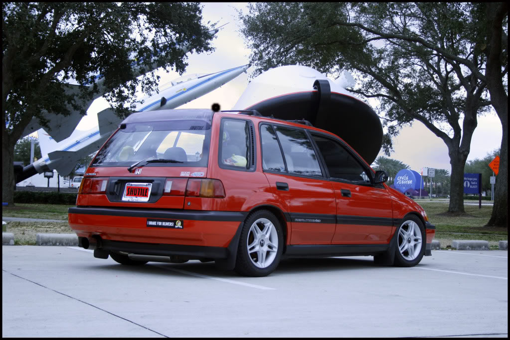

Brand:k sport, skunk 2 pro s,
Cost: ksport:$700, skunk2 $600,
Ride quality: ksports: rode extremely well, the wagon deffinitly felt like a go kart. The only problem with them is I just couldn't get them to go low enough. So I threw them on my track car.
Skunk 2: the ride is pretty bouncy they allowed me to go about in inch lower but the bounce just isn't worth it. Im pretty much ridding on bumpstops they would be decent if rode a bit higher. I still don't consider them to be low enough for my taste.
What they came off of: ksports: ef, skunk2: eg
What additional parts are you using in conjunction with the setup: skunk 2: eg lca's And forks.
Any additional thoughts on the setup: k sports have been my favorite set up on any car iv owned I'm extremely happy with them can't wait to take them on the track. None of these have gone low enough for me though, i had a set of function form that went pretty low on my integra looking to pick up either those or a set of black works to try next.

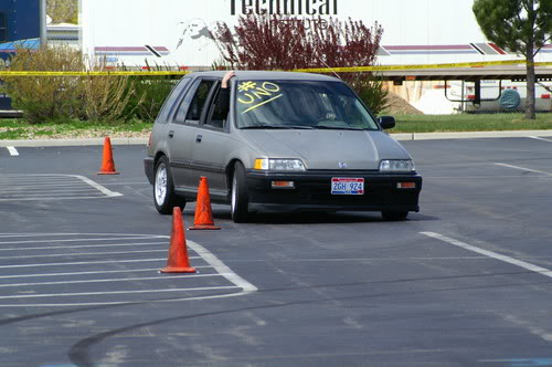

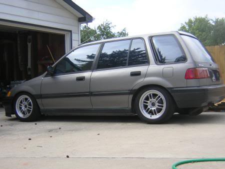

Tein basics. I paid about $800 back then.
I did autocross on these a few times and they were a little soft for that, but I thought they were great for daily driving. Very comfortable.
I did always wish they went a little lower. These pics are with the coils all the way down.
Love this setup. Has enough stiffness, but also completely adjustable. It's currently in "winter mode" but easily swapped out for 15" rota beat/federal 595's and lower it a bit. stiffen up the struts and good to go.
Will be adding a Suspension techniques rear sway as soon as i find all the mounting harware (have the endlinks, but need the triangles and such (pm me if ya have them for sale!)
Sitting on enkei 92's 15x8 +25 with Yokohama 195/45/15.
Rides pretty nice and on stock wheels freaking way nice.
Doesn't bottom out how it used to. Worth it even though it was budget set up.
fronts 2 1/4

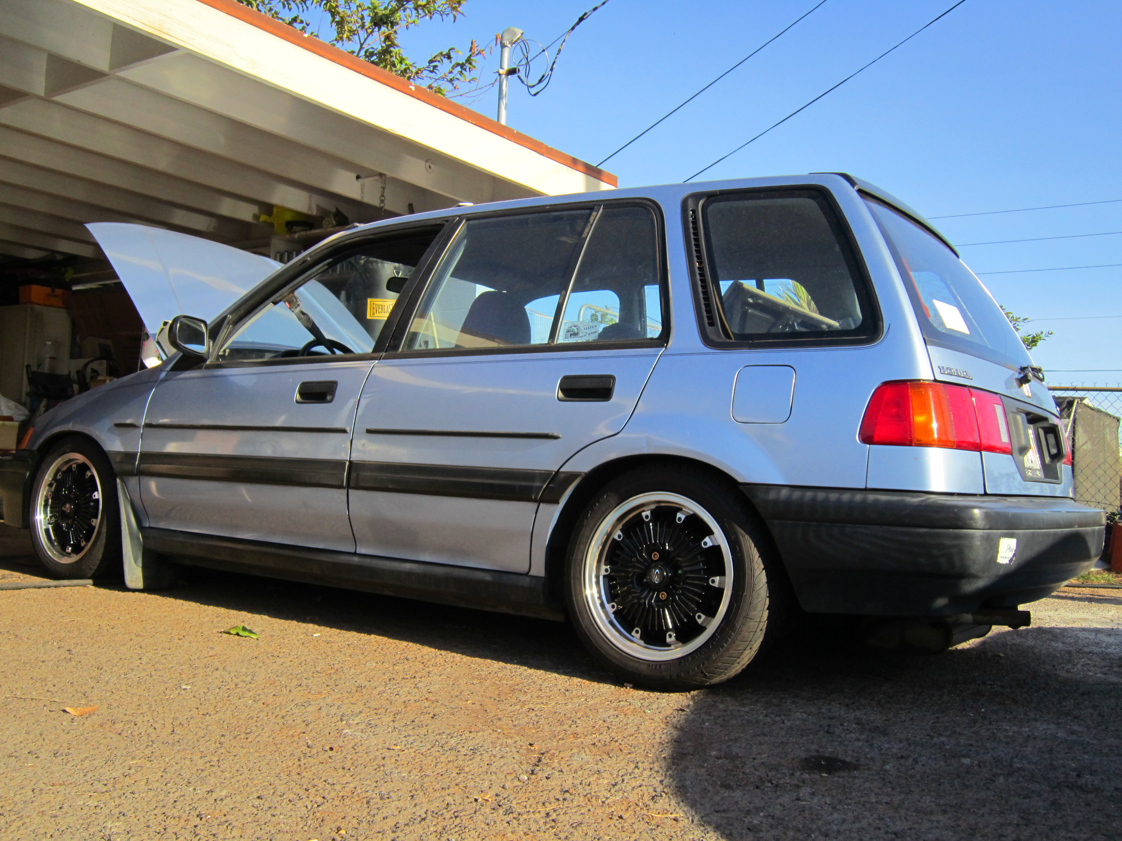

Cost: Roughly $600 (stock)
Ride quality: Depends on the road. Terrible in the city, good on the freeway. My bastard setup was to get low, and it does. (could actually go lower)
What they came off of: F&F claims Civic "EF"
What additional parts are you using in conjunction with the setup: Front, stock. Rear, Hardrace toe and camber kit. Skunk LCA
Any additional thoughts on the setup: I daily drive this car in downtown Portland, its not a fun ride with our roads.
Almost tucking rim, 15"
Cost: $700-900
Ride quality: Bound/rebound valving feels smooth, i'm on max setting. The "only problem/issue" i'm experiencing with my current set-up is the rear sping rate needs to be beefed up(higher rate) and the front spring rate feels good but i would like to feel how a little higher spring rate would handle. I'm guaging my experience by comparing to my previous ride 2000 Honda S2000 with stock shocks on tanabe GF210's springs(spring rate higher then stock, GF=grip force). Yes i know an S2000 is in a different class but im talking bout suspension feel only.
What they came off of: Honda Civic/CRX 1989-1991
What year and model being installed on: 1990 Honda Civic Wagon RT4wd
What additional parts are you using in conjunction with the setup (lca, adjustable aftermarket parts, top hats, anything else):
-Ksport CKHD01-3 Honda Civic/CRX 1988-1991 Rear Camber Kit.
-Ksport LCHD01 Honda Civic/CRX 1989-1991 Lower Control Arms.
-Skunk2 51-6-05-5660 Pro Series Front Camber Kits.
-Front sway bar came with the car but prob came from a 89-91 civic/crx aftermarket company.
-Front adjustable tower strut brace came with the car but prob came from a 89-91 civic/crx aftermarket company.
-no name rear adjustable c-pillar bar.
-Megan rear adjustable tower strut brace, Part Number: MR-SB-HC88RU.
-Suspension Techniques STQ-51140 88-91 civic/crx rear sway bar.
- SPC 69250 toe adjustment kit
-Energy Suspension master kit, Part Number: 16.18102.
-VIP performance rear differential mod.
Measurements from ground to bottom of door handle F & R: (F)25 3/4in and (R) 26 1/2in. Any lower front setting header will meet asphalt while driving at times with this setup.
Tire size: 165/50/15 Federal Formoza FD1 with measurements above you will tuck in the front and have a 2 finger gap in the rear.
Final thoughts: Since i'm using my previous ride as a comparison with all the suspension parts noted above "in my opinion" the ride quality regarding body roll, braking, acceleration and sprited driving whether it be in the mountains/city/freeway my experience is pretty close to how my S felt for a wagon but i haven't driven the S for over a year which has been sold so you decipher that how ever you want. Installed all items at once except rear tower strut and c-piller bar. I've noticed even less body roll with the rear tower strut and c-piller bar combo installed. Yes I would purchase >> Ksport CHD010-KP Kontrol Pro Damper System again but I would also order higher rear spring rate replacement springs just in case you feel like (R)5/280kg/lbs is a little to soft for you. Hope this helps for all the new civic wagon drivers...
