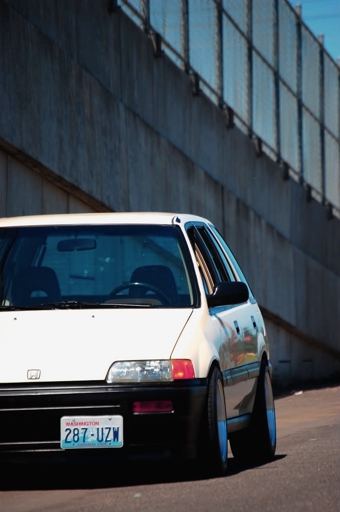

I picked up a Cream and brown 1988 5 speed wagovan and thought i would share some pics.
Spent 5 hours cleaning the outside tonight and plan on getting the old grandma smell out of the interior tomorrow, heh.
I will be the second registered owner of this car, I bought it from a 87 year old woman.... :shock:
without further ado, here are some pics of when I just got it home, and some progress.

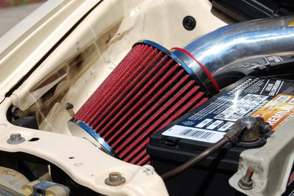

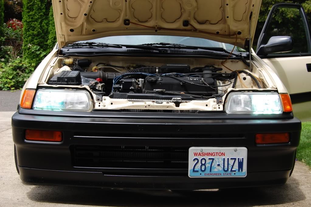

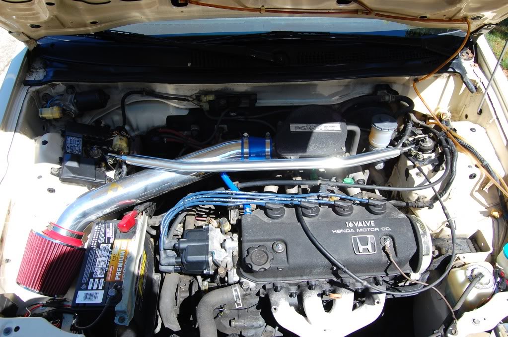

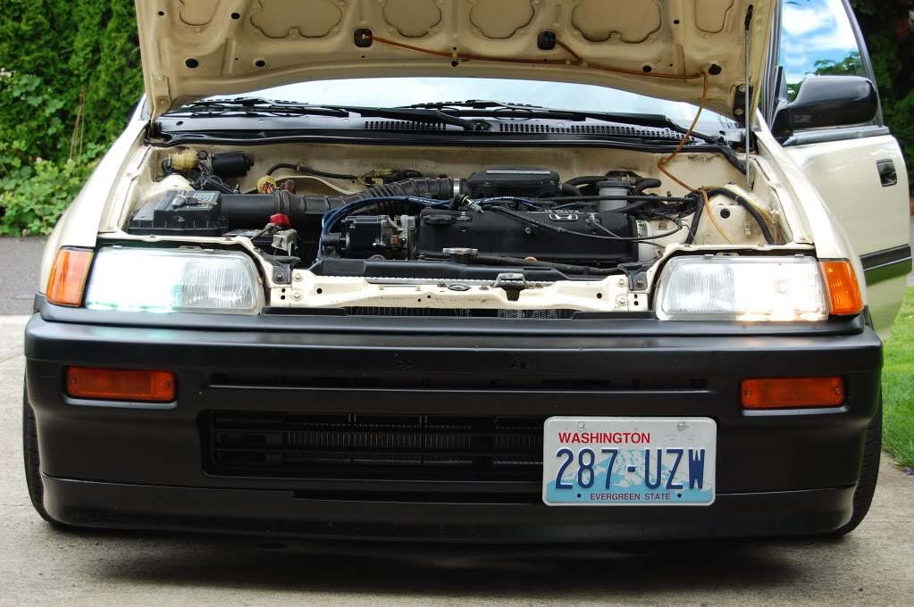

Before engine cleanup:
After Cleaning:

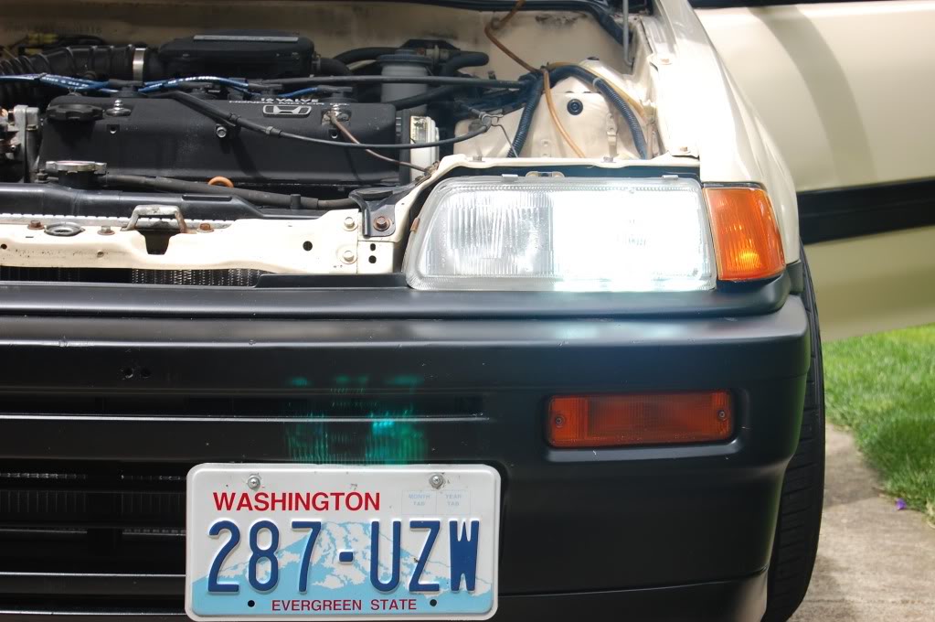

    Got home today and found this on my door step!
    Sand those babies up with some 600 grit wet sand paper so the paint sticks...
    Apply first coat...Looks yellow now, but it will darken over time....Might look good to keep yellow if you have yellow brights?
    Third coat, just right...
    After baking them in the oven at 200 degrees for 15 minutes, I noticed a little orange peel...
    So I wet sanded with this...
    Result...
    Then used the trusty orbital...
    With Some of this...
    Looks a little better...(Don't mind the crack)
    Annnnnd without further a due.....BAM
    Side views

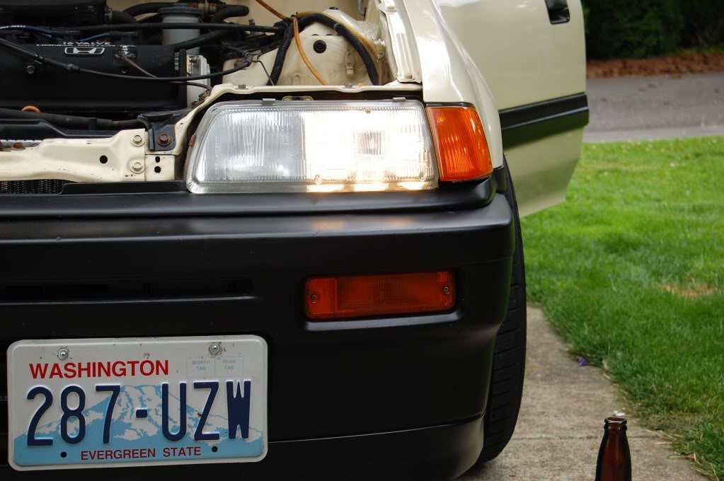

    And a full frontal, oh I also sprayed the bumper lights!
    And a teaser for tomorrow or this weekend, what do I need these for?...

    holy crap dude that looks freaking amazing!!! where did you order the paint from?...clean car man! i did the same thing you did..had some tool box liner left over so i cut it up and put it in there
    www.civicwagon.com
    cant wait to see some updates of your car
    very well done on the corner lights...

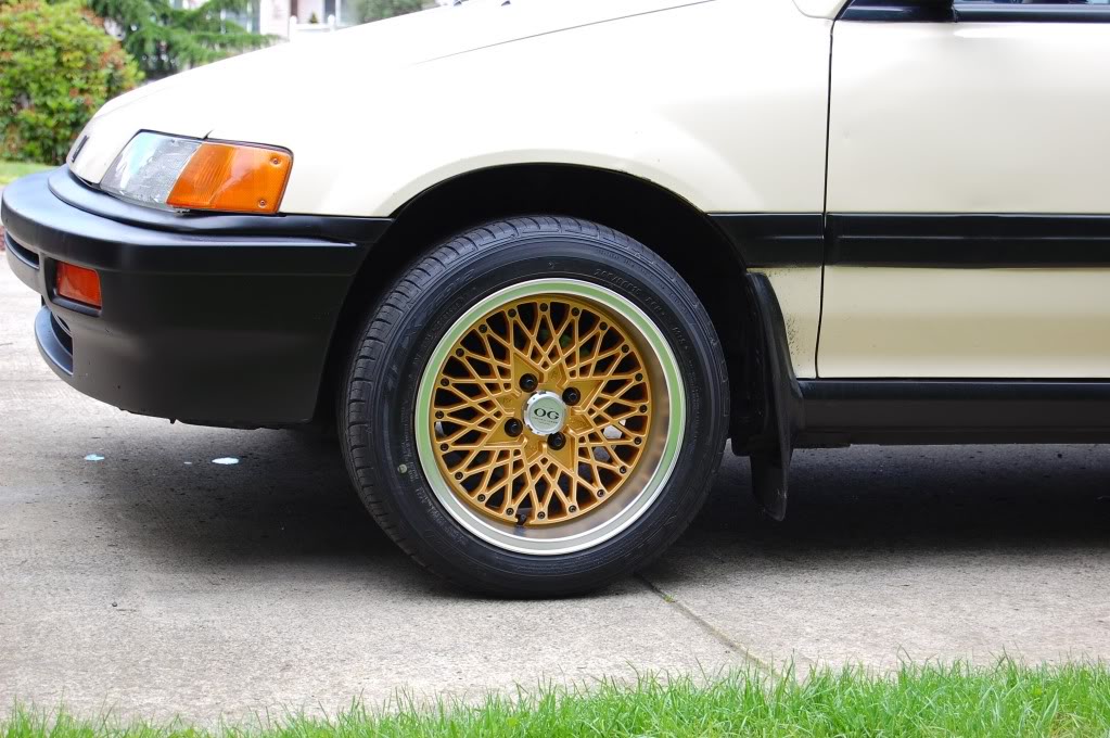

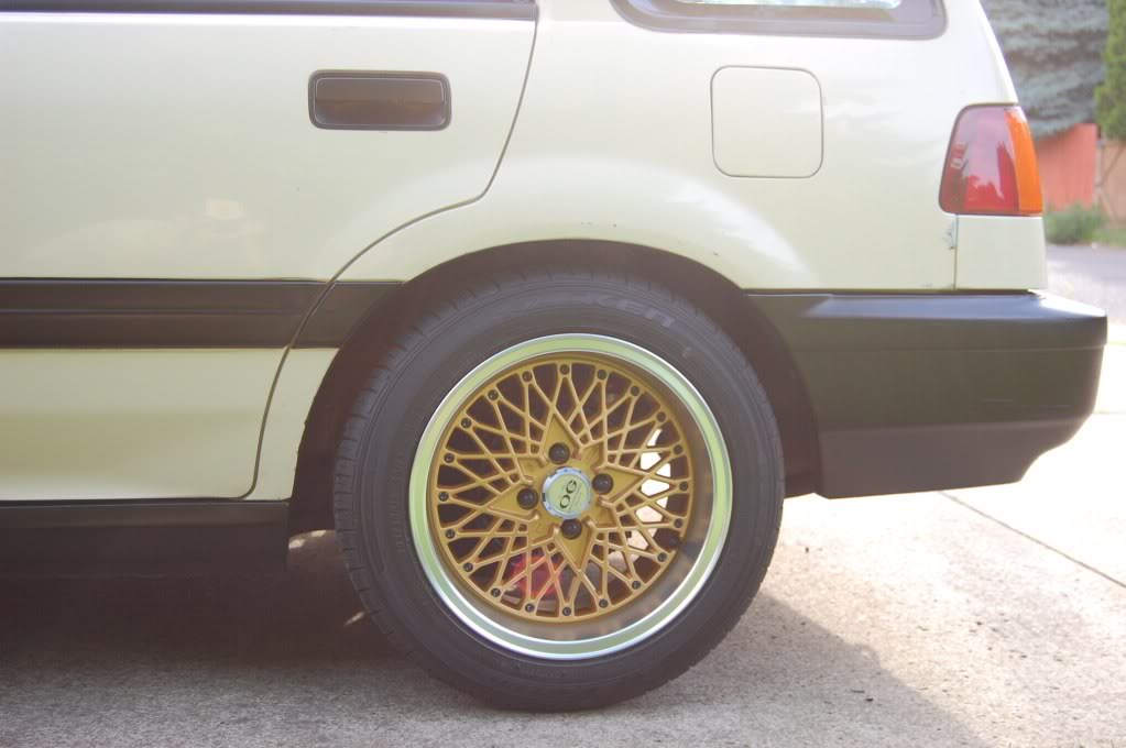

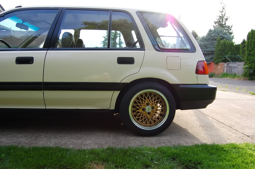

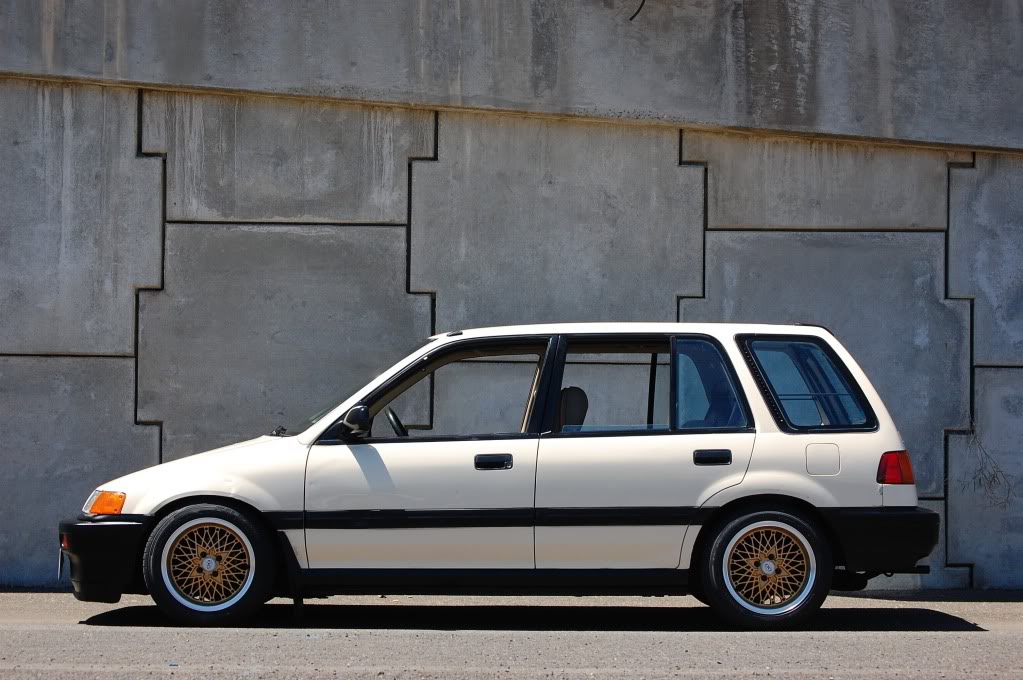

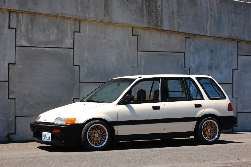

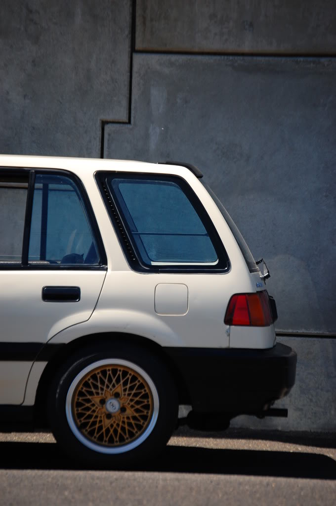

    And along the lines of keeping the car back in the 80's/90's, I just installed some new wheels.
    ....Still waiting on my parts guy to call me about my springs, definitely need them now!

    looks nice!! cream turd?! lol, i really like the color. and your new wheels :mrgreen: can't wait to see more progress!

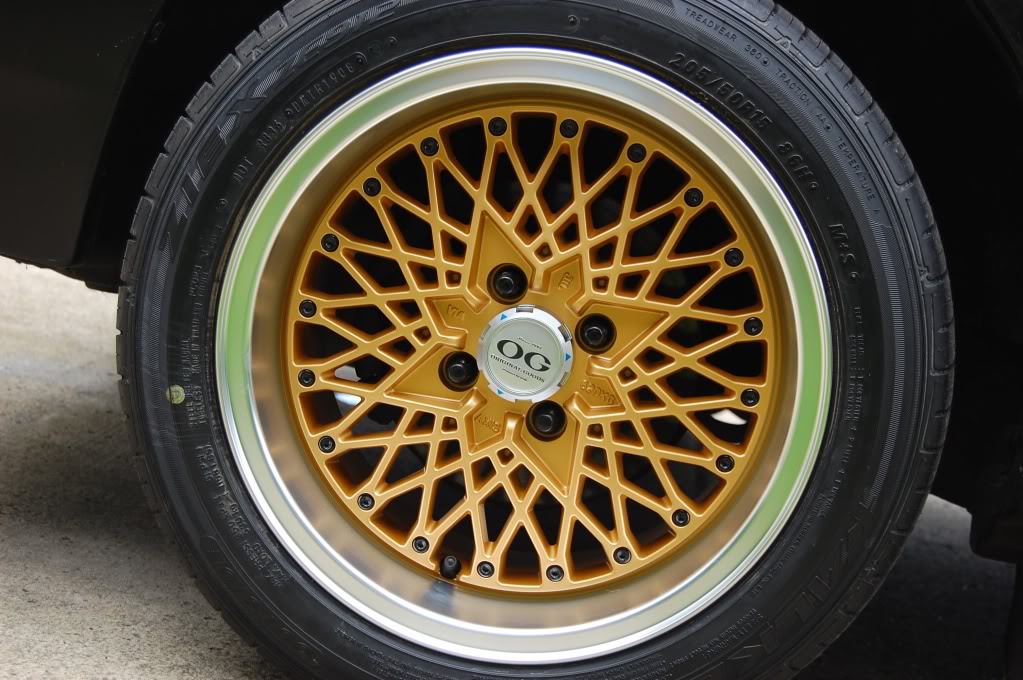

    whats the offset and width of those wheels?
  • MustaucheRiderMustaucheRider New Wagonist
    15x8 et 25, around 17 lbs each, and put some 205/50/15 falkens on it from work.

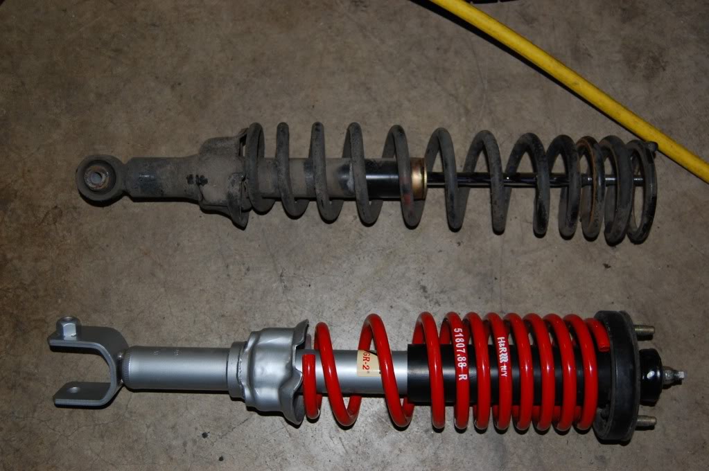

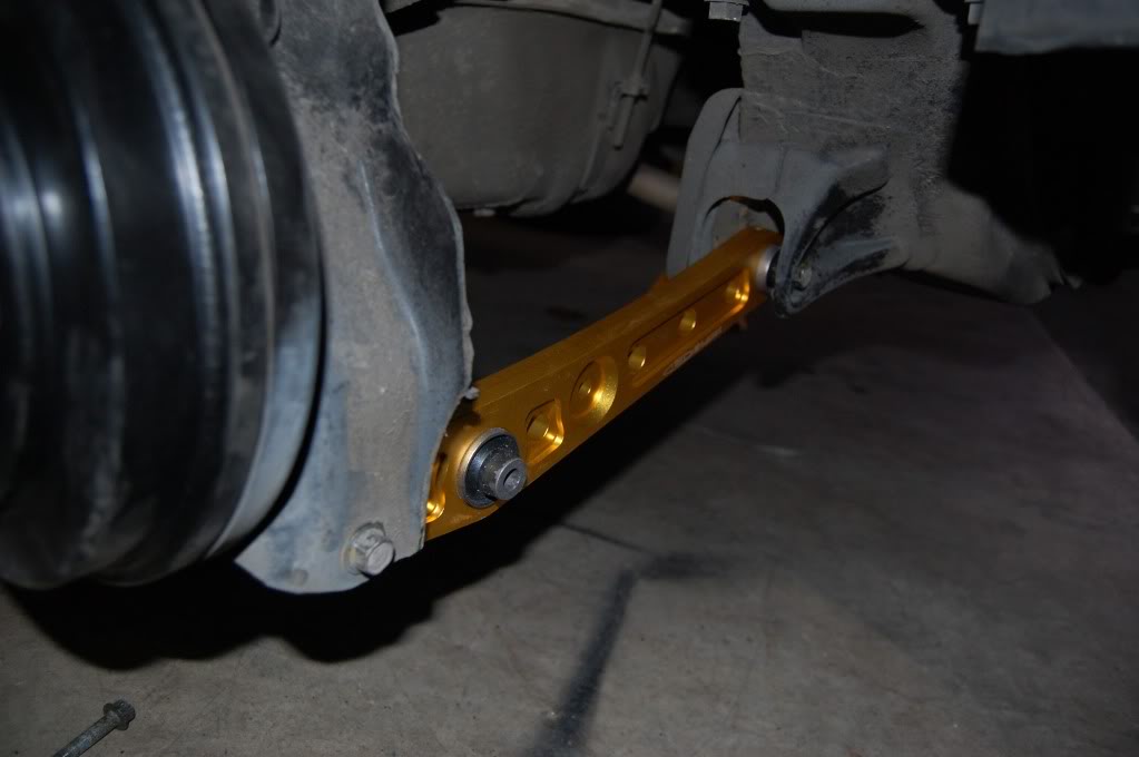

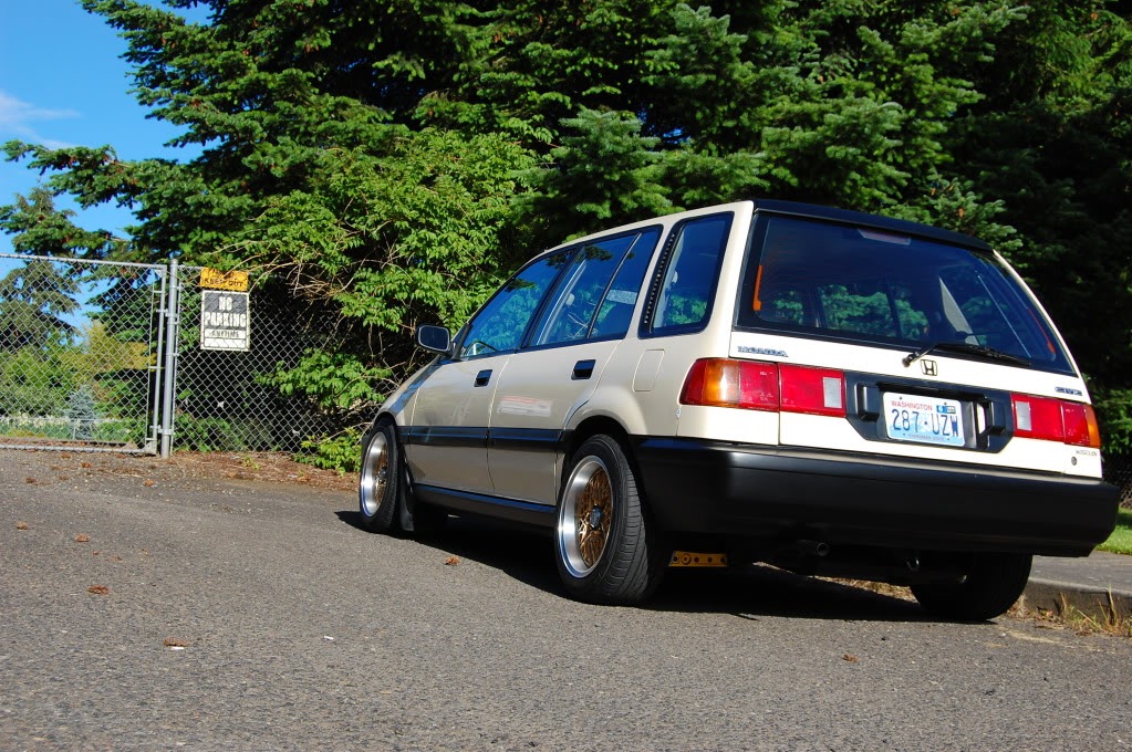

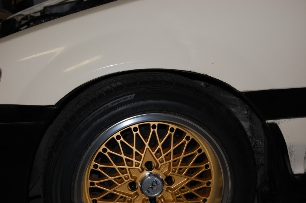

    FINALLY got my springs in, I got them at 9:00 pm....took until 12:00 am to put them on, had to stop using air tools at 10:00 :|
    H&R Race Springs with KYB GR-2's

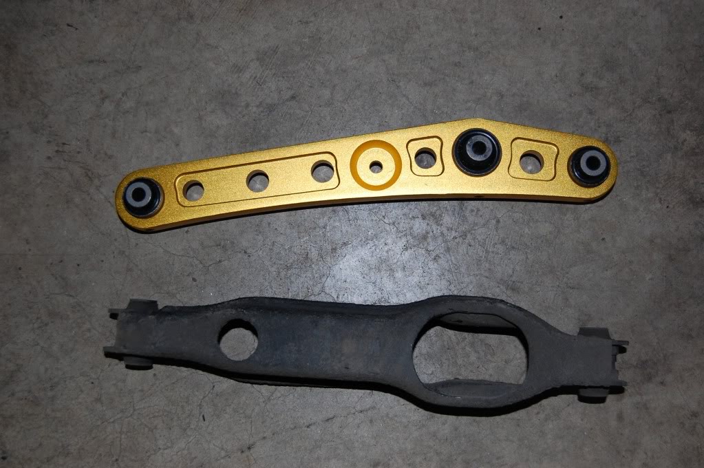

    BLOX Rear LCA's compared to Stock:
    Installed:
    And a teaser pic until the sun comes backout, plus I'm too tired to take any more :?

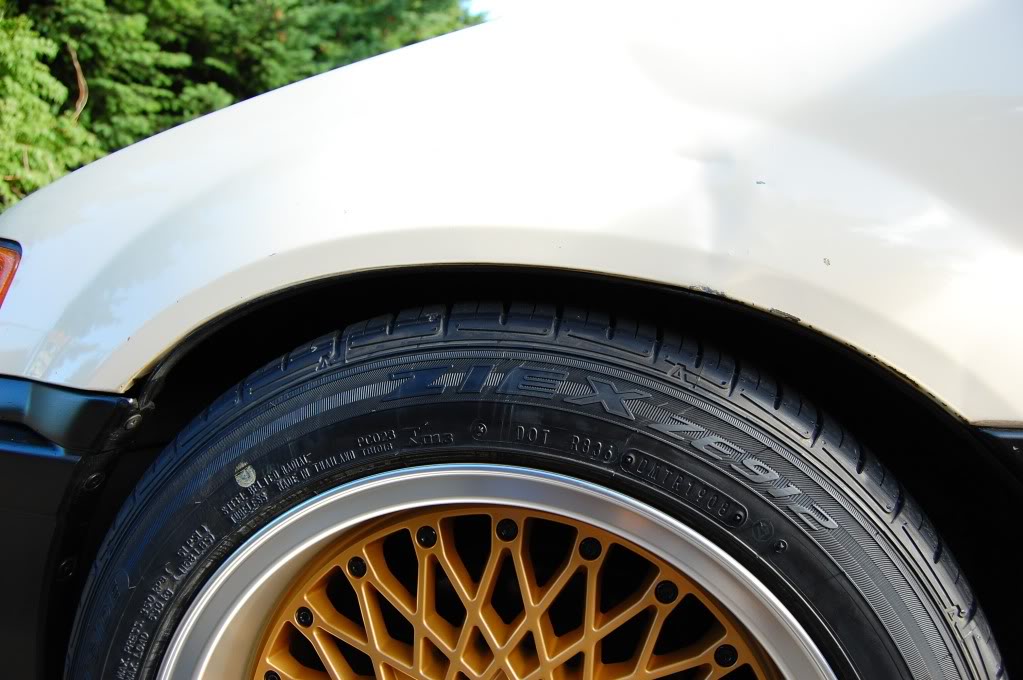

    This was before driving around the block, so it hadn't settled yet. Seems to rub a tiny bit up front, might have to fix that dent and roll those fenders!...Might have to cut a coil off the rear also, little higher.
  • looks good dude! blowdryer+baseball bat and a jack should take care of your fenders

  • very nice find! looks like its coming along great 8) nice amber corner solution, i didn't think about the tamiya paint, bet it cost way less than the jdm lens painter i bought lol.. anyway keep up the good work!

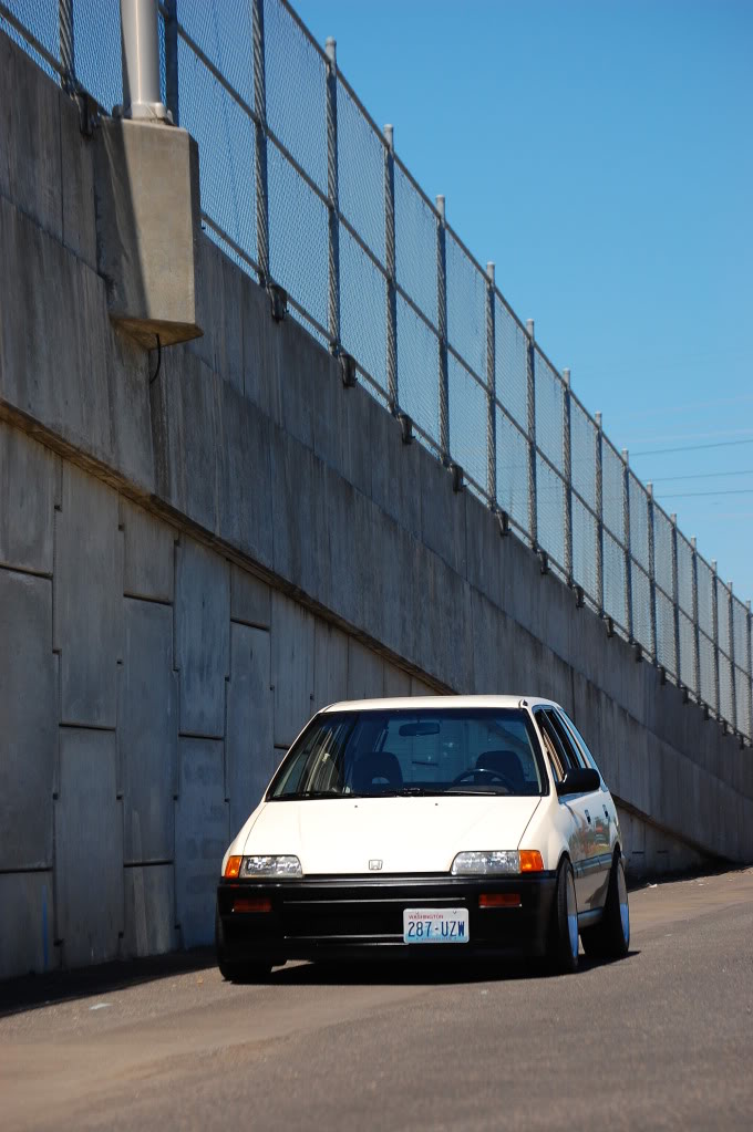

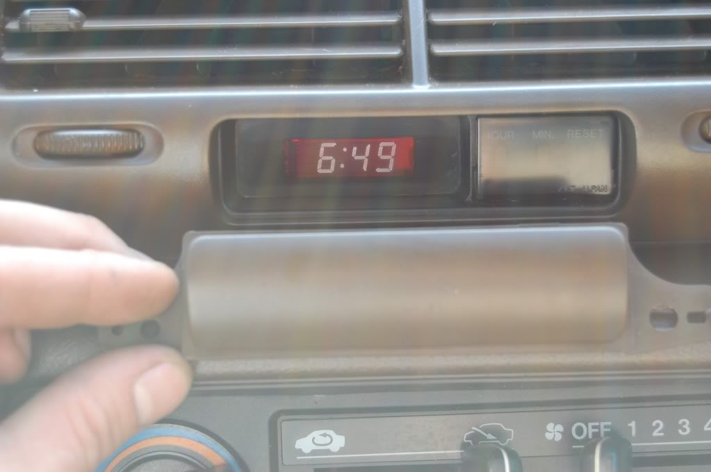

    Went to the junkyard today and found a couple goodies...
    Clock for my dash:

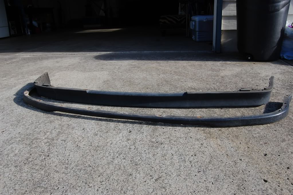

    Volvo front lip and accord front for the rear of my car:

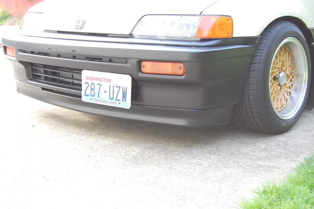

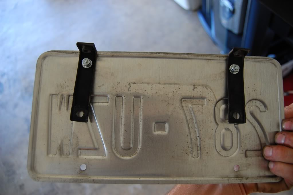

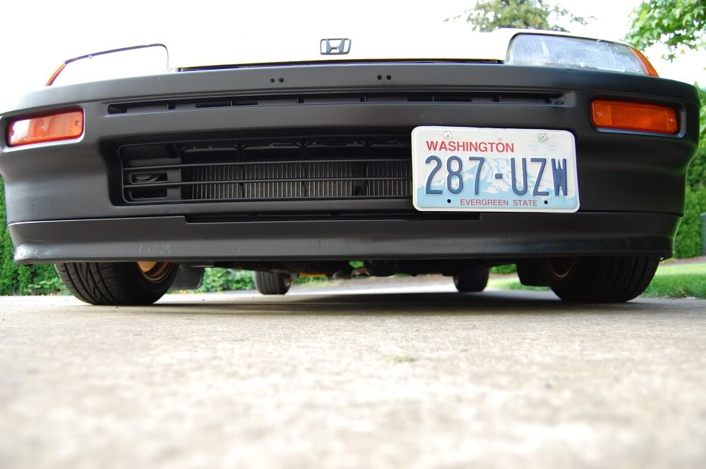

    Also, I am sick of being paranoid around cops because of not having a front plate, so I used the original mounting brackets, drilled a hole in them and installed bolt and nuts:
    And put it on the driver's side of the bumper:

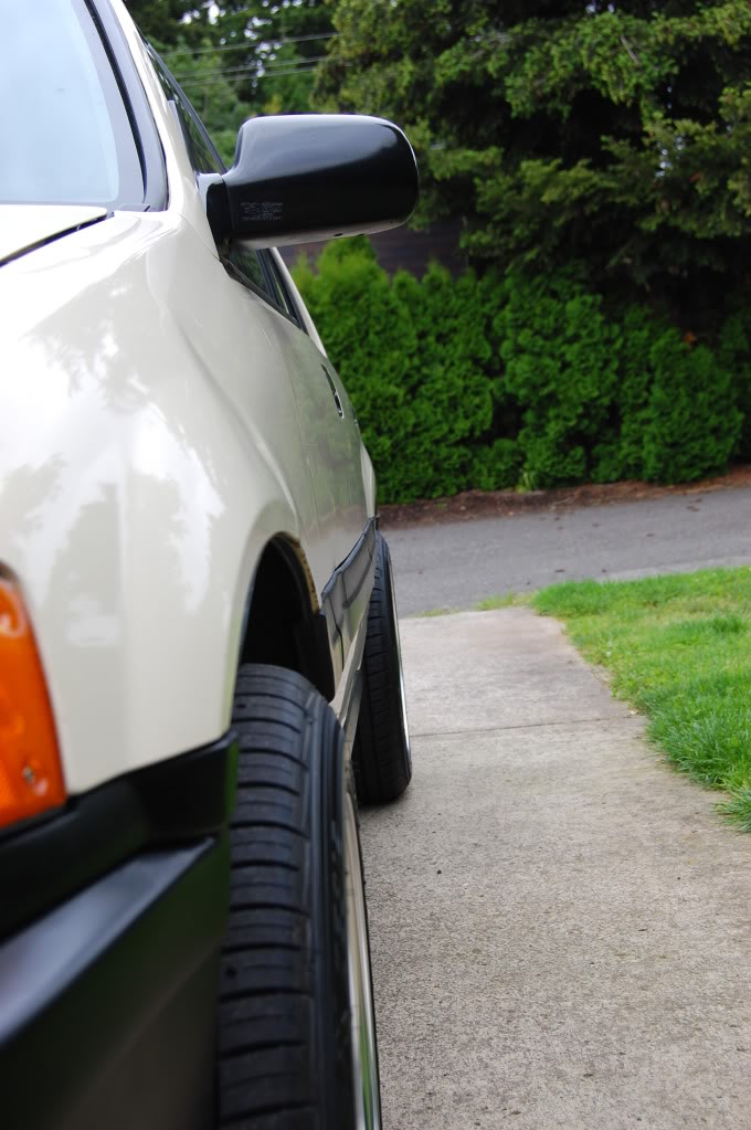

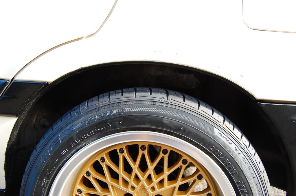

    And now for some sunny pics of my suspension:
    Front: One finger fits
    Rear: Three fingers fit, probably going to cut a coil off
    And some random shots because I was bored:
    And my BLOX rear LCA's, so sexy!
    Need to replace my radiator, put those lips on and paint them this week, probably in the next three days, I'll keep you guys posted!
