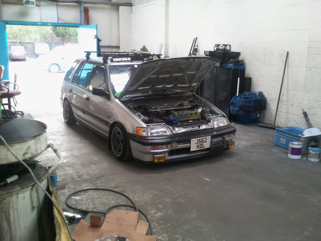

I've spent all day at my mates garage today and will be going back tomorrow. Please excuse crappy phone pics

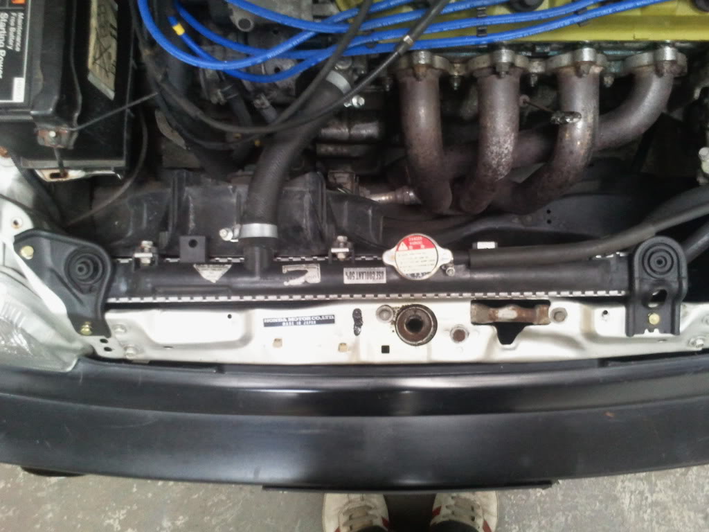

First thing I did was wire brush and repaint the rusty radiator brackets
Then the plan was to do my CV joints and make up some newer longer custom top hats for the rear suspension and then put the old i've taken off the back on the front cause they just about fit under the bonnet and are longer than the ones I made for the front originally.

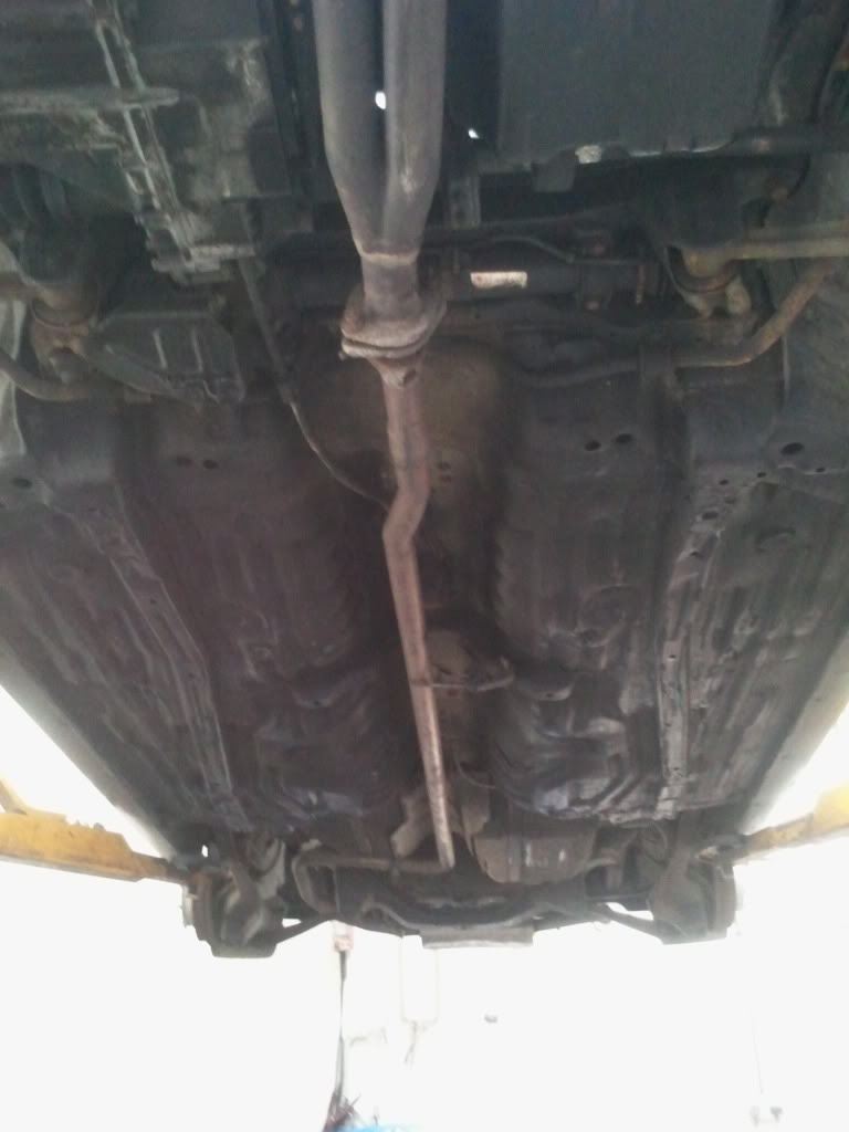

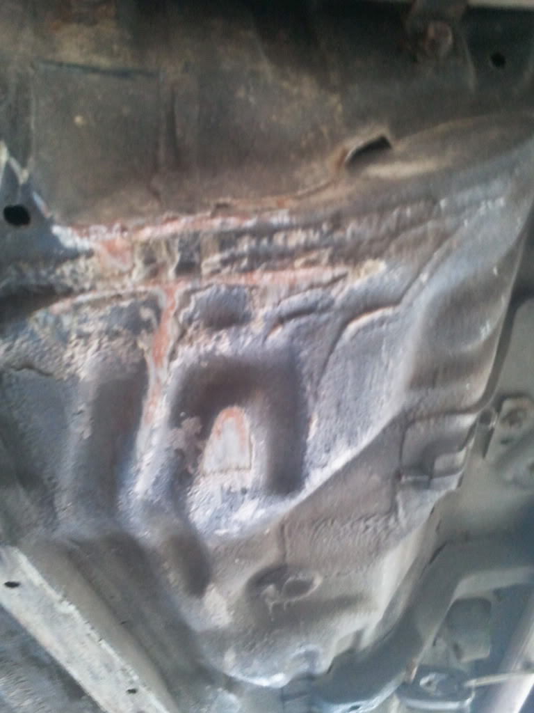

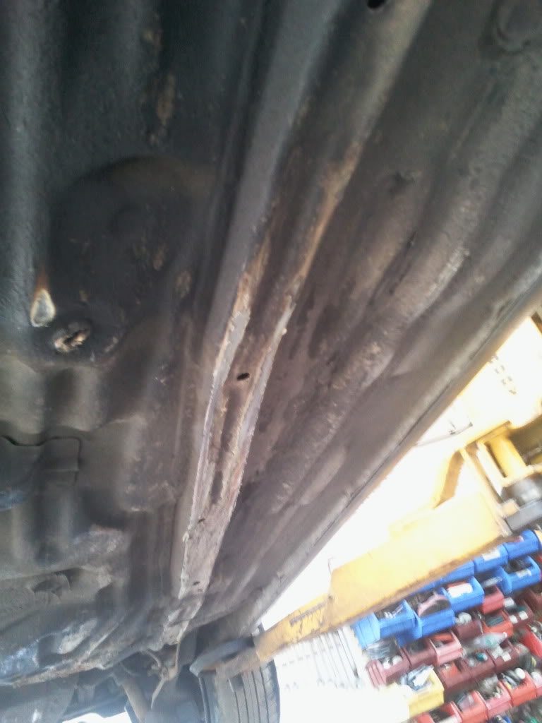

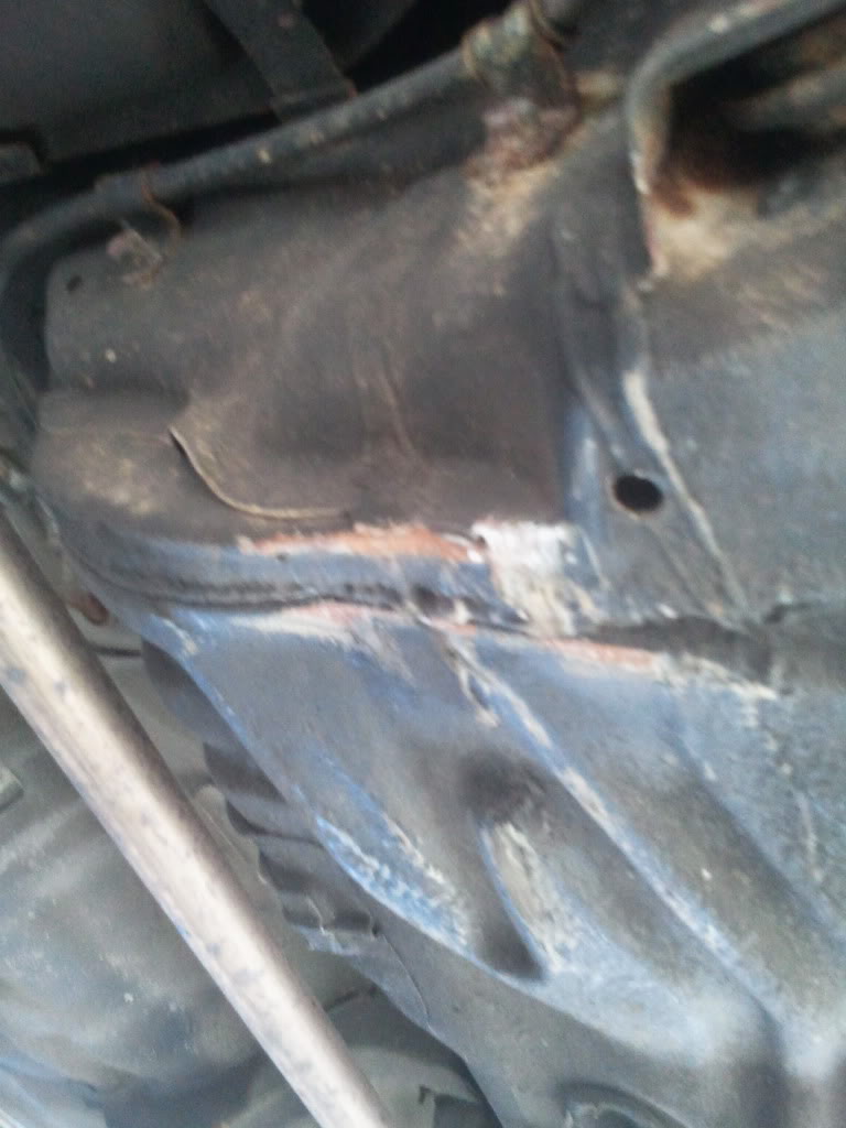

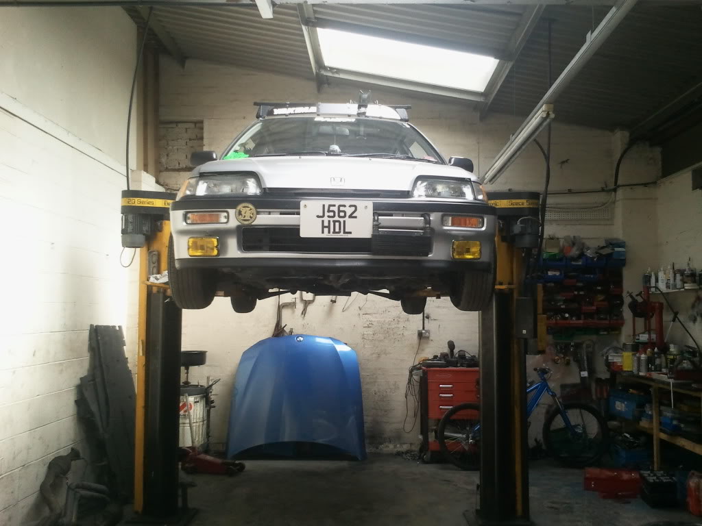

But once I got the car in the air I was greeted with the price of being so low.......
So a quick rub down and paint made things look a little better!

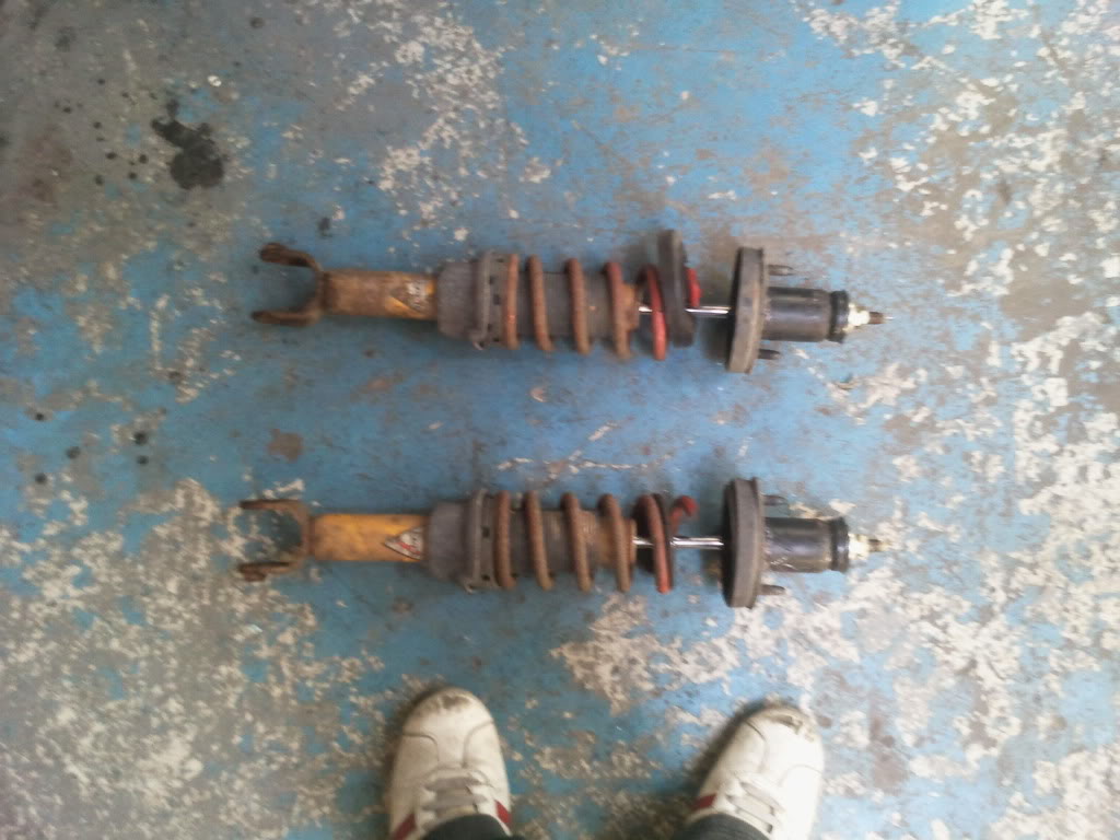

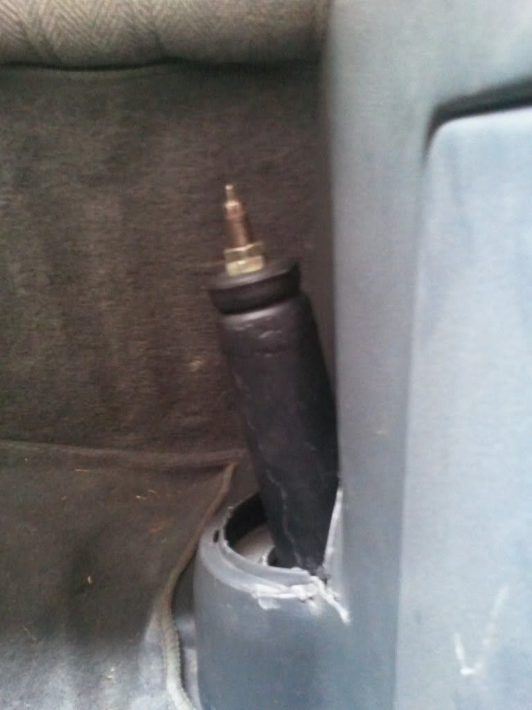

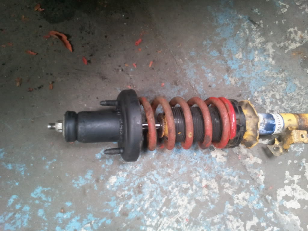

these are the backs when I took them off. As you can see the harsh ride and winter months have really taken is tole on them. I will be needing new springs so I will order them tonight.

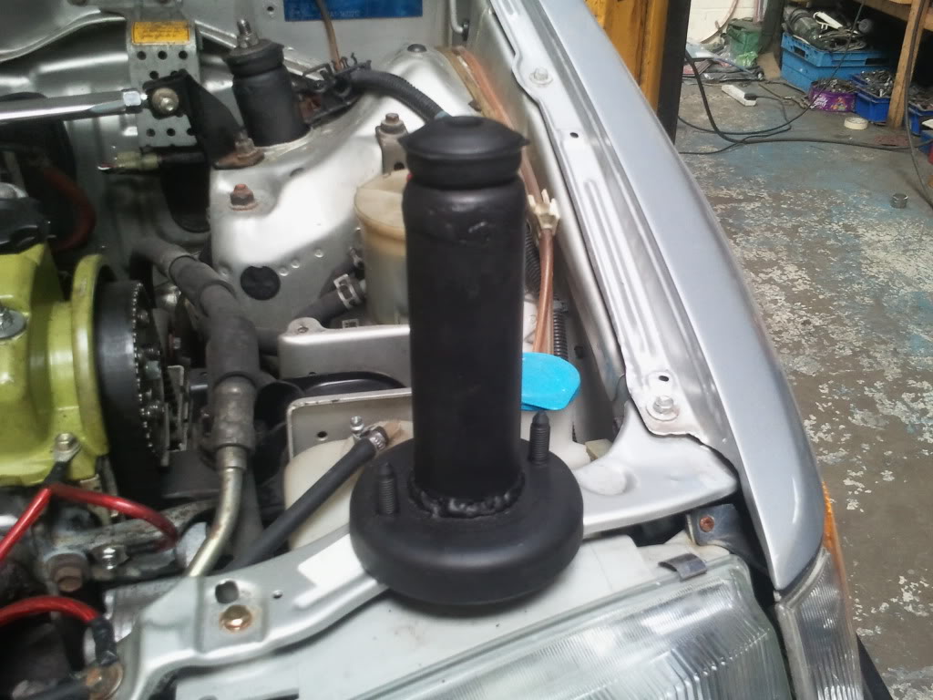

So after fitting the longer rear top hats to the front shocks I needed some even bigger ones to replace them
Monster top hats!......

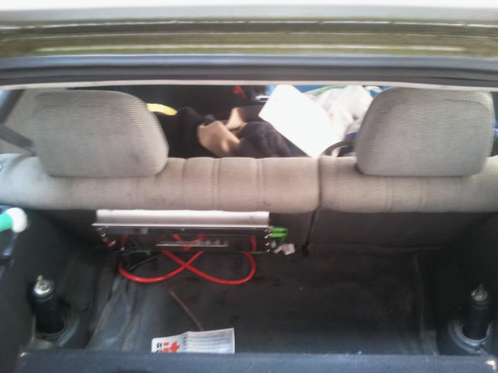

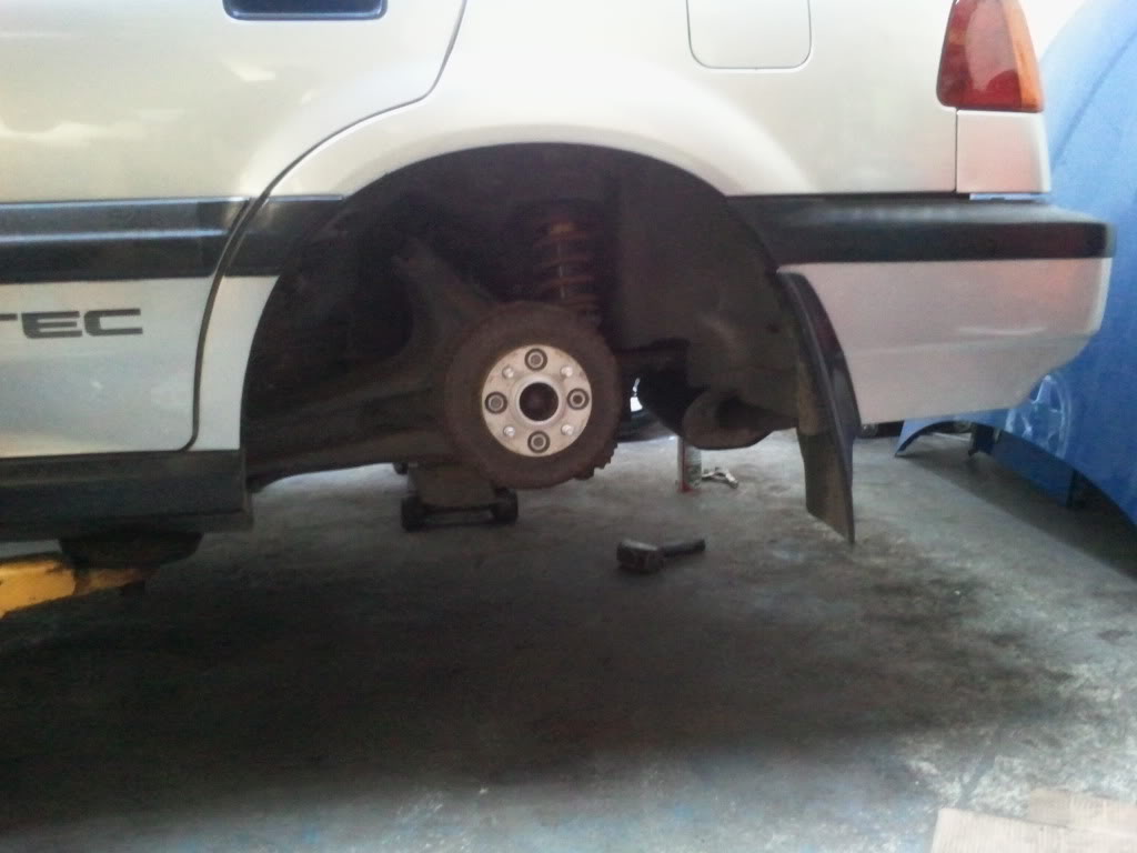

The shock is now so high that the rear hub now sits like this even when the car is in the air

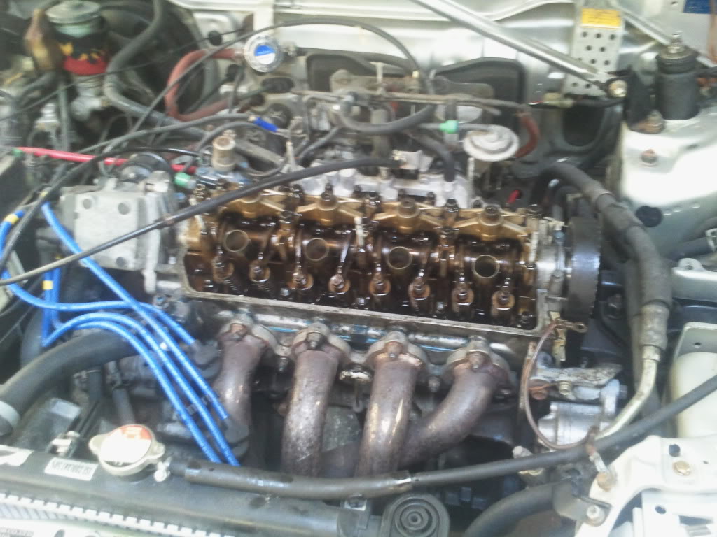

I've had a slight leak where the head meets the block for a while now so I ripped the rocker cover off and gave the ARP head bolts a quick tighten. one had worked itself a little loose.

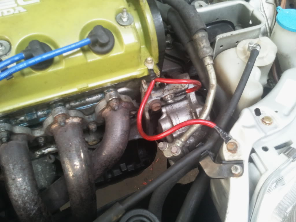

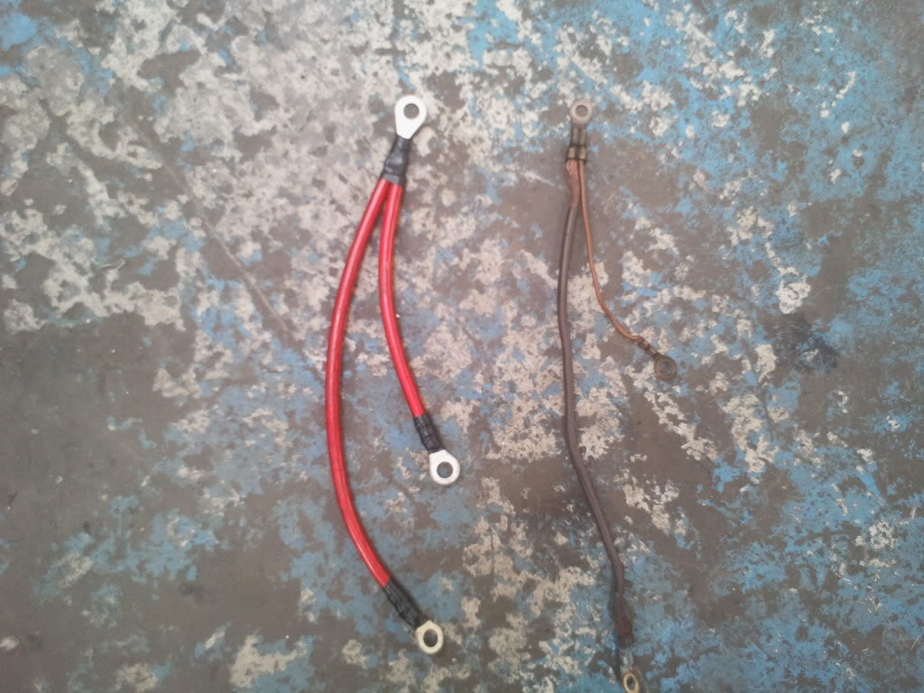

When refitting the earth cable I noticed it looked very old so I made a new one.

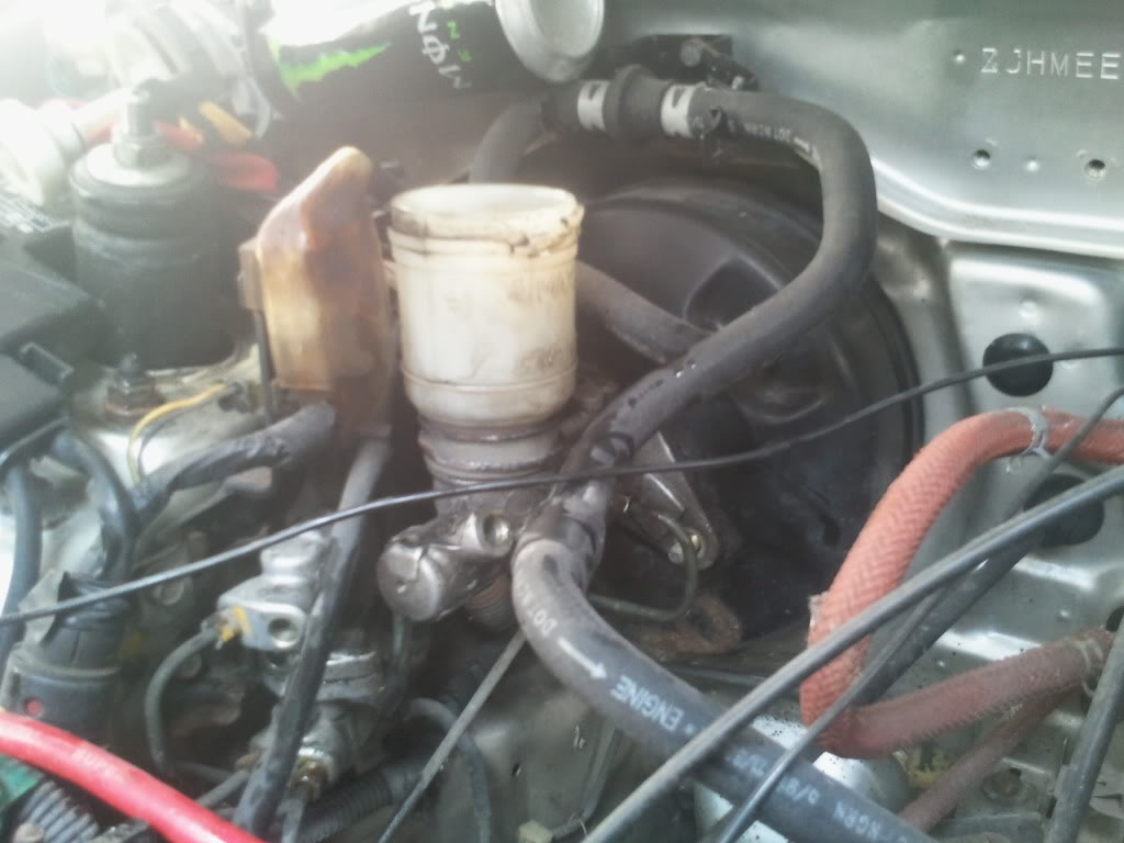

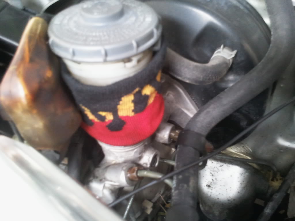

Another long term fault I've had is brake pedal creap. I brought a master cylinder off my buddy's EK a while ago but never got round to fitting it so that went straight on.

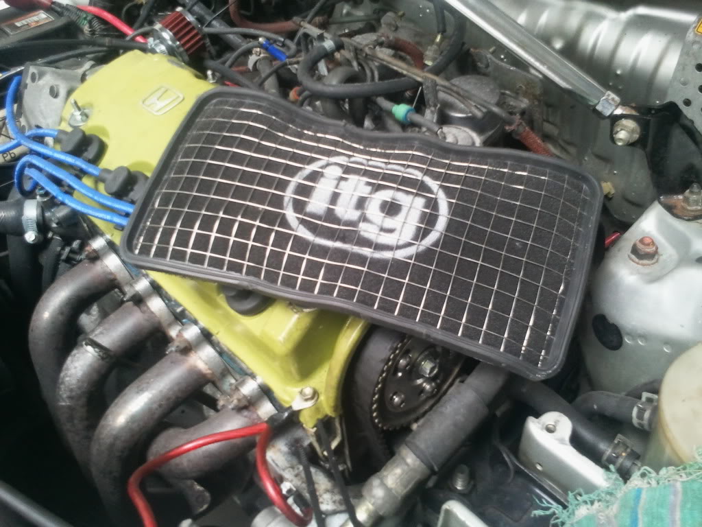

Gave the ITG panel filter that i'd bent round the carb inlets a clean too.

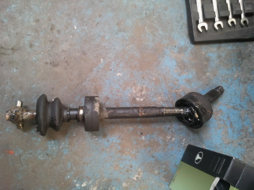

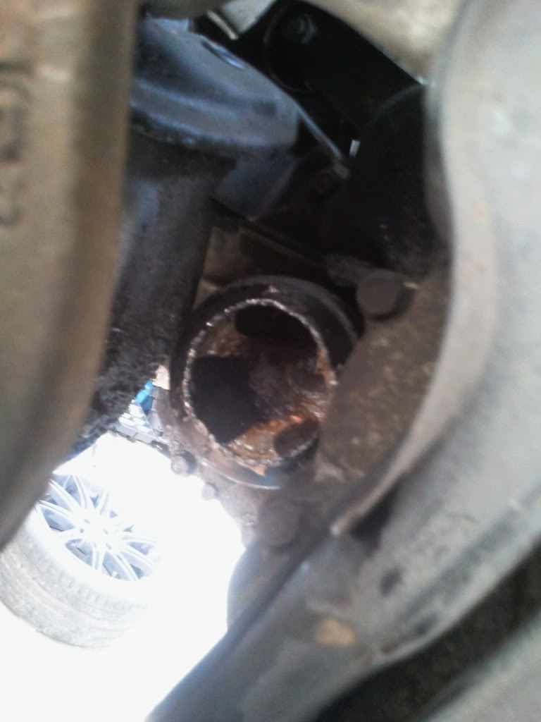

Last job was to change my CV joints as they have been clunking whilst full locking the steering for some time and recently had been getting worse. Both CV boots had split also. My phone battery had almost died at this point so these are the last pics I got.
Both driveshaft boots had also split

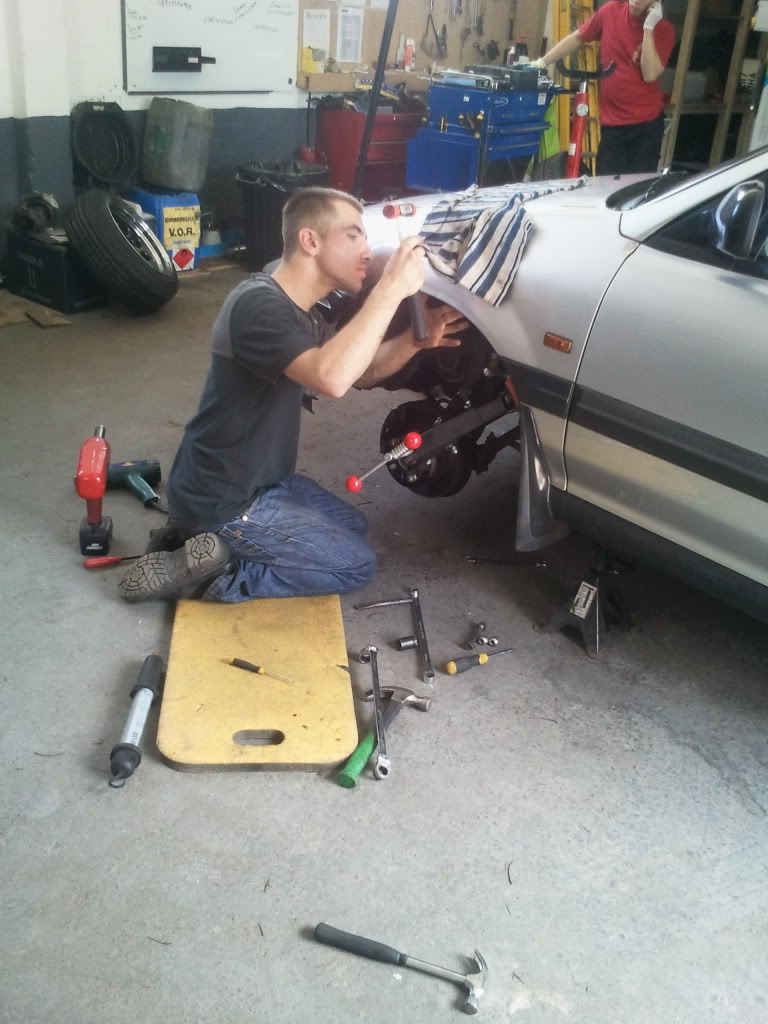

New cv joints installed and new rear trailing arm bushes installed but no pics. it was all put back together and the next day I set off for Emperor Performance to have my front arches flared and rolled.
Kev did a grand job.

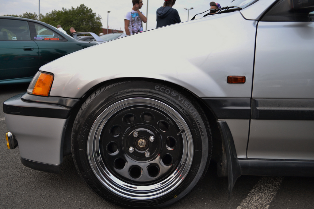

New rims
I thought i'd get away from the "mad tyre strech yo" scene for a bit.
