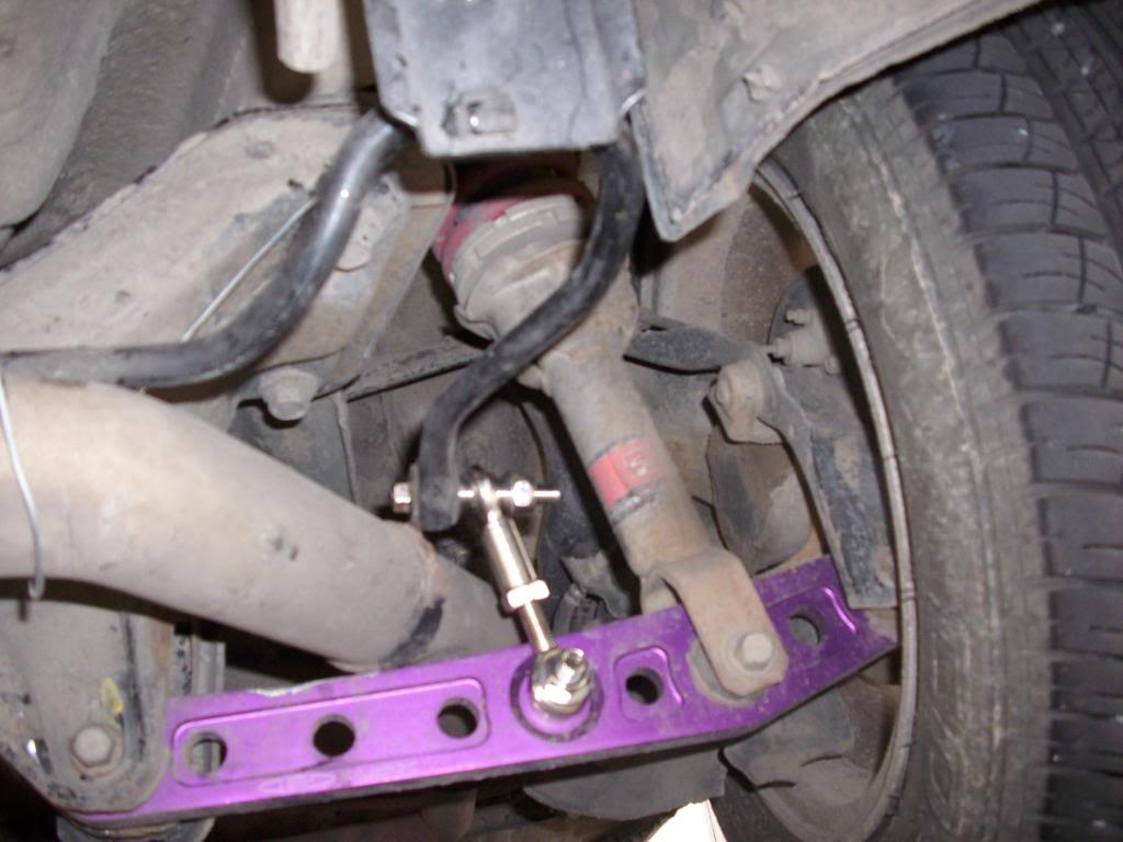

rear sway bar of a 91 si

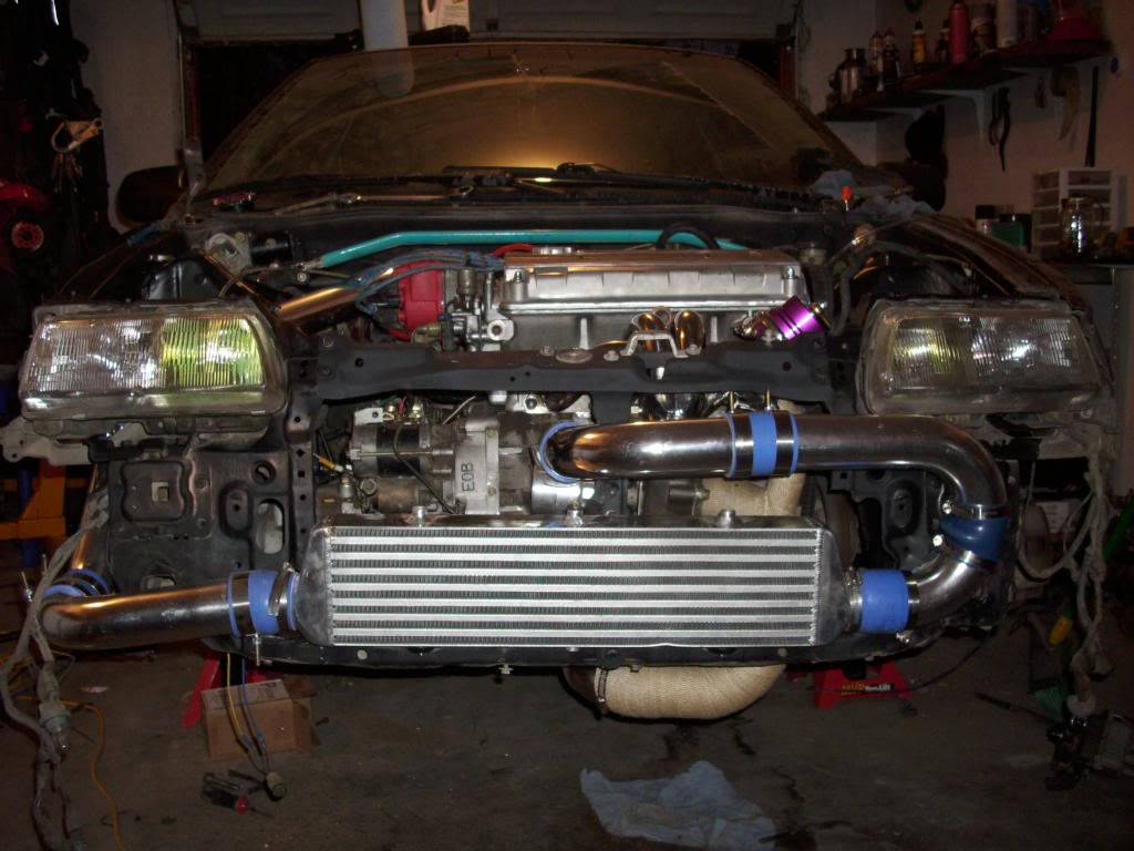

    i love it.absolute sleeper.what kind of exhaust are you running?
  • Nice :) .
  • crv-tecwagoncrv-tecwagon New Wagonist
    lol your going to laugh my friend had about 15 min before he had to leave his shop and close up so i used a broken welder and used a legacy strait pipe a 240sx bend and some other random mandrel bends looks like shit leaks like hell and sound great but after the motor goes in im going to make a new one from scratch 2.5 or 3 in all the way back no cat.

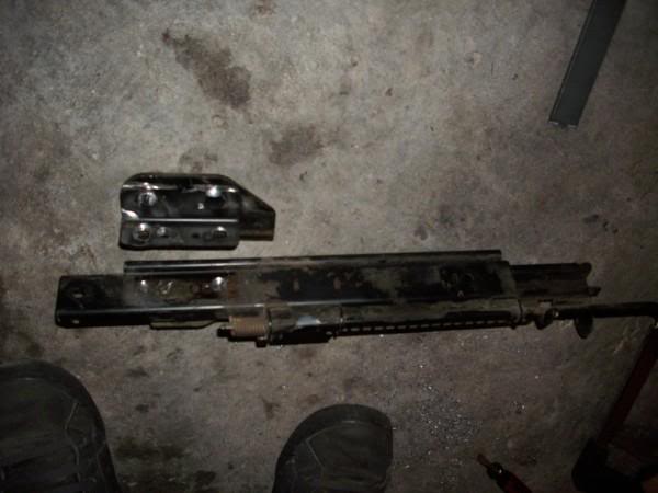

  • Nice build. Got any more pics of the seat mounts?

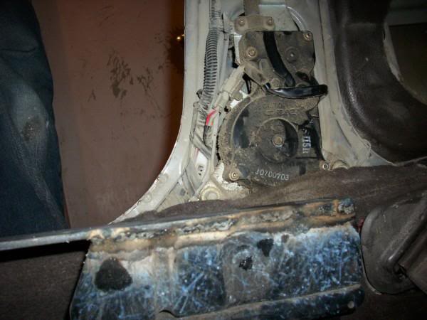

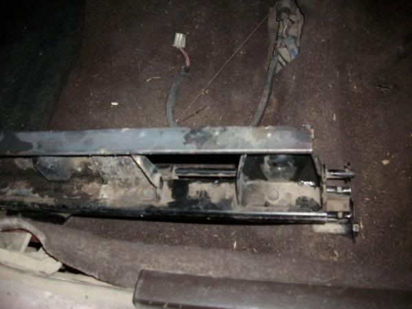

    i had to cut the old seat brackets up to make them buy cutting the plan level with the other side then welding the strips in after drilling holes in for the seat it took about a day.
    here i cut the plan level for this flat strip
    then weled the hell out of it
    the other side is easy you just have to drill out the tac welds
    as shown here
    i have more pictures somewere i look later
    as shown here

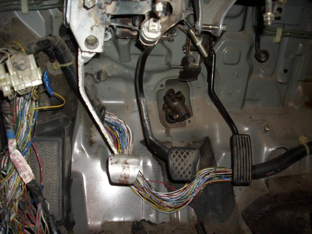

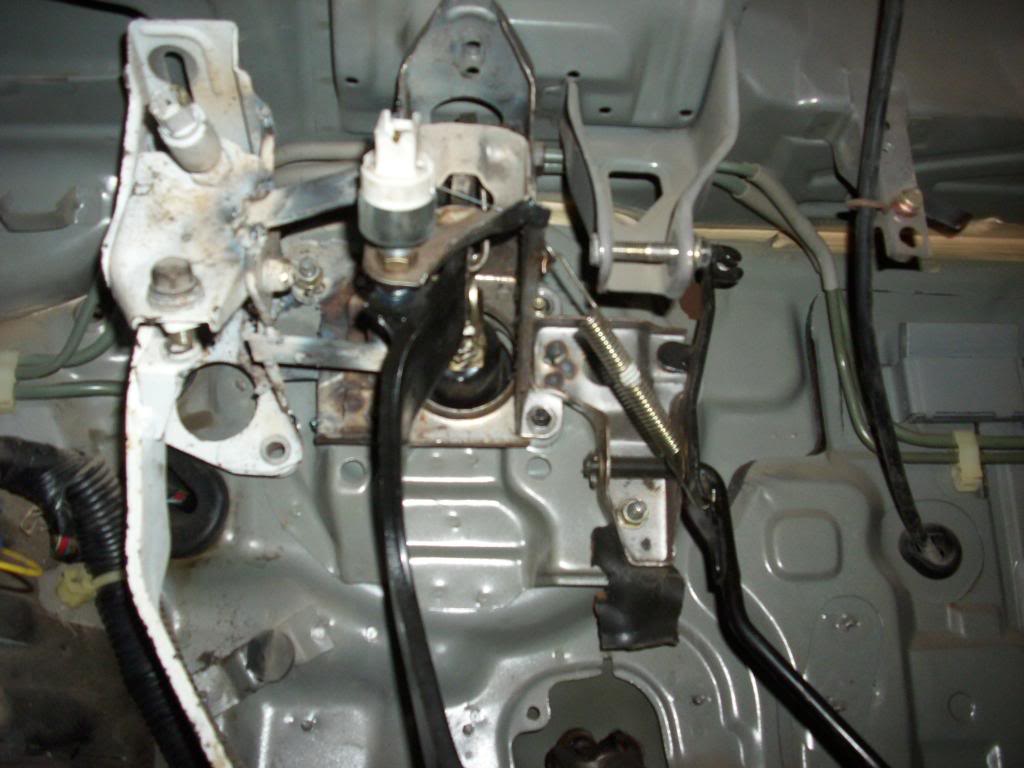

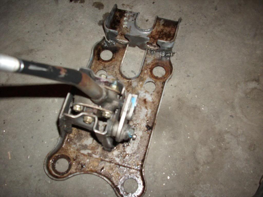

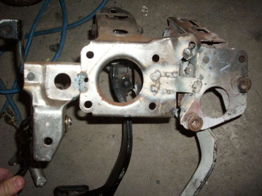

    so here is an update iv got the rear t bracket modifide and the tranny mount done and the shifter cut and welded o and the hydro peddle assy
    here is the peddle assy i was going to use the hassport but i wanted to eliminate the cable

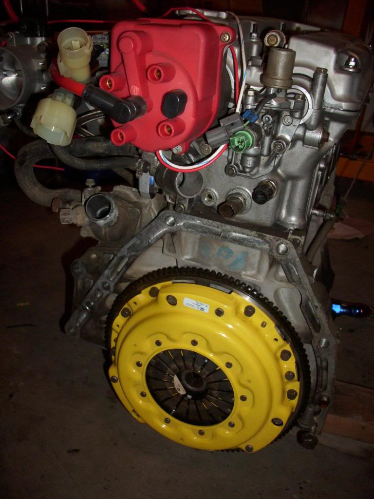

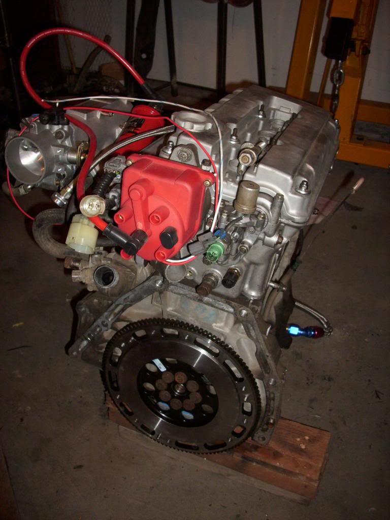

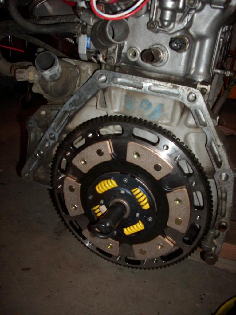

    act prolite flywheel and clutch

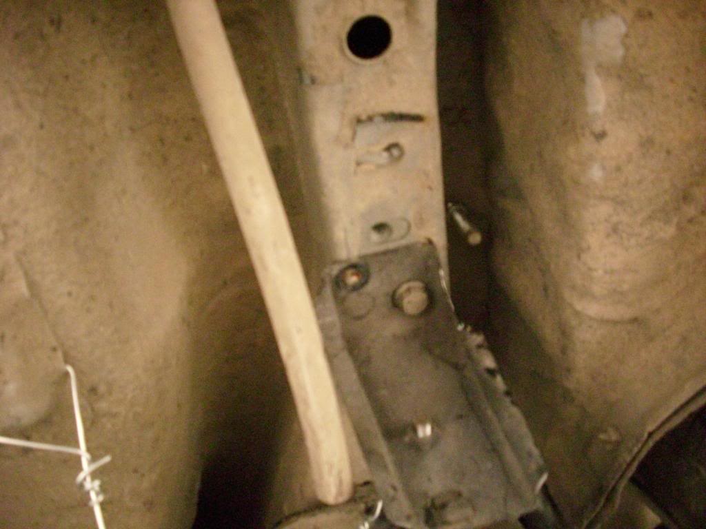

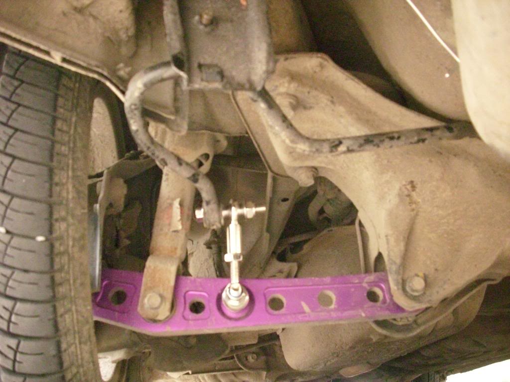

    i used a 91 si rear sway bar that actually bolts up to the rear tow mount holes only one on each side tho no probs yet

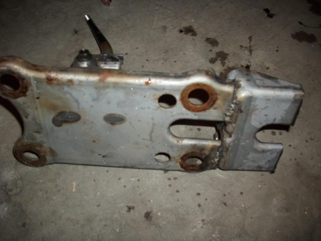

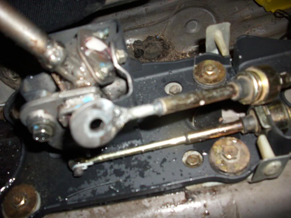

    i measured the side to side cable where it sits best then cut fliped and rewelded it

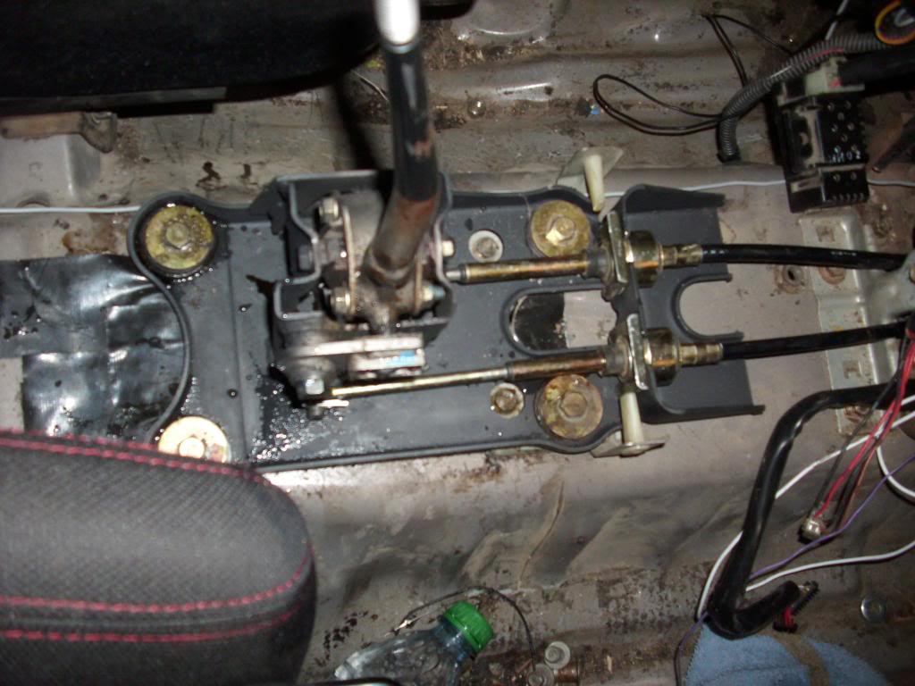

    then i used the crv shift linkage so i had to measure the wire a cut off the plastic end and weld on a washer
    it was actually really easy

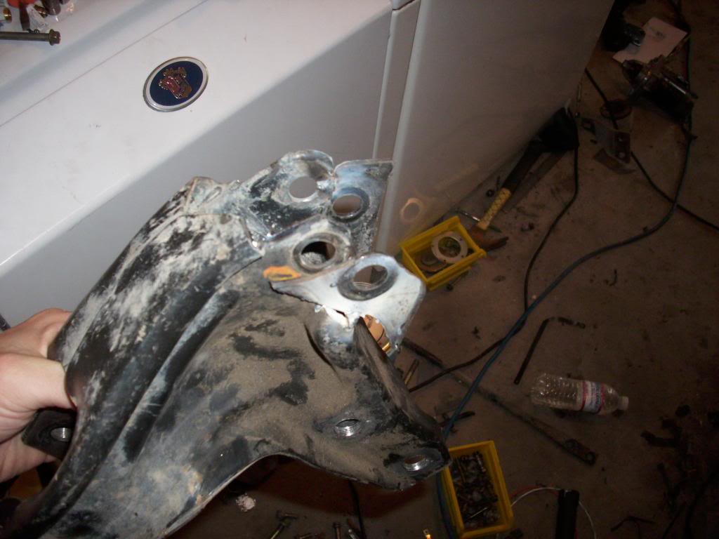

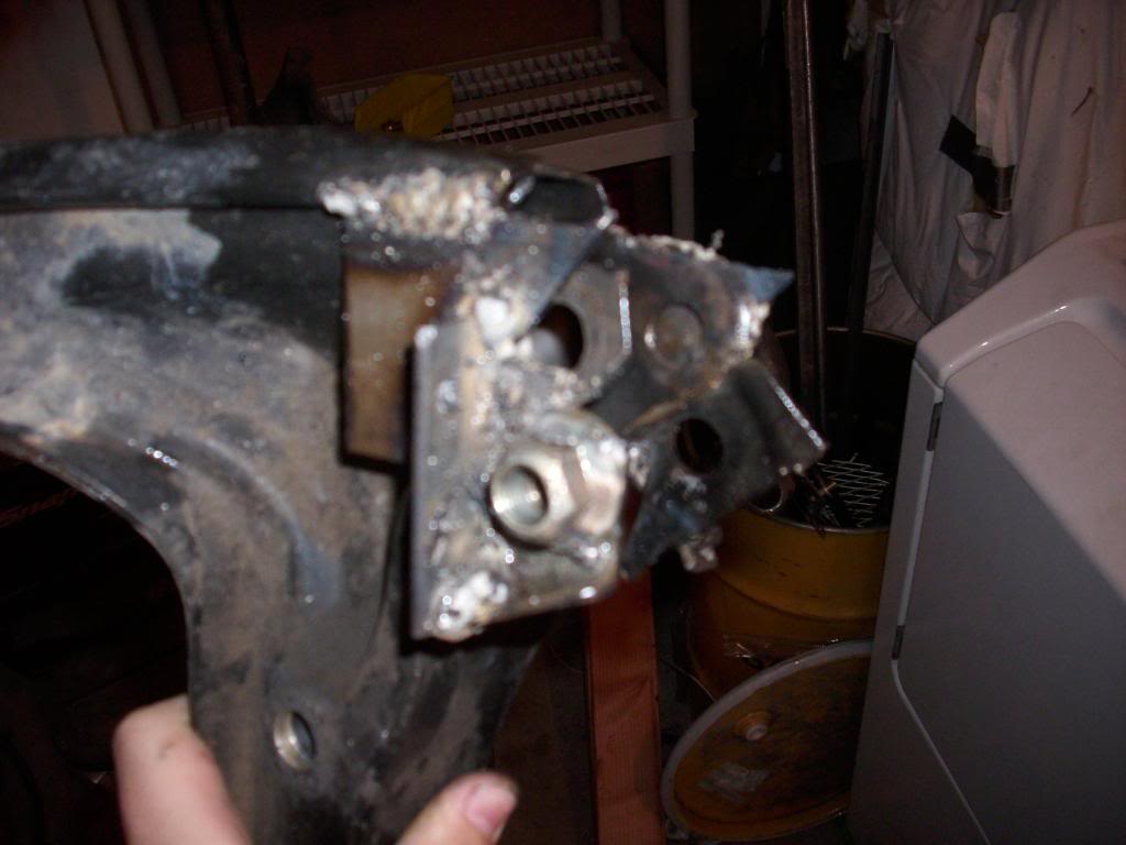

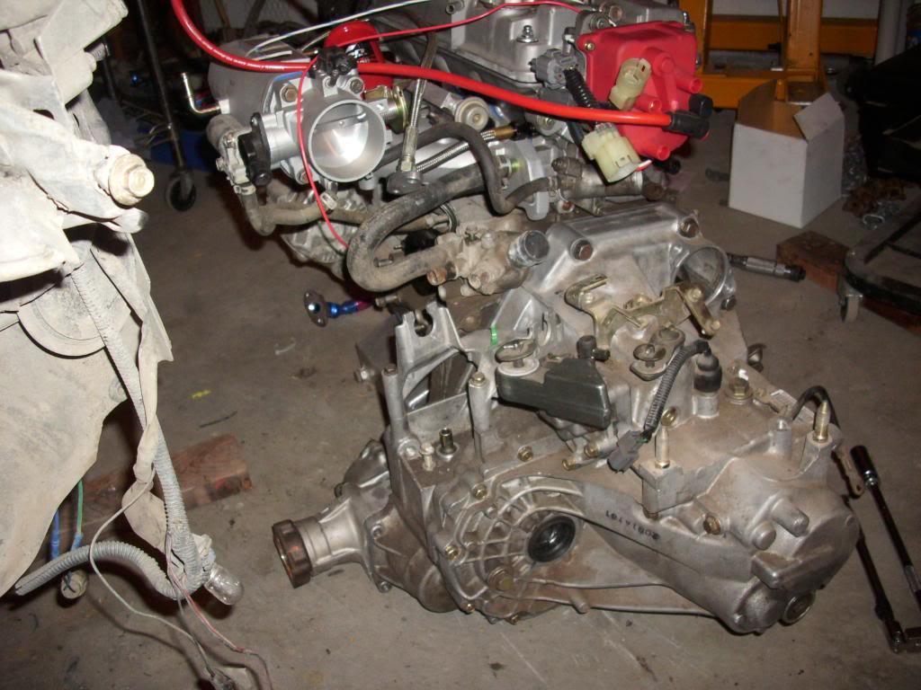

    then i mated the tranny and had to check the T bracket and i used the cable one, i had to weld on a hole that mounts to the motor cause its an inch lower after that it fit right in so i could make a tranny mount and chassis mount
    i cant find th tranny mount pics if you ask ill throw them up later

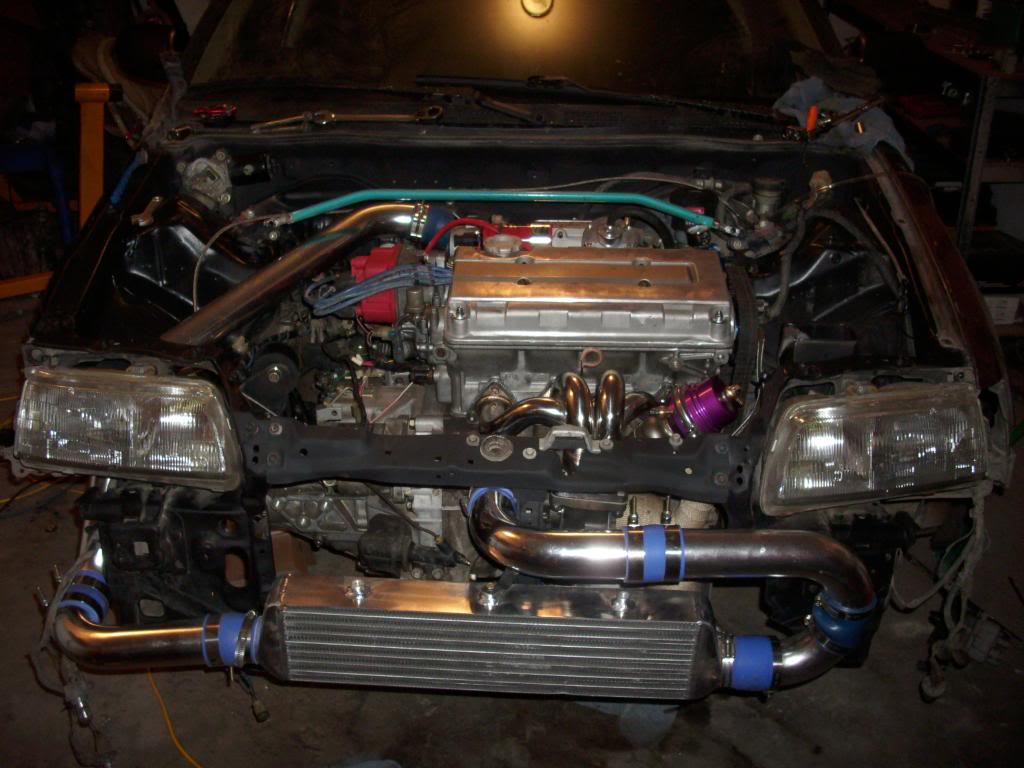

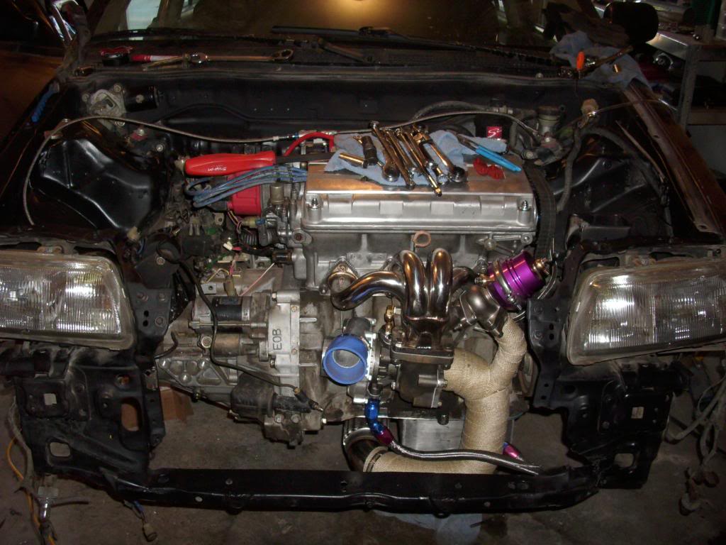

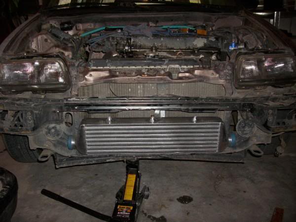

    and i dont like the turbo manifold and the turbo position so i ordered a ramhorn with a little more twist in the turbo
    and i cant find much room for the down pipe so im thinking of free flow out the left side of the front bumper
    so let me know what you think guys any tips or Q's im always open for suggestions and criticism.

    DUDE! That's a hell of an engine, so how hard is it to swap in the crv AWD trans? Isnt it just a rewelded mount and a little bashing with a hammer?
    no bashing but i did modify the t bracket maybe cause i use the cable one but i used the top half of a cable mount for the bushing and welded a plate for the bottom the mounted it on the tranny jacked it up till it was level then welded the chassis mount used from the old ones fits like a dream now there is clearance for the tranny but the rear transfer case leaves barely enough room for exhaust so wait till you mock it up before making one.

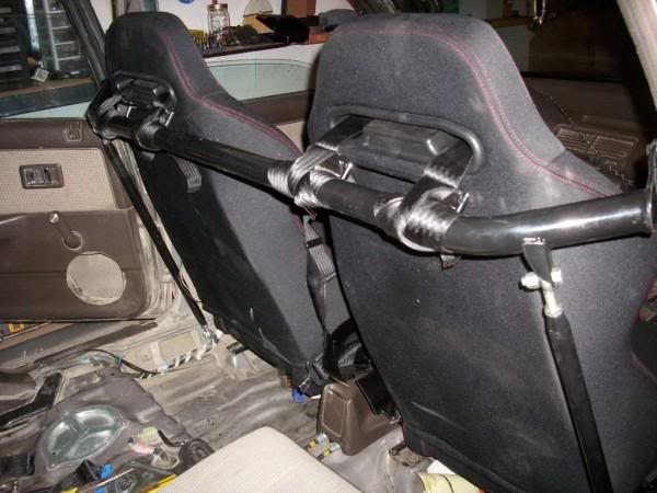

  • awesome man what seats are those?
    there ebay seats there awesome tho only like 250 a set

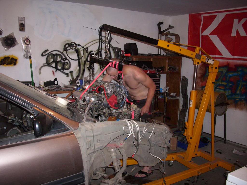

  • well im yankin the motor since my friend is selling me his fully built gsr turbo untuned this motor ran high 9's in a crx but im scared for my tranny and drive-line.
  • where did you get that bar to mount your seat belts?
  • ebay i got it but its not for auto seat belts so i just welded aplate on the piller then a nut on that after that i just had to bend the ears a bit theres spots at the bottom the fit already

    What connector is that? The connector between the LCA and the sway bar? I've found that you can mod a piece from an 87 Accord but this looks hella better, did it come with the LCA or where is it from?
  • i believe it obx-r from ebay.
    This is the closest i got for that sway bar link.
    http://www.obxracingsports.com/products.php?pk=1460
    Dont know if they sell it seperately
  • sorry i just spent a good wile looking for my old buy for the end links and it turns out its blox for civic integra but there not on ebay at the moment here is the site tho.
    http://www.bloxracing.com/product_info. ... ucts_id=62
