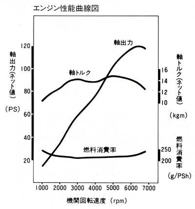

DYNOS: http://www.honda.co.jp/factbook/auto/CO ... 8-018.html

DYNOS: http://www.honda.co.jp/factbook/auto/DO ... 2-014.html
