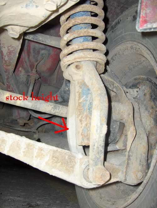

i have a lift kit on mine which i took the whole shock and spring from and integra in the fron=t you have to reallt pry to get it in and bolted on but when its on it is higher and super stiff then i took the front shock and springfrom a civic sedan and loosened the fork at the bottom and cut off the metal tab that stops the fork from sliding up the shock so it efectivly shortened the length of the fron shock by like 3 inches and i put that in the rear so i think it set about 2 inches higher
but i only did that because ithe donor integras rear shock were bad i think you can use the entire integra suspension its very easy stuff to do

it is from the newest body style like 94 and up .. just a stock front i had to stand on the brake rotor and spindle while my buddy slid the bolt throgh cause they are that tall but any way it is just like a really high and stiff stock height
i like it cause you pick up some clearane and pick up alot of spring rate but its a 2 man job cause its a tight fit and prying needs done but once its on there is allmost no sag it actually allmost does the oppisite to your camber making close to positive
but just try to get a used set from a 94 plus and check it out ive never been happier

now listen carefully this is super simple in front my car has a stock integra strut it is large and fits tight ... but it fits
i think that you can also use a stock rear strut from an integra but i happened to have the front strut from a 92-95 four door but i think all of this stuff is interchangeable a rear compared to a front is a huge height difference the front are like 3-4 inches larger than you could ever make work ... so i cut off the brake line tabs and and metal bits and removed the bolt from the fork at the bottom allowing the fork to slide up the body of the shock and sit on the spring perch which allowed about a 3 inch drop on it making it the perfect height for the rear
now my car sits higher than stock and it is much much stiffer ..... but all my bushings are smoked and the car is beat but its a blast when i finish my 2 wheel drive i am gonna get a nicer 4 wheel and really make a nice beater ..... maybe this time i wont weld the roof rack straight to the roof ...

I had stock 94-00 Integra shocks and springs on a 89 CRX for a while just to get it on the road, and they lifted it a good 1.5 + inches. This set up bolts right on to the 89-91 CRX, so im sure it will bolt on to any 89-91 wagon.
