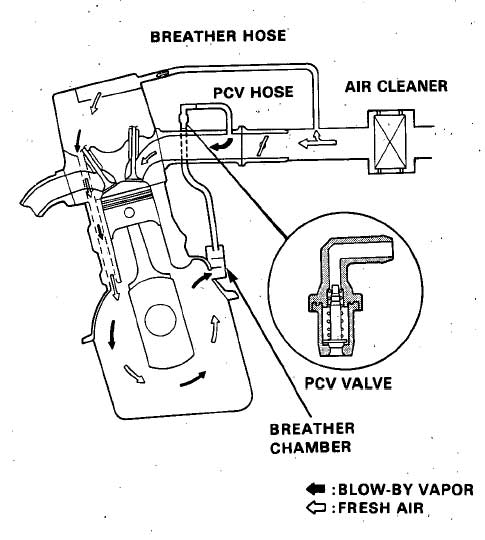

That should help a little.
At idle you should feel a vacuum on the bottom of the PCV valve if you unplug the hose, that lets you know that the valve is working properly.
And yes, it does seem like a large vacuum leak, but it's not as big as you think, and it's really kind of a "factory controlled vacuum leak," and it is constant. There shouldn't be that much air moving through the crankcase at all unless you have serious piston ring problems. That air moving through the crankcase is called "blow-by" and it is caused by the fact that piston rings cannot seal the combustion chamber 100%. Also keep in mind that crankcase vapors contain some vaporized fuel and oil, which help aid combustion a little bit which makes this little "vacuum leak" a lot more bearable because it doesn't cause a noticeable change in AFR.
In reality the only time the PCV valve should close is if the pressure in the manifold increases A LOT. This will happen on turbocharged engines, and it will also happen if your engine backfires into the intake manifold. If you have a backfire in the intake manifold, the PCV valve MUST keep that combustion from entering the crankcase. If it doesn't then your crankcase could explode (remember blow-by is air mixed with vaporized oil and fuel). On a turbocharged engine the PCV valve must keep the crazy amount of manifold pressure from getting into the crankcase because it will cause the seals in the engine to hemorrhage oil (the crankcase was designed to work under vacuum not pressure, and pressure will push oil right past the seals).
So long story short, it sounds like your PCV valve is functioning properly, just make sure you replace all the hoses!

"the PCV valve itself is designed to allow the most amount of gasses through it, when the least amount of vacuum is present.
at idle, the PCV valve should block about 98% of the air flowing through it. at WOT or atmospheric pressure, the PCV valve plunger will be floating and allow crank case pressure to bypass it and be consumed by the engine.
it sounds like your PCV valve has seen better days."
blowby isn't that much air. Everything else has to come through the head via the smaller passages. I'm sitting inside away from my shop, but if i remember correctly there are only some small passageways that let oil drain from the head back to the block. Other than that.... there's no other inlets for the block to suck in air.
