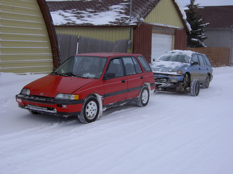

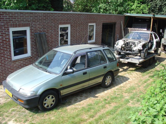

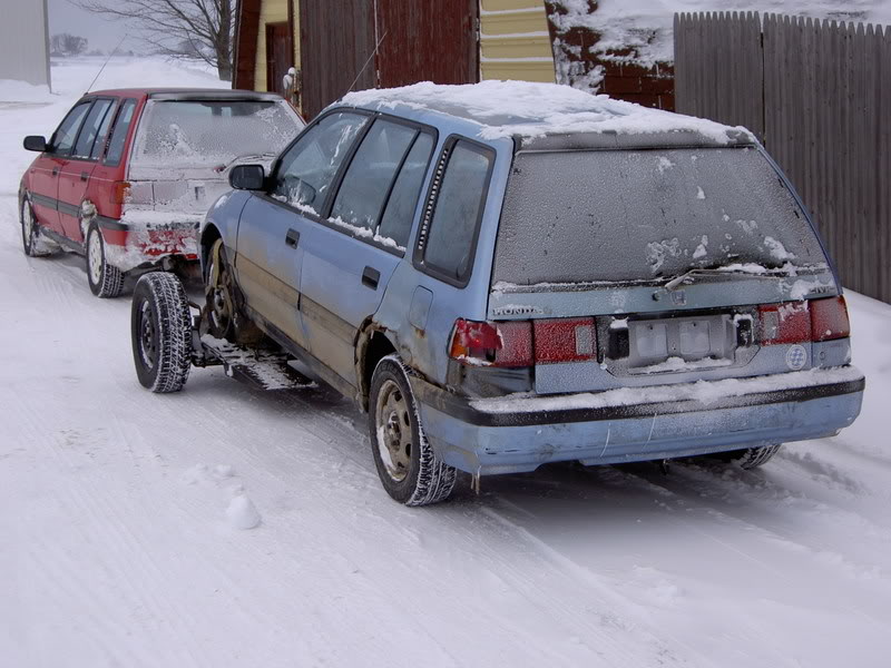

    Another Wagon tows:
    viewtopic.php?p=11608#11608
