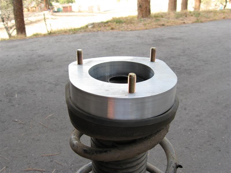

this is how a lot of the new toyotas are lifted.....
What do you guys think?

With the way you designed the rear spacer, the spacer is allowed to rotate in 2-axis, something the original design doesn't account for.
The front is an interesting design, but I think the spacers on top is a more sound design as it spreads the load much better.

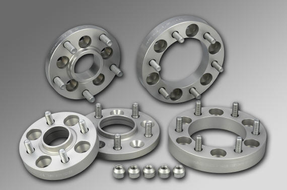

Though, as it's pictured above, I'm not all that excited about. With that much material, instead of extending the length of the stud, I would make offset holes with another set of studs, much like the wheel spacers pictured below:
