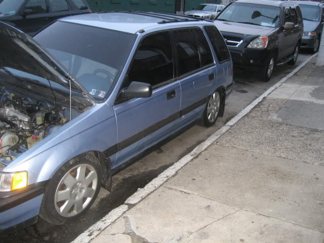

NEW PICS
let me know what u guys think

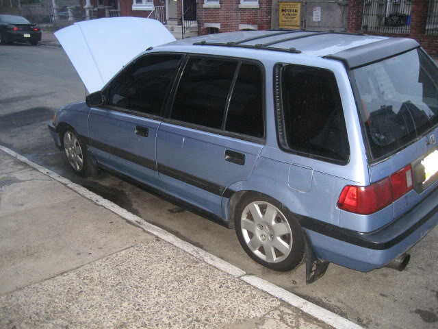

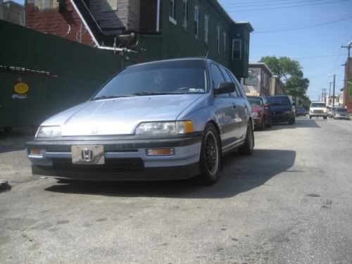

this is how it looked when i went to pick it up i had to shovel it out
now in front of my house

    looks clean w hubcaps.... sound like u got it all planned out.. im just taking it lil by lil w my wagon.. is it runnin cool.. why u get it soo cheap
  • I love it, even covered in snow. Amazing price also, good luck with the build and keep us posted.
  • i got is so cheap because the guy i sold it to is like my best friend and i see him everyday and i convinced him that it was gonna be alot of money to fix until he gave in and sold it to me haha...but yea i just came from the junk yard today all i manage to find was the da sway bar, il post pics in a few, no luck on the back hatch or a/c system though :(
  • Like it , even covered in snow . You got it back . Now never give it up again . Good luck with your build .

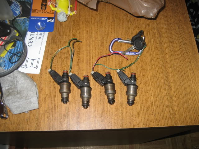

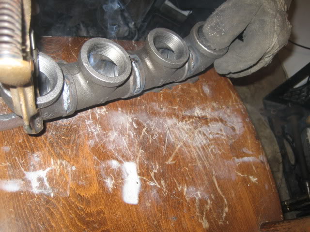

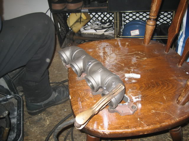

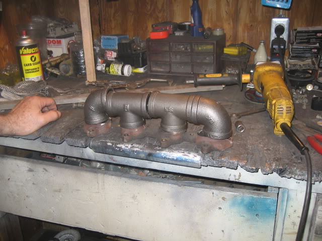

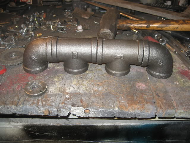

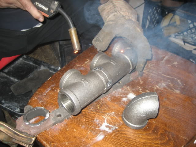

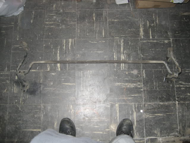

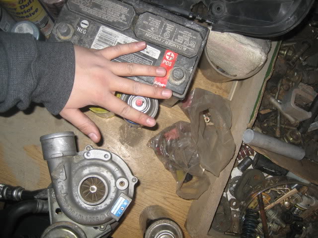

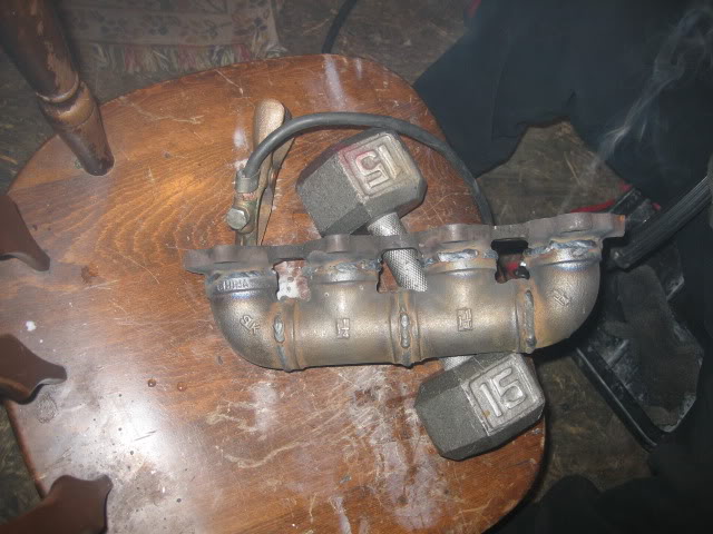

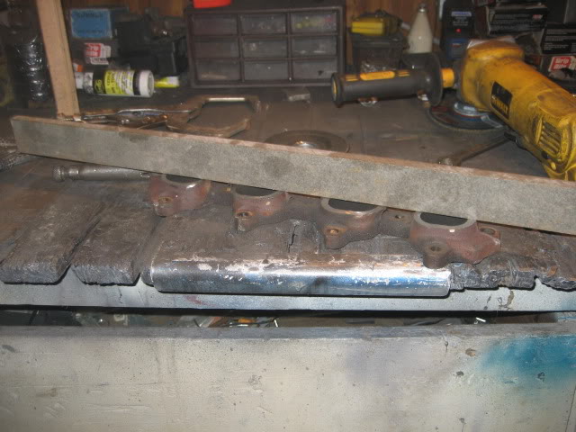

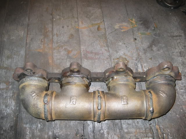

    so i was at the junk yard today heres what i found today, i found some dsm 450 injectors of a eclipse gst auto for $40 :) also found a da sway bar for 10 bucks, the y7 oil pan i found it for 20 buck and am picking it up tommorow...i also finished putting together the home made turbo manifold here are the pics....

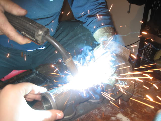

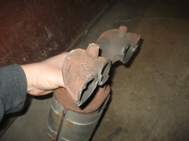

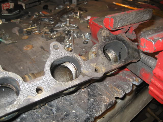

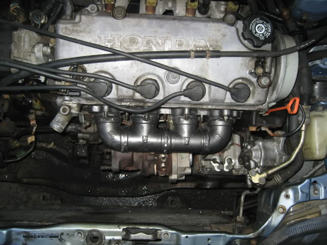

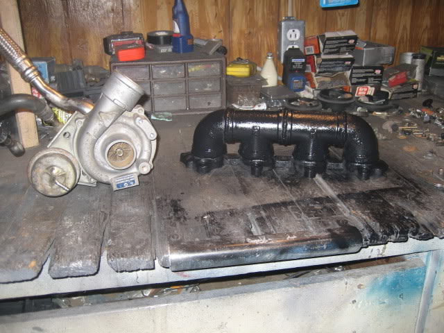

    started out with a stock y7 manifold

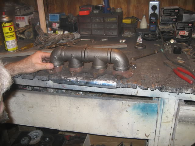

    here the piping from home depot and what is supposed to look like

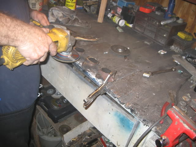

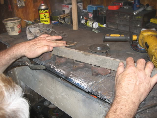

    i had to cut off like a 1/4 inch on the end elbows

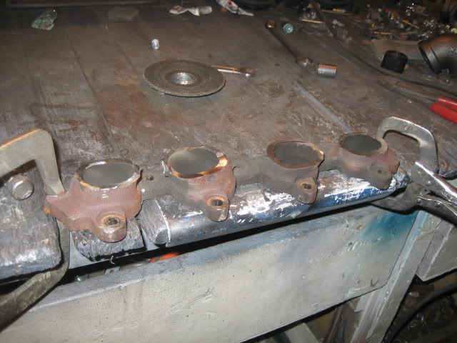

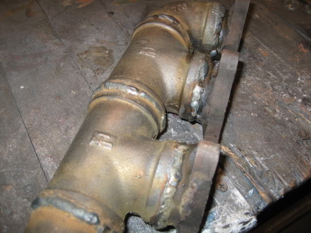

    now the welding
    finished product before paint
    and painted next to my k03 turbo

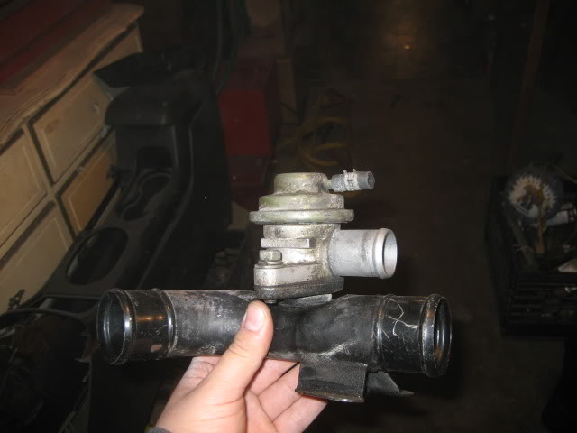

    here are the pics of the turbo and the injector and the sway bar and bov

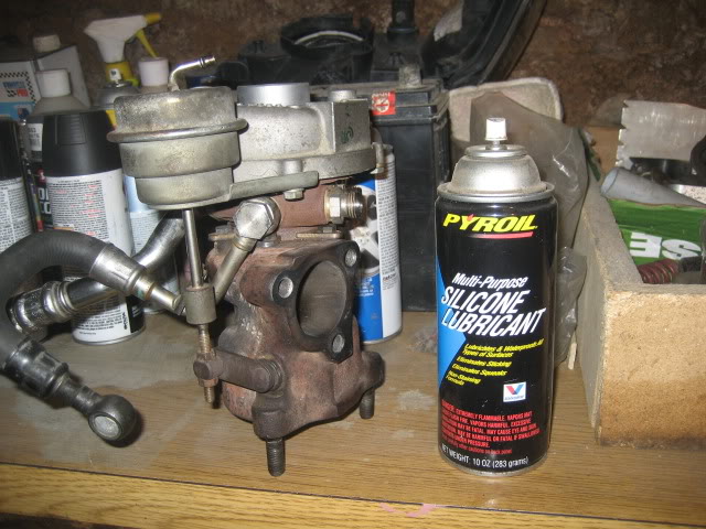

    just to give u a idea of how tiny this thing is haha i love it no homo

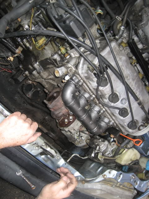

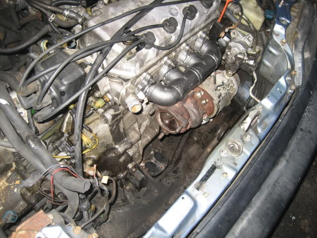

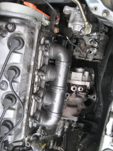

    so the manifold is done now i have to take it to the engine bay to see were am gonna locate the turbo flange so i can clear the a/c and ps :)

    what year gst did those injectors come off?
  • am not sure the year but it was a second gen automatic, i know they are 450cc for sure because it says it on there and it still had the turbo manifold
  • Nice DIY turbo manifold .
  • i don't think i could build my own manifold but props to your innovative idea's....lmk how it turns out
  • Nice homemade manifold. I'm in for this turbo set-up build...

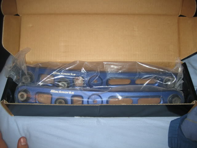

    hahaha it will still be slow just alot more fun, well heres what i picked up today
    they are blue btw, am making my own custom lower tie bar since they dont make them for the rt4wd wagon

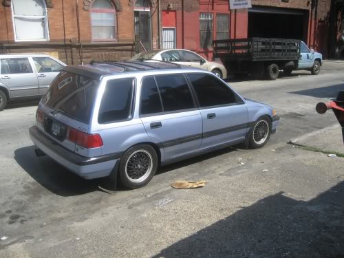

    ok il post them up tomorrow wen i takes pics, but for now here is my wagon before i sold it 2 years ago haha
    and btw thats the homedepot lip

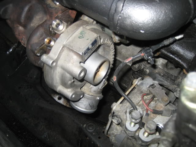

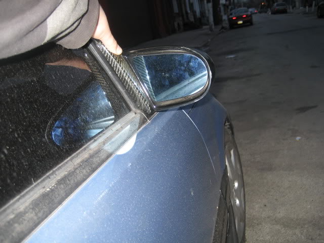

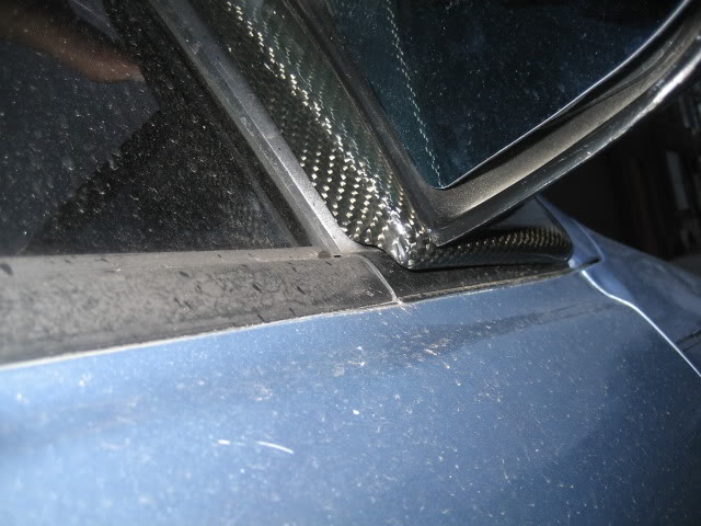

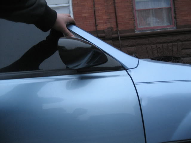

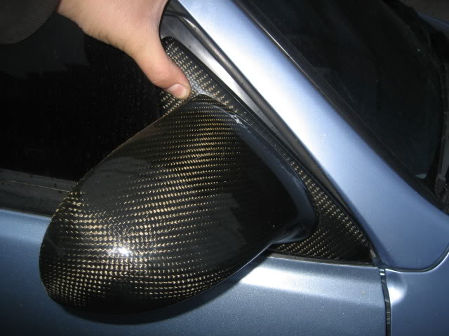

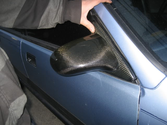

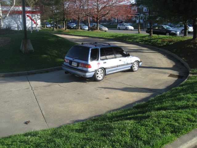

    ok so i didnt do the rear lcas today but i did get the turbo on to the manifold and it cleared the a/c and ps, also got pics of the carbon fiber mirrors and some random pics.....
    here are the ek carbon fiber spoon mirror it fits perfect, i just gotta drill the 3 hoes in the lid and screw them on, the driver side is gonna be a lil harder but not too hard
    and some random pics of it in front of my house
  • hahaha it will still be slow just alot more fun, well heres what i picked up today
    and i love ur wagon njcivicwagon my fav

  • Hells yea that mani looks like it came out perfect . Keep us updated . Also those mirrors are going to look sweet . Can you still control them from the inside ?
  • slowassrt4wdslowassrt4wd New Wagonist
    naw u cant control these from the inside:( but is fine i just set them once and hardly ever have to readjust them, i should be taking the tranny down tomorrow but am still waiting for the clutch to come in the mail....but thanks guys, u are what keeps me motivated haha
  • the mani def turned out nice .
    Did u have the ek mirrors already or did u order them on purpose ?
    Ive thought about getting some before but i wasnt sure if i odered the ef ones if they would fit best or if the ek ones would work better .
    I just wondering since i found the non carbon fiber ones for 30 bux shipped and im really thinking about getting them after seeing them on ur wagon
    i already had them i was just checking if they fit somewhat and they did so am gonna use them, but yea u should buy them i think they look great

    yea i got the turbo installed and the ecu chipped the car run like a dream, turbo spools super fast sounds awesome BUT i have to take everything out tomorrow, it looks like the turbo seals are bad am burning mad oil:( so am putting the stock mani back on until further notice lol but definitely was fun for the week it was turbo, ill snap some pics before i start taking it apart

  • Damm that was quick . Sorry your turbo took a dump . How much boost where you running ?
    8psi, it was runing nice too, but i think i like it the way is running now better, alot smoother n stuff...also some dumbass on sait patrics day ran into the back of my wagon luckily it only broke my tail light and the piece that goes under the tail light got crushed, i found it at the the junkyard so everything is good. i got both fresh taillights from a mint rt at the junkyard he had the uhaul wiring installed with the tails to i took that aswell, it also had a passenger side mirror so i grabbed that too very rare to see one of these wagos at a junkyard especially a rt, i was kinda glad the guy hit me cus i got to find that wagon at the junkyard and since we didnt call the cops he payed me 150 buck and i only spent 50 on fixing it and gettin the other peices that i didnt need but wanted lol
