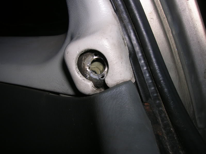

  • my bad. I guess what i posted was confusing :D
    Here's the piece im talking about.Bottom mount for the struts that hold up the hatch. You can see in the picture that is not threaded :?
    AHHH! The nut that was spot-welded inside the body has broken off.
    Here's what I would do: The aftermarket hatch struts I have come with a detachable ball-stud for that lower mount (as opposed to the OE style where the stud is captive to the strut end). Just get those and fish a nut up behind the panel, once you tighten it up it should never have to be moved again.

    Hmm that may work. I have OEM struts but i'll see if i can make it work.
