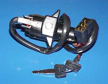

The tumbler and key are worn out pretty good. You can take the key out of the ignition at any position, including when the engine is running..

I will try what you guys have written, but I really think it's the key switch. Sometimes she can't turn it at all, other times it's difficult. It's normal to be able to pull the key out at any position? Even with the car running? I don't think so.
