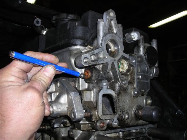

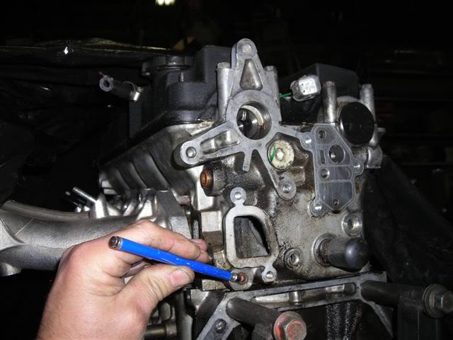

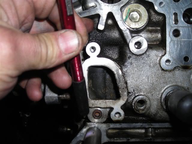

which are obviously connected thus
My choice would be the upper, larger one.
Where the bottom of this intersects the head mating surface is where you have to thread and plug the original VTEC oil supply passage (or have it welded).
