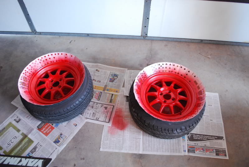

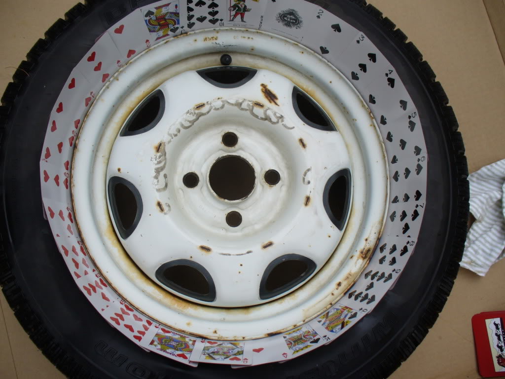

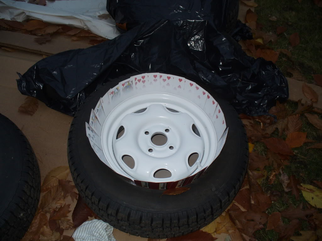

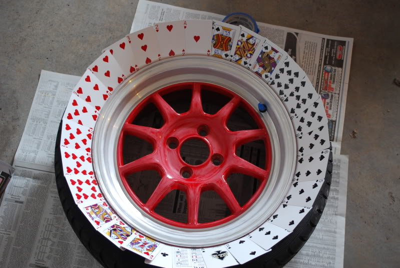

If the tyres are on, its no worries taping up the rim - just takes a bit longer, or use a pack of playing cards like Billboard did on his red RT GT3's, and lay a dust sheet round the tyre.

lols foshizzle... i just sand, then stick a deck of cards around the outside and spray...
