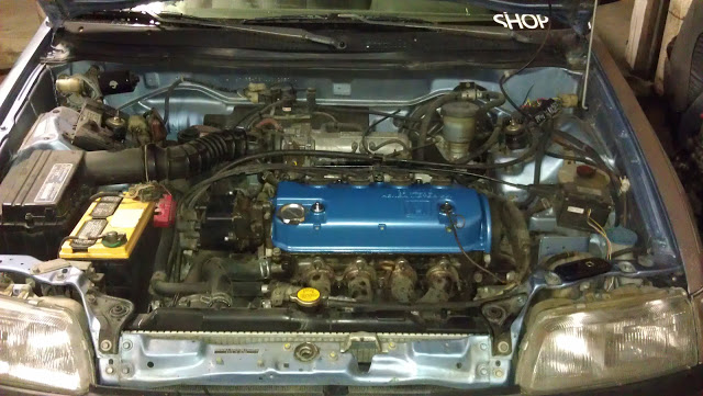

Hey guys,

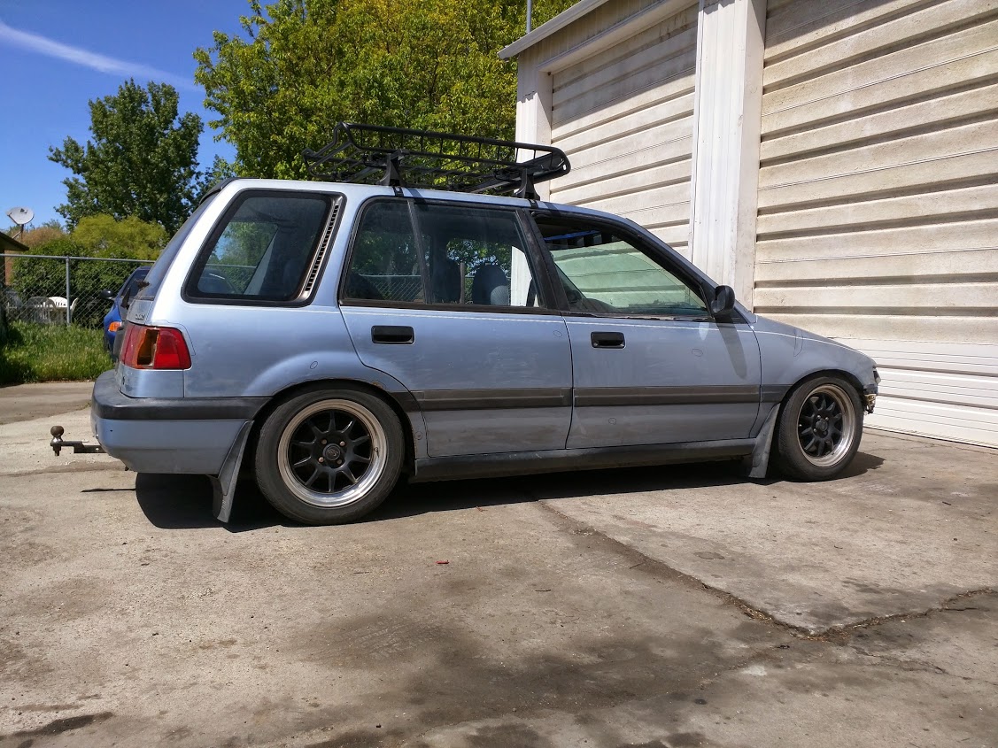

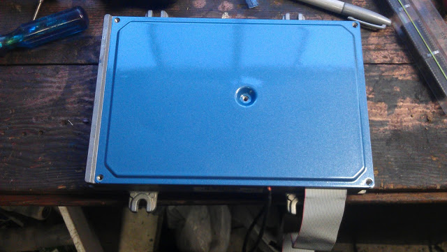

Figured it's time I got a thread started for my RT4WD I got earlier this year. I just got her running again after the motor went. Here are some pics and the mod list.
Engine:
D16A6 12:1 Compression
88-89 Integra p29 Pistons
D16Z6 Head

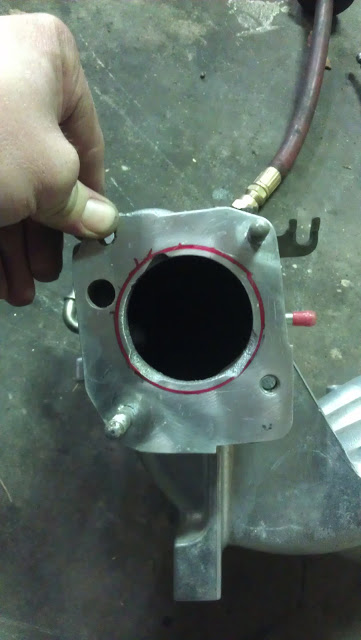

D16Y8 Intake Manifold ported to 60mm
96 B18B 60mm Throttle Body
New OEM Rods
ACL Race bearings (Rod and Crank)
OEM Main and rear seals
New water pump
Relapped all valves
Generic 4-2-1 header custom modified to go around RT front differential
Fake 2.5" Cat
2.25" Resonator (3 ft long)
2.25" Exhaust Piping
2.25" Universal Ansa Muffler with tunable Silencer
Rywire OBD1 conversion harness
Chipped P28 ecu tuned with Crome Pro
Suspension / Braking:
Stock 87 Accord front struts
Modified 03 Civic Rear Struts
Generic front/rear coilovers
Skunk2 LCA's - Gold
15/16" Master Cylinder
11.1" Prelude Front Rotors / Calipers
Skunk2 Pro series front upper control arm

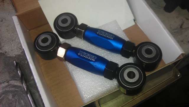

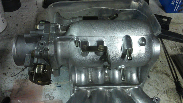

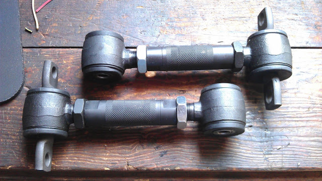

Wicked Rear Toe adjustment arms
Rear upper camber arms
Interior:
Focal 165 KRX2 Components
MTX Thunder 405 4 Channel Amplifier (for Focal components)
Cruise Control (came with the car - had to fix some wiring to get it to work)
Wink Mirror
The infamous "Walmart Cupholder" mod
Exterior:
DA Front Lip
Custom 1.25" tow hitch
Custom trailer wiring
New Rear Wiper Motor
Passenger Side Mirror
15x7 Rota Wheels
205/50R15 Kumho AST Tires
Before new paint:
After new paint:
