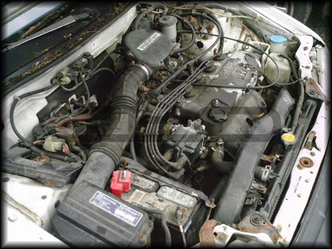

Well since taking multiple pictures of the grinding process is kinda worthless. I decided to just take the before and after shots. Remember that this is not the final product. The aluminum manifold will be coated with a high temp coating.
Before
After
The whole grinding, sanding process was to easy and only took me about 15 minutes to do. A trained monkey could does this. :nyah
Maybe tonight I will wrap the turbo manifold or something.. :rolleyes:
nice sanding and polishing?
i wanted to do something like that if its what i think i see correctly in the picture.
can you show or tell us the supplies u used and how it was done?
Well I just used my Dewalt Heavy-Duty 4-1/2" (115mm) Small Angle Grinder with a stock grinding disk and then smoothed it out with a basic flap wheel.
Sorry to say but, I will not be keeping the polished look.. I plan on not only giving it a heat resistant coating but at the same time be trying to disguise most of the engine bay with a flat almost stealthy like appearance. I am trying to keep peoples eyes out of my engine bay at the track and on the streets.
