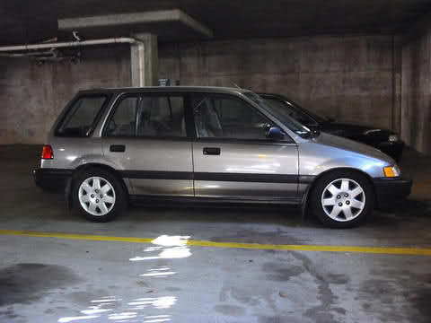

Here's Gutterslides Wagon:H&R sport springs &Tokico Illuminas:
