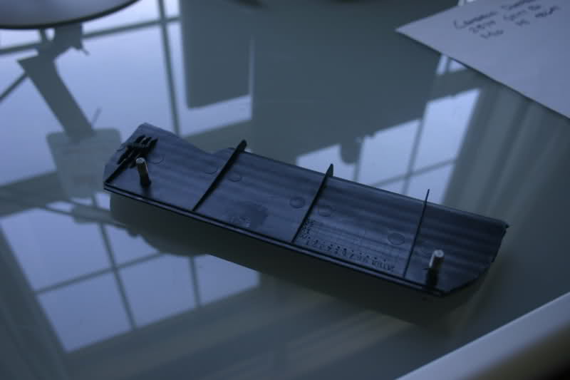

    ok so i got one of these map lights today for $2.
    now, it was originally bolted to the Teg via a plate that was part of the sunroof. now, obviously we dont have this plate. so my question is- and i read through but couldnt really tell- how is this thing bolt/mounted/screwed to the car?

    I used very small - maybe m6 or so - machine screws with washers for the holes I drilled along the edges of the plastic (the part that is paired with the headliner obviously). For the backing I used the nuts paired with fender-style washers that covered a large enough surface area on the back to provide stability. Just junk I had in my misc. hardware container.
    Skinny's idea would work great as well. There is no bracketry mounted to the roof skin like there are in Integras so we are forced to come up with our own solution.
    alrighty, so i took a broken interior plastic trim piece i had left over from my car lol and used that as the backing plate. used 2 left over screws from an old dizzy cap (they are perfect thread to the OEM bolts that the Teg had it mounted with) and voila.. its worked well =)

    it used to be a rear door jam trim piece
