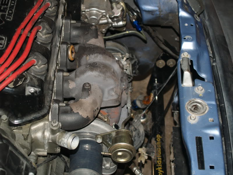

    i am building two motor for it. the first is one going in the car is a z6 block with Vitara pistons, eagle h beam rods, acl race bearing, blue print/ balance ,arp head studs, block grad, with a complete stock jdm d15b vtec head.this motor is just a temp motor in tall i finish the second motor. i am building a one off side wider manifold. gt3071r turbo, 780cc injector, ectune ems, going to be tune on e85. 26psi daily...... the second motor is a a6 block,75.5 Vitara pistons, eagle rods, knife edge crank,acl race bearings, arp head studs,blue print/ balance, stage 5 ported z6 head with Brian Crower Springs/ titanium retainers, zex 59300 cam, skunk2 intake manifold, 70mm throttle body,780cc injector, act street lite flywheel, clutchmaster stage 3 clutch, same turbo kit...... :D

    here is some more stuff i am working on.

    here is some more pics :D
