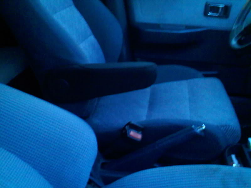

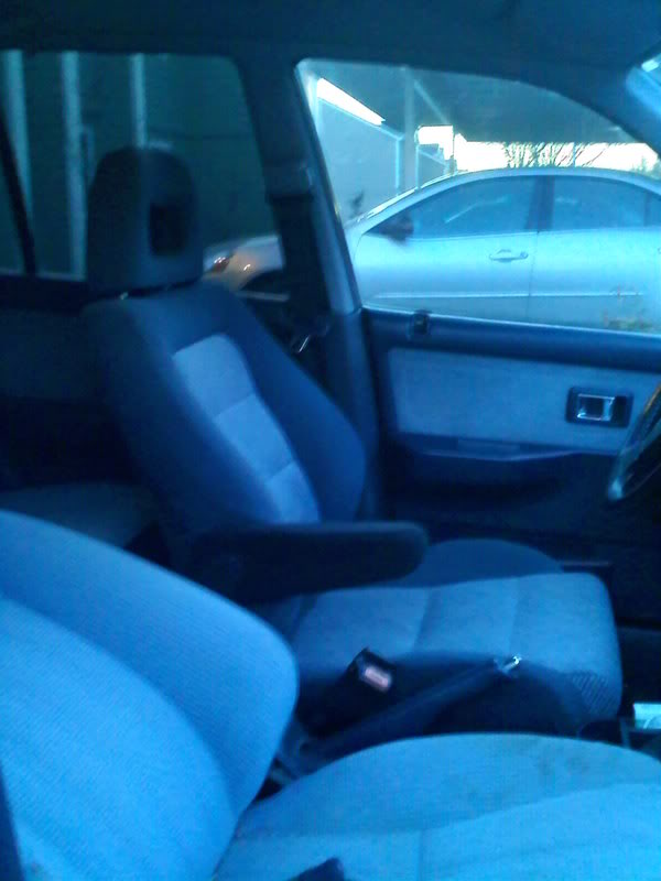

  • Got two DA seats from a guy at the shop i work at (FREE :D ). Had to take them apart and put all the passenger foam and covers onto the drivers side frame, after a good wash to the covers. They fit pretty good. While they were apart a realized i could put an armrest on it :D Had an armrest from a fit, so with a simple drilled hole i was able to put it on. The seat is angled twords the center, so i need to figure the best way to angle it outward.
  • Ya its really not to hard to do that; the same armrest that I bought from handa (not honda) for my CR-V will fit these teggy seats.
    Can't beat free! Why are they leaning? How did you take care of the inner teg rail?
  • When i took the wagon seats out, the back bolt just broke loose. Now there is a hole where the threaded part should be(bout a quarter size). The seat doesn't lean, it angles twords the center. Kinda crooked. So now the back of the teg rail has no spot to mount it. Not that big of a deal, still pretty sturdy. Think i just need to wobble a hole a little more. I'll check it out this next week. Man what a dif this seat makes!!!!
    how exactly did you install that armrest?
  • With the back of the integra seat apart there is a threaded portion on that side bolster. The arm rest has one mounting bolt and one that holds it in position. The threaded portion got the stable bolt and i had to drill another hole for the back bolt. Then cut part of the foam away after the foam was installed. reinstalled the cover and put a slit where the armrest bolts would go. Installed arm rest with bolt and nut.
    ok so the DA seat was "prefabbed" at the factory for an armrest...
  • It was prefabbed for something, but with only one hole idk what. Just cant wait to find a clean set of seats :evil:
