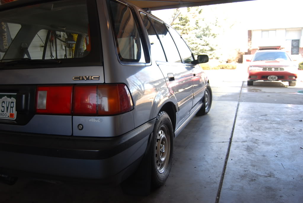

Anyway, I finished up the rear today. I didn't even attempt the sway yet as I am planning on waiting until I do my exhaust since it will be out and I will be a welding fool that day.
The parts!
Really only about 0.25" difference with the rears.
The rear came down about .75" putting me a hair over 14" for rear ride height. That means my front is about .5" lower which actually is just dandy with me.
I guess I will be scrubbing the flaps from now on :shock:
Pics do the talking mostly. So far the ride is much more controlled; probably similar to what the car felt like new. My stock dampers were from 11/87, leaking and old. These springs ride like wonderfully so far; not even close to being too stiff. With a GR-2 or a bit more shock than the stock DC ones I bet this ride would stiffen up a hair and improve dramatically.
If I want to raise the front up another 0.5" that wouldn't be a problem with some homemade spacers between the tophat and the body mount. I will see how I like it with some miles put on it; so far I've only driven it about 10 miles. So far its a vast improvement over stock. Thanks for looking.
DC2 suspension a success! Keep in mind these are lowering springs; if one went with stock Integra springs I bet the ride height would be VERY close to stock (for a 4wd). Since I used the 89+ RLCA I think that ended up dropping me about 0.5" as the 88's are definitely shaped a bit "different"; its to bad the 89+ aren't as light as the 88's.

Matter of fact; after driving it for an extra 100 miles since yesterday the rear has basically come down to almost match the front. The whole car is basically level now and the look is definitely growing on me. Though I know when I'm loaded up and off road I will be scraping a few things more than I'd like; I absolutely love how the car feels now.
