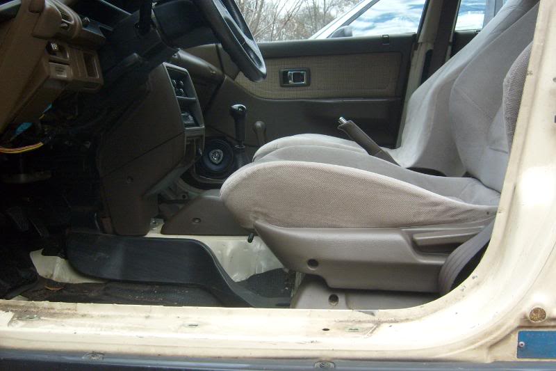

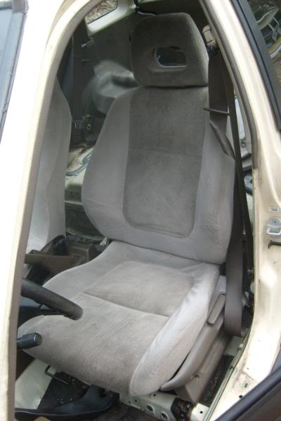

Went to Bam-bams today to get these DC seats mounted in my car. Wound up using the outer wagon rail and the inner Integra rail. After some cutting, welding, and mounting we got 'em worked out.
Just some pictures of it all.
The test fit, they line up really well.
The two outer cars made the middle car. LOL
They fit great. I have seat covers to go over them but I didn't get a picture because it was too dark and I'd already pulled out of the garage. But all in all I'm majorly happy with the out come. Thanks for all the help, Trev!

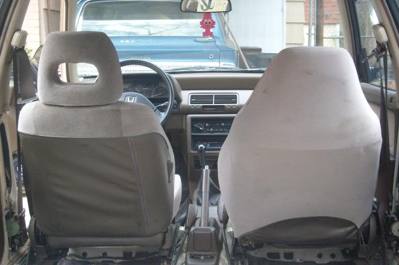

Finished product. One has a seat cover and the other doesn't at the moment.

I just need to clarify. When your swapping the seat rails...... Are you swapping the entire rail by unbolting them from the side of the seat? I've never done much work with honda seats so I'm new at this. It looks like you can unbolt the slider section from the bottom of rails also.
could you just clarify this for me please.
Those brackets are sweet!
Only thing I don't understand is why didn't you just drill a second hole on the inside rail for the back bolt? What does the custom bracket on that side accomplish?
I'm sure i'll figure it out once I get to that side.
