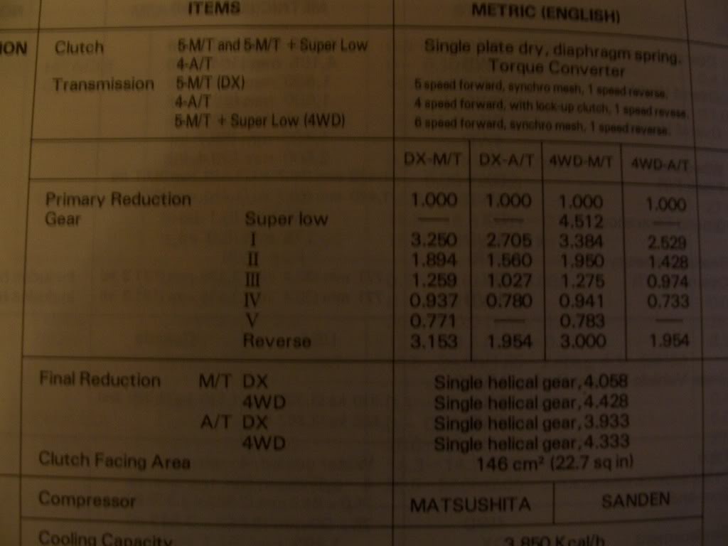

to add it to the listing, can someone post the gear ratio's of the wagon transmissions, also, the jdm zc trans?

I am working on transferring all that information to a spreadsheet so that when the information becomes available I can edit it. Right now it is just a snap shot of a table somebody else put together.
I got about half of it done so in a couple more days I shoudl have it finished so that new information can be added or wrong information can be changed or deleted.
