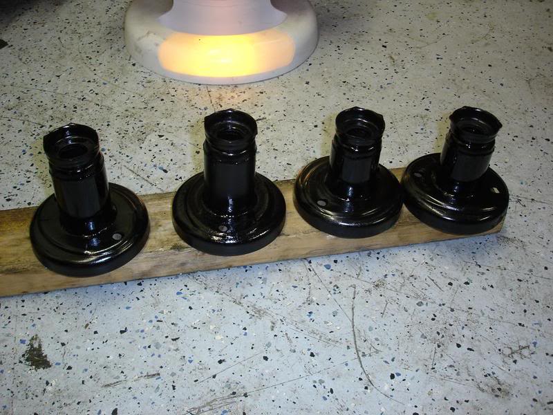

  • As far as using a spacer. I, before ever pulling the struts off, I made the spacers. A length of tube with a washer on top.
    As soon as I pulled the tophats apart, and saw how the bushings, sleeve, etc all worked with each other, I ended up not using them. I didn't think that using what would end up being a solid strut mount, would be a very good idea.
    The spacer would also have needed to been welded to the original tophat.
    = don't waste your time with trying to use a spacer!
    knock out the studs, cut the tophat with a sawzall, weld in a chunk of 1 7/8" exhaust tubing, paint, put the studs back in, and your done.
    I did the job, start to finish in about 4 hours. It only took me that long because I'm a stay at home dad. I've got my 5 year old son that hangs with me while I'm doing all this stuff. So that means lunch breaks, breaks to help him with stuff, etc.
    If I were do make a set, including the time of taking them on and off the car, without any distractions, I'd say it would be a 2 hour job.... that easy!

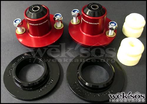

    I want to get these Gound-Control Top Hats for my front shocks and sum modded top hats for the rear shocks. GC got them on sale for $119/pair. I know its expensive campared to modded set but you got to admit these are nice!

    The ground control parts are really nice, but making them is even nicer for those of us with zero money in thier wallets.
