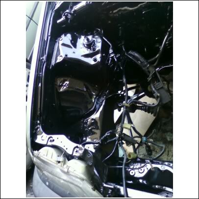

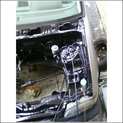

Welp i finally got a camera to use today. So i can show my incomplete wagon. Its too cold outside so im just working to buy the part so when the first day of spring comes i dont really have to worry about buying much for my wagon and itll be warm enough to work outside. I have everything except the engine locked up at storage post till then here is where im at.

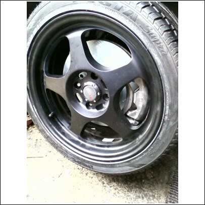

Kumho Escta 205/40/16 tires and 16x7 Drags 40 offset.

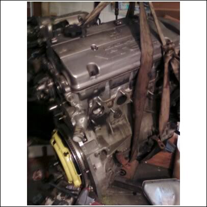

h22a baby

h22a baby

Bought re-drilled prelude rotors and modifed a fastbrakes caliper adapter (meant for integra calipers) to make Acura Legend twin piston calipers work.
H22 up in the air. Literally and figuratively speaking. Its currently in the engine bay. But I wont be proud to show pics until the wiring is done, so just imagine spaghetti until then.
