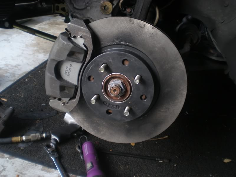

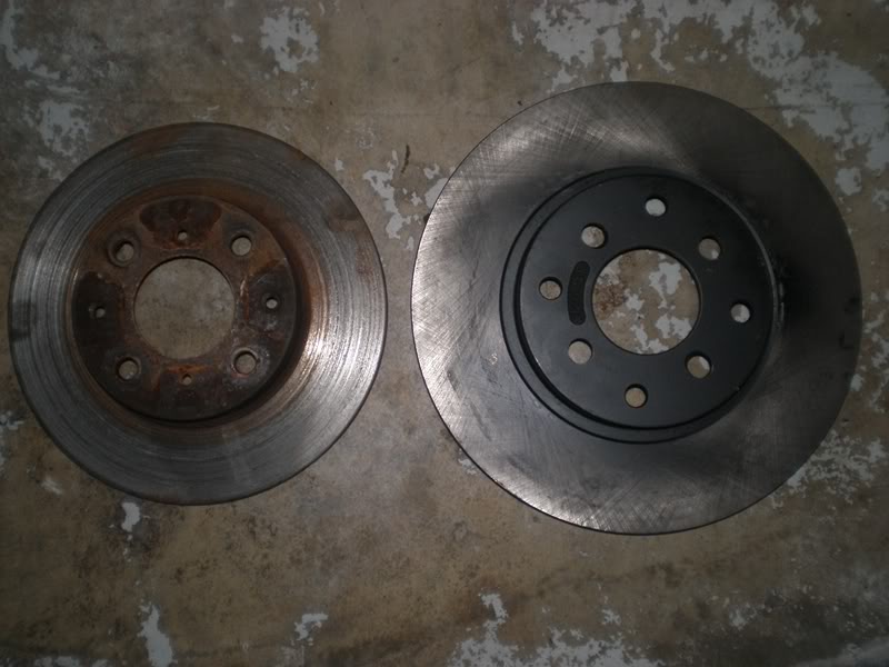

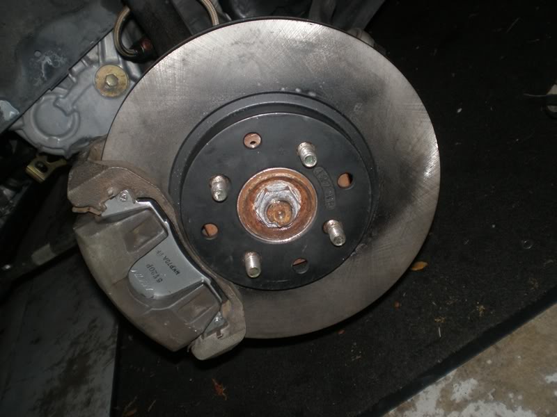

The end result will look like this:
"This is the biggest OEM brake upgrade that will fit under a 15in rim. The difference is literally day and night. The kit came with everything i needed to simply bolt right on, and everything went on smoothly.
I highly recomend this kit for anyone thats looking for an OEM brake upgrade."- B18C-R(EG)

21. Enjoy having stronger than Type-R brakes without having to source and install new steering knuckles! Enjoy having the ability to stop your car at high speeds without fading all the time!
by BrakeExpert on Honda-Tech
Feel free to ask any questions or IM BrakeExpert on Honda-Tech if you need parts/machining for this setup

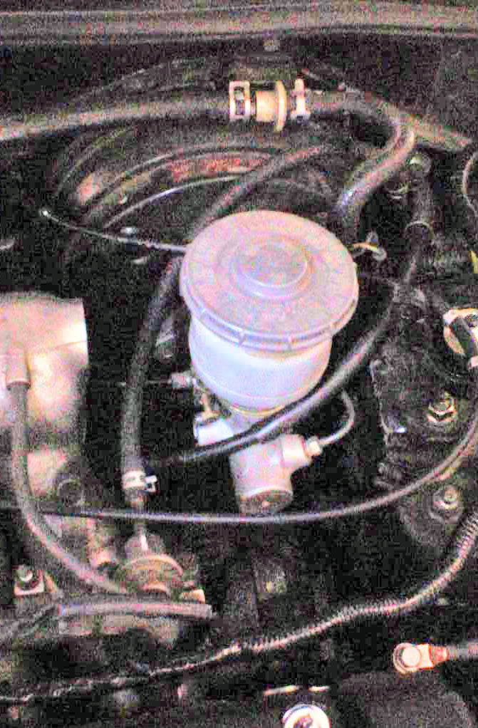

klum's answer:90-93 Integra 15/16'' MC/booster(non-abs).Check for booster clearance.DC 1" MC/booster,BUT you'll need to rebend one of the hardlines & watch :shock: far booster clearance probs during installation(I think).

89 lxi accord? 15/16? or what boosters work for that matter
integra 90-93 mc/booster direct? or will i have issues ?
These are the rotors (I believe Haydz) and I are using with odyssey/prelude calipers
http://nzhondas.com/tech-help/130317-poor-man-s-type-r-brakes-upgrage-your-da-ef-dc-eg-straight-bolt-no-grinding-no-re-drilling-no-spacers.html
