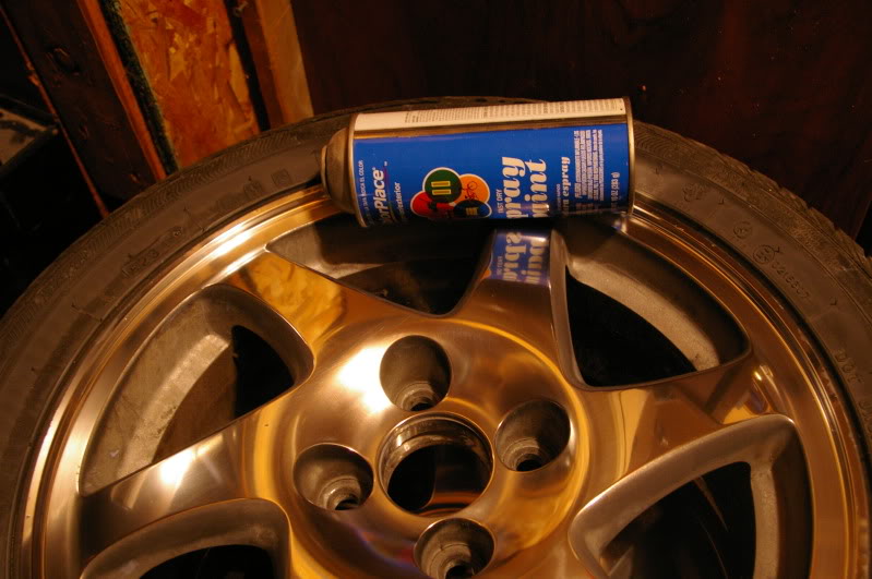

Here is the rim with the center removed. Clear coat is not the greatest with some corrosion starting behind the clear. THe rims are probably about 15 years old now.

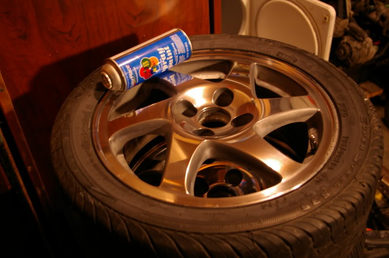

So I went and bought some Zip STrip from base since this is the only paint remover they sell. Got a used paint brush and brushed it on. Don't be skimpy with it as it isn't expensive. Once it goes on it works quick and the clear will start to bubble up right away.

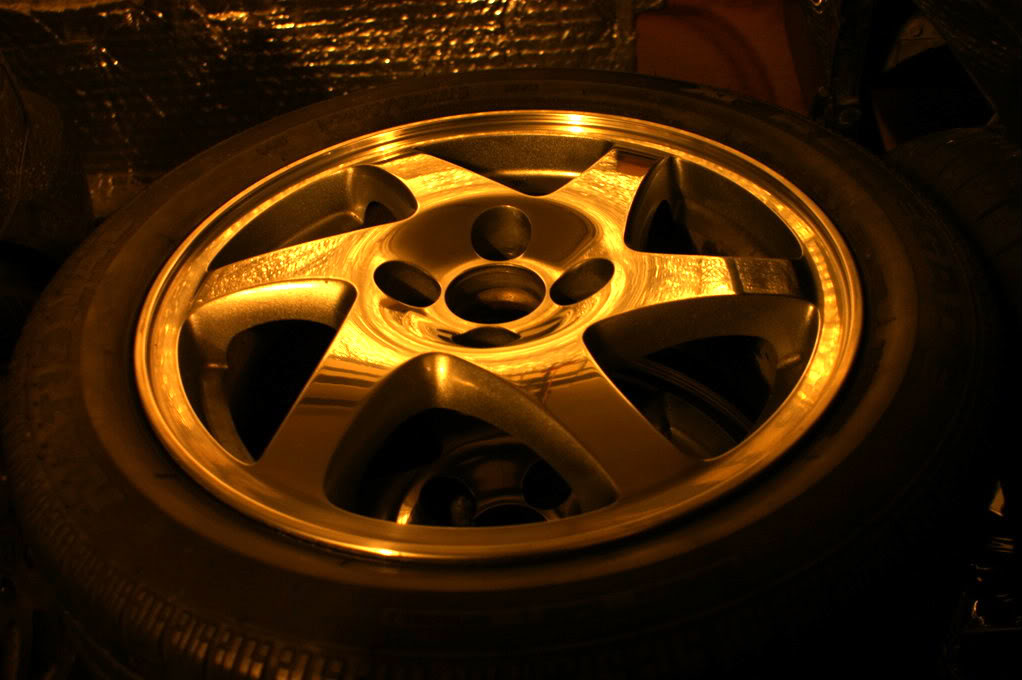

Here is the rim with no clear anymore. I got a bad sponge and soapy water to clean the residue off.
I then used 1000grit sandpaper to clean it up. My wheels had machined grooves on the lip and I wanted to sand those down as best I could.

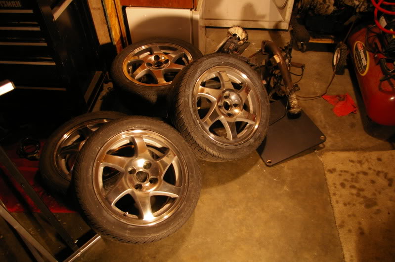

I then took the polish and slopped it on the rims. Again don't skimp here let the polish do the work for you. I spent about a 45 minutes on this rim. I got the drill out with the pad on it and just started running it around.
Here is a side by side with the other rim that was in the same shape.
Super easy to do and doesn't cost a lot. Just requires a lot of your time. Just like everything else, the better you prep, the nicer you sand, the better your end product will be.
