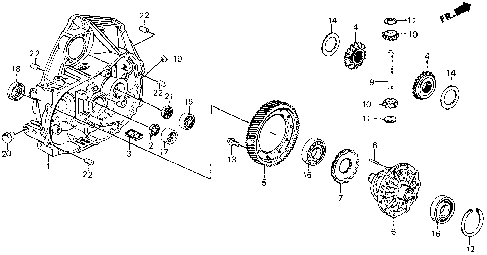

    can you tell me which part number it is? i was thinking its 15..or 16??
    1 CASE, CLUTCH
    2 PLATE C, OIL GUIDE
    3 MAGNET, TRANSMISSION
    4 GEAR, DRIVE PINION
    5 GEAR, FINAL DRIVEN
    6 CASE, DIFFERENTIAL
    7 GEAR, SPEEDOMETER DRIVE
    8 ROLLER (4X28)
    9 SHAFT, PINION
    10 GEAR, DIFFERENTIAL PINION
    11 WASHER A, DIFFERENTIAL PINION (0.7MM)
    12 SHIM A (72MM) (1.0)
    13 BOLT, FLANGE (10MM
    14 WASHER, THRUST (34X48X1.5)
    15 BEARING, BALL (26X52X15)
    15 BEARING, BALL (6205UC/26) (NTN CORP.)
    16 BEARING, SEALED BALL (6207) (NTN)
    17 BEARING, NEEDLE (30X47X21) (NTN CORP.)
    18 OIL SEAL (35X56X8) (ARAI)
    19 DUST SEAL (16X21X4) (NOK)
    20 OIL SEAL (14X25X15) (NOK)
    21 OIL SEAL (26X42X7) (NOK)
    22 PIN, DOWEL (14X20)

    Make sure the oil level in the transmission is at the correct height. This is the reason 99% of the time that the ISB goes out. You need 15 (the bearing) and 16 (the shaft seal). Don't change the bearing without changing the seal. If you do, you can bet that once you have it back together, and nice and quiet for a couple months, that the seal will start leaking oil all over your clutch.
