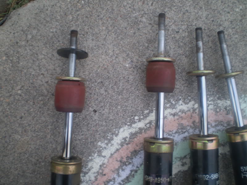

Tophats maybe needed if you plan to lower your Wgn more than 1.5''(38mm) to save the shocks.It allows more shock travel cushion.There are services out there that will mod your OEM tophats.I've seen aftermarket tophats ,but they look like they were meant for coilovers.If you plan to mod your own read the following:
+++SiWagon FYI: Tophat WARNINGS & Specs
