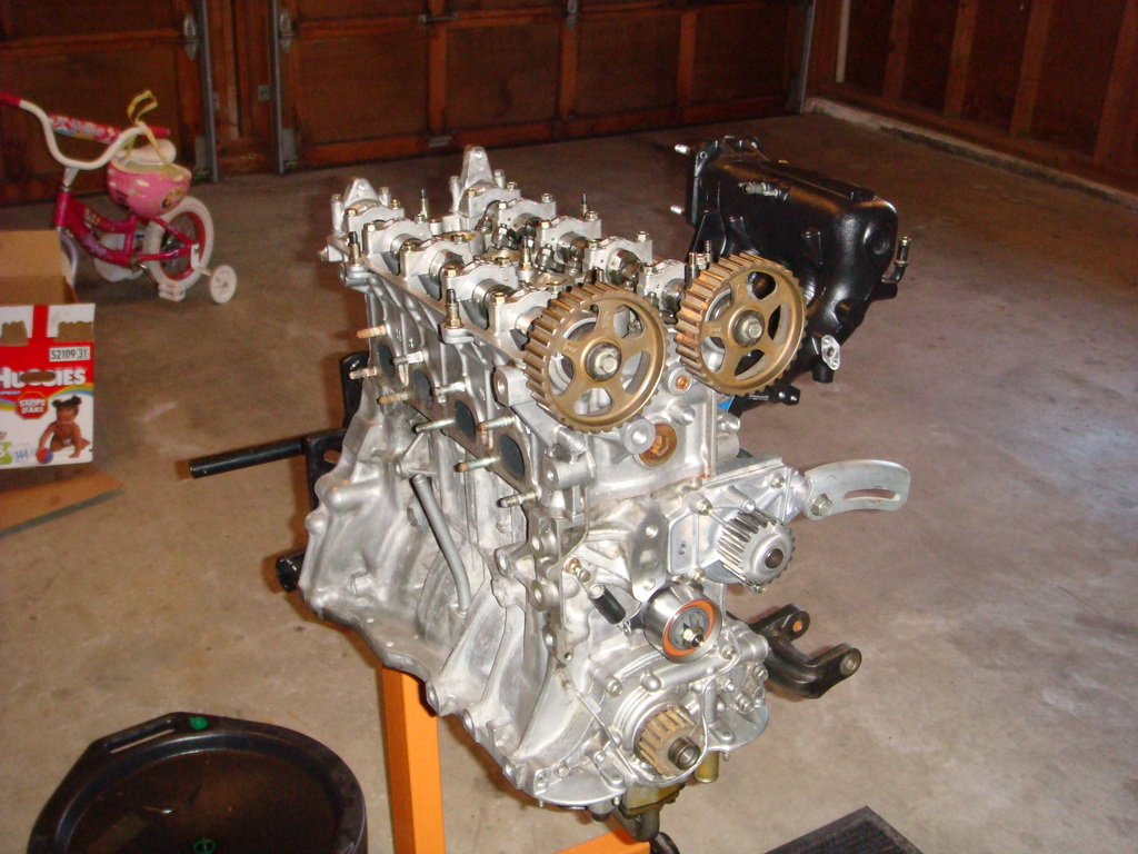

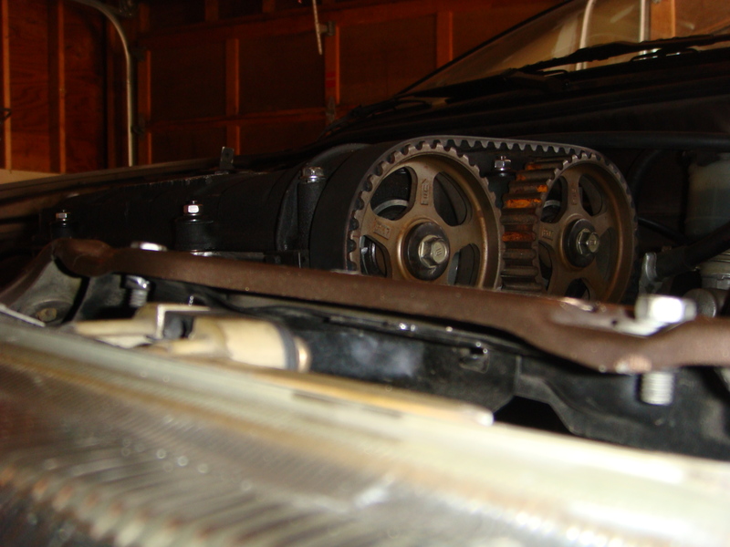

Teaser Pics :P
^ don't mind the previous PS leak :oops: Once the distributor is wired in and I get a chance to do a once over with a clean rag I'll put some better bay shots up.
Motor was in last Saturday after working on it a couple of hours Friday and hitting it hard Saturday(By hit hard I mean I was drinkin Friday night and didn't get to bed til 5am Saturday morning, got around to waking-up/working on the car about 2pm Saturday and stopped around 9pm). Busted two lower exhaust flange studs and forgot to get the Integ harness clips so I can wire the distributor in nice and tidy, so it sits. A weekend visit to the parts yard and it will be on the road. Ditched the A/C and PS, ran lines from the PS rack to the PS resevoir to keep it lubed until I find a Si steering rack.
ZC should be pretty spunky with a 7lb flywheel, underdrive pulley, 10:1 Cr and some other odds and ends. Probably post some video next week or so.

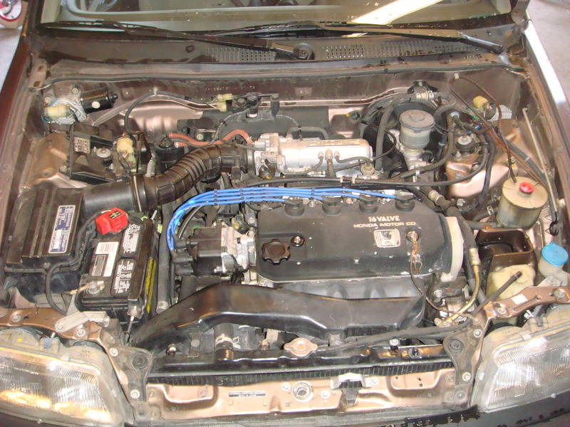

Either way, the motor setup looks great, but passing on some info as a heads up. Painting the intake manifold is a kinda a no no unless its anodized. Paint/powdercoat holds in more heat, So your not suppose to color them. Not knocking at all cause I think it looks badass, but thats what I was told when I wanted to powdercoat my intake back in the 1900's.
Also, our Si CRX has power steering. Dunno if we got one that someone optioned out or what, but we didint install it.
I just did a light coat of trim black so it shouldn't retain too much heat plus I'm running a Hondata gasket so that helps too. I just figured the CRX's didn't come with PS because none of three I've owned had it but I'm sure it was an option. First Honda I have with PS is my Rt4wd, would've kept it but its easy to hack out the PS than find a DOHC ZC PS bracket .

Alright, ZC is in and running top notch! Besides having to get a new dizzy everything went fine. As always had a fun time getting the EACV working right when the coolant was drained from it. I swear they get air trapped in the coolant lines right there because anytime I get idle problems I just unbolt it from the intake mani and tip it up side down. Works like a charm! I filled the motor mounts with black silicone which stiffened them up quite abit but even with the motor running super smooth I can feel it. No more clunks in the rear end though. Not having PS isn't that big of a deal and it actually makes it feel like the front end isn't so loose, it feels more connected to the road. Definitely notice a difference using a lightened flywheel eventhough the the RT gears are short, the RPM's don't carry too much going up hills. I haven't taken it past maybe 4500-5000 but I can tell that this motor will love to be in the high Rrrrr's. The OG D16A6 that came out still had some pep but it can't compare to this motor one bit, the sound alone is amazing. Still running the stock exhaust and a hacked stock airbox but it does well. Gotta get rid of the PM6 fuel/ignition maps and I should be rockin.
Is the PM6 ECU the one that comes with the stock A6 motor?
I used a D16A1 ECU for mine. Swapped the guts with the stock computer, so it would mount under the floor board correctly. When I did mine (granted it was 4+ years ago) I read that guys were using their stock A6 ECU's to run them. Though I never tryed/tested this.

Not waiting on the ECU anymore, the car is done. Now I'm just waiting on the 500 mile mark so I can do the first oil change since I swapped in the motor.
