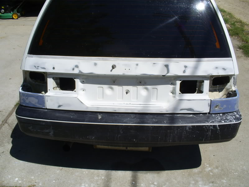

here are the pics of the read hatch and whole car on day 3

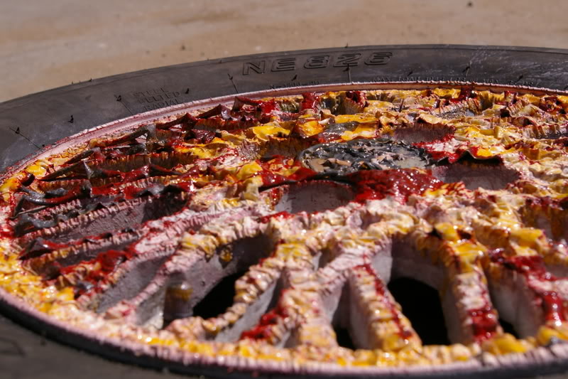

i was bored and decided to see how much paint was on the wheels to i rubbed some lacquer thinner on one of them and this is what i got to see

today i didnt get much done. had to restock on materials. so spent a few hours doing that. i also piced up some paint stripper for the wheels i have onlly done one so far it takes a while to go through all the layers of paint on the wheels here are some pics of that wheel
here it is after all the paint is gone
i like it like this

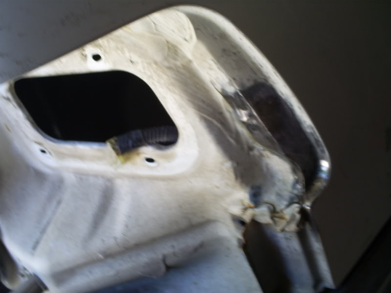

on rusted areas (rear wheel wells) dont have a welder so dint want to do replacements so i cleaned it up and took some all metal to it here are pics of bothe wheel wells and drivers rear quarter panel and the driver fender as well i have 3 spots left that i need to get done then she will be ready for primer. (almost for got will also be going over all the filler with a glaze coat to fill in any small holes. but here are the pics.
rust is gone
fender
hatch

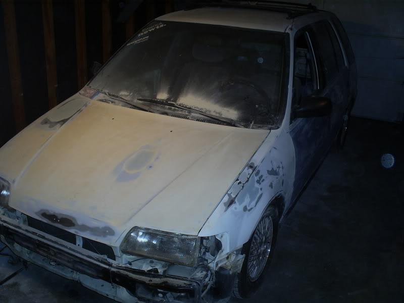

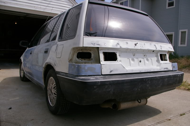

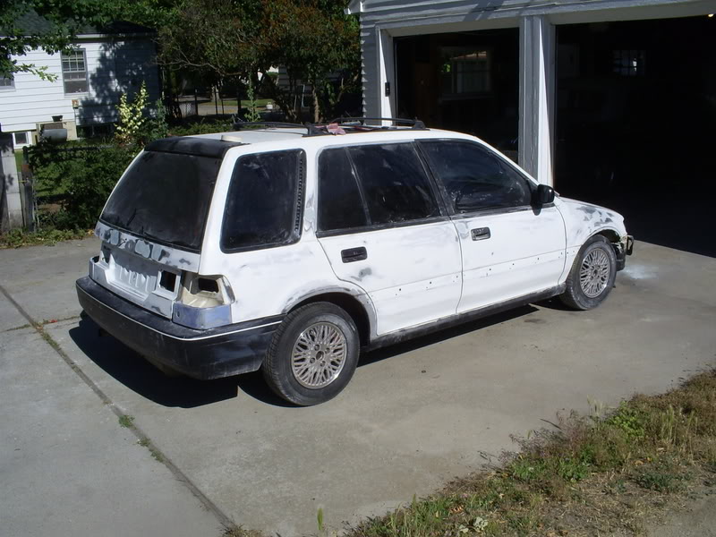

7-8 ****done with body work****
the last thing i need to do is swap out fenders and then bam! ready for primer here are the pics i took right now more to come when there is day light.
under a month on the body work
here are some pics form today pushed her out in the sun to take a few pics
rust is gone
fender
hatch

like?
the last pic above is what i got today
