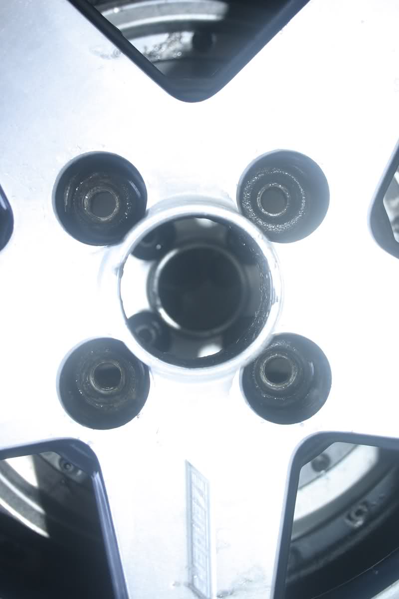

so, i picked up a set of Zender wheels made in germany, blah blah for $80 with brand new tires from a junkyard deep in the woods in the Georgia country. lolz...
my issue is, i cant get them on my waggy cause the lug nut pattern was a tiny bit bigger... so i figured "hell, they are 4x114.3 lug pattern" so me and a friend tried to get them on his 240SX but NO they were too small :?
so um, wtf lug pattern are they?! 4x112?? and is there anyway i can modify these wheels or get an adapter of sorts to make them fit on my wago? these rims are really hot and i'd love to rock them. anyways..

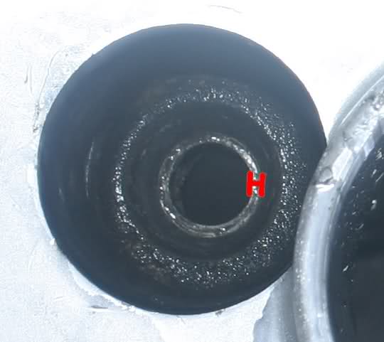

the red is showing how much extra metal there is after the dish-shape of where the lugnuts press up against... savvy? if that extra bit was drilled away these wheels could fit. its only like 2 mm off. so if i took off 1 mm on each lug hole... it could work...
they dont just drill. they have to close up the hole. then they drill a new set of holes. you cant use existing holes and enlarge them. if your not enlarging them and end up making other holes, measurements need to be precise. when they drill it they are measured from the PCD to the exact outter diameter of the wheel hub. wheels are not something that i personally would do myself, for safety reasons.
if you do end up doing it yourself, good luck. let us know.
the only other advice would be, if you do end up doing it and it wont be precise, to help with the wheels from not rotating off center you should get HUB CENTRIC RINGS. the rings will help a ton from having the wheel from being off center.
i know it seems very minor for such a mod, but a lot of accidents happen cause of minor things.
for cost you could just do it, but youll need to get hub centric rings.
the rings are about 25.00 for the whole set of 4.

rage, i believe they are 4X110 or 4X108, the dude who i got them from said they came off a Ford Escort..? idk if he was correct though... anyways.
anybody know of hub adapters for these?? i know they exist for 4x100 -> 4x114.3 but does that make your wheels stick out another 1.5 inches or so. anyways... i'll so some research tomorrow. right now im sunburned and damn tired. lolz... :roll:
http://www.ezaccessory.com/Wheel_Adapte ... 0-4425.htm
how do i measure the lug pattern....? from center of the hole to the center of the next one over or across?
