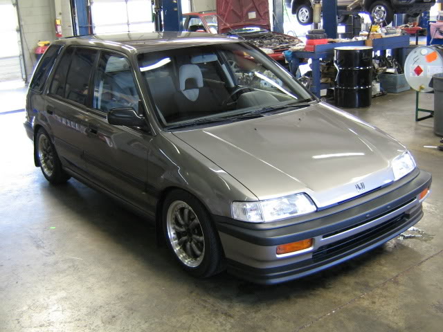

Here's a few pics:
Front camber:
...and the car sits this low:
BTW I've got DA front knuckles/brakes too.
saw the camber kit and im jealos. i got vison works and i hope it does work too.
whats your coilover?
Eibach Pro Street for the regular EF sedan/hatchback.
They are amazing as a daily driver, softer rate set-up, but they would suck for auto-X because they're too soft for true motorsports usage IMO.
At that ride height it rides so smooth it's ridiculous.
