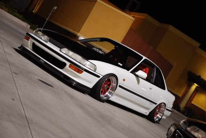

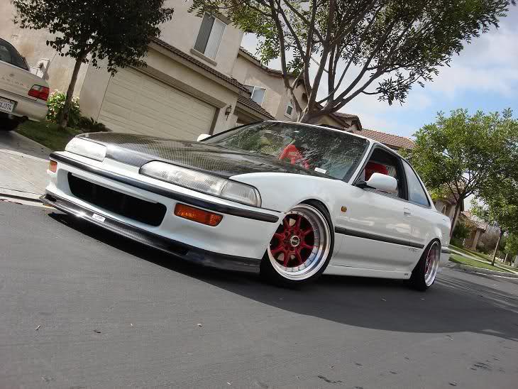

  • Good luck but here is a pic of some 16x8's with a 0 offset to give you an idea of how much is going to stick out. This is with the car jacked up. I kind of wish I would have had tires on the wheel to get a real look at what it will look like but some fender work will still be needed.
    :arrow:
    15x7 front 15x8 rear sportmax (xxr) 501
    16x8 sportmax 002
    god damn that DA looks so sick. i was also looking at these "konig remembers" that will fit for damn sure....
    those works look so damn good, i think those are what i would prolly get.
    Remember those are not available in LOW OFFset style.

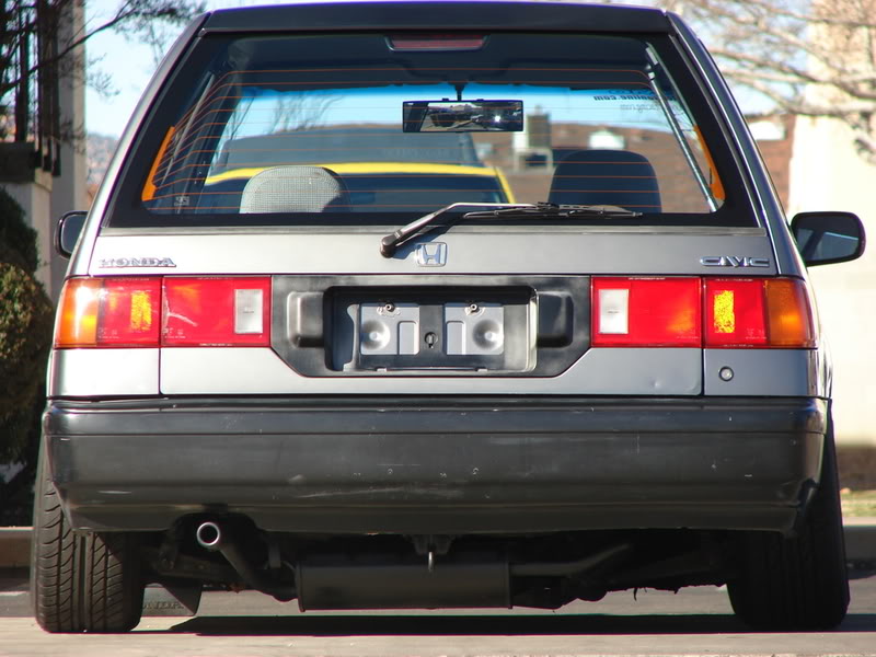

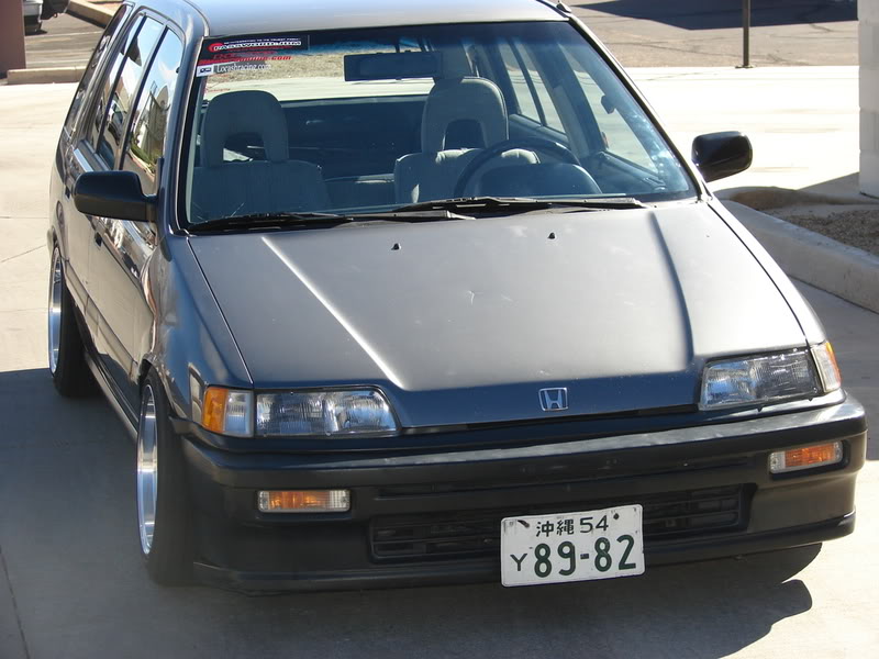

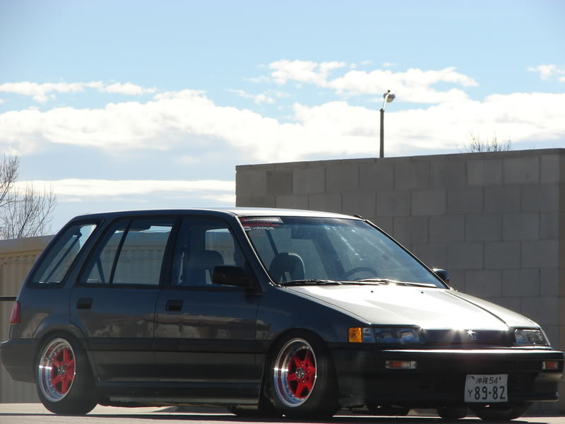

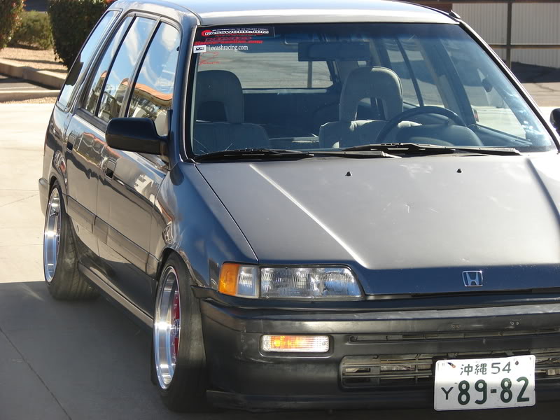

  • here are a few pics of mine on my wagon and its not to bad to fit them.and i just rolled the front finders and the rears are stock i HAVE NOT TOUCHED THEM AT ALL.
    whats ur tyre size..???
    those look sick as hell mayne.
    they the +15 offset though right?
  • ep3royalty wrote:
    205 50 15 for now but get some 195 45 15 down the road
  • those look sick as hell mayne.
    yeah there the +15 offset ones and thank you i havent had 2 much feed back to see if people like the car or not so thanks

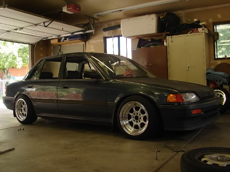

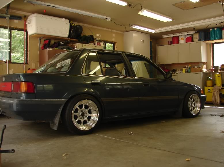

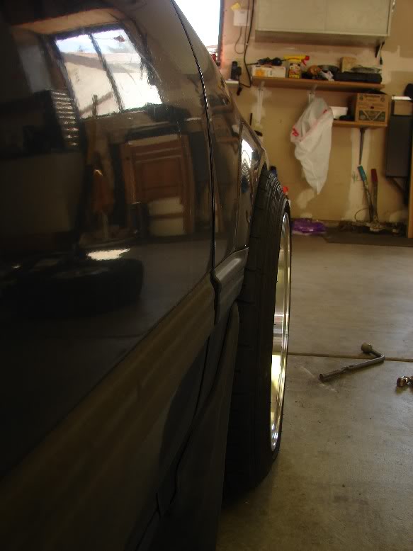

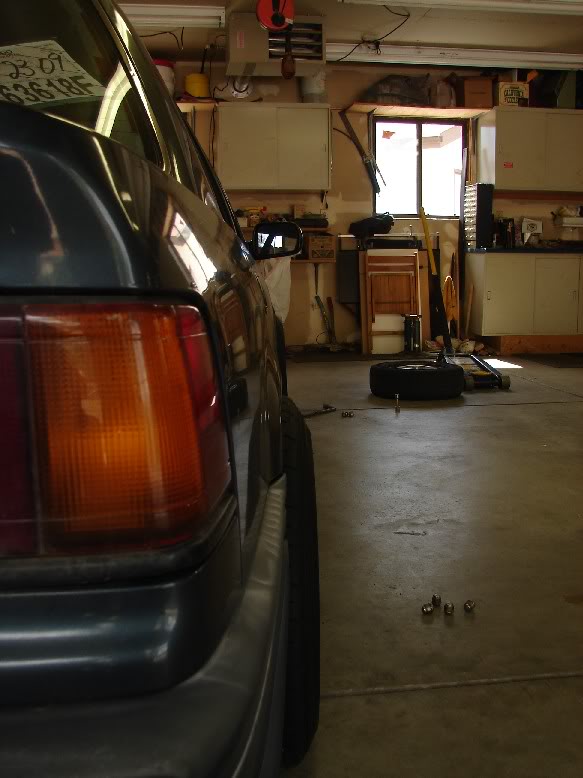

    i ordered a set of 15x8 zero offset 002's that should be here tomorrow.
    gonna put them on a EF sedan and slam it. ill get pics up when its all done.
    alright here is a teaser. a little camber in the front and perfect in the rear. im all the way down on my PIC's too. no fender rolling at all.
  • you need to camber in all of them imo
  • Have you tried to drive it like that yet? It looks like every time you hit a bump you are going to rub.
    no its just a test fit. i know they will rub like crazy as it sits.
    i jhust wanted to see how it looked if i just put them on without doing anything.
    i should have the fenders rolled today and cambered as well. just waiting on lug nuts to do this.
    It will look sick when you're done!
