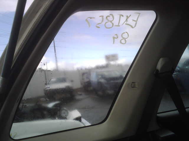

There was a bar across the rear side windows that I've only seen on 88-89 models. Can anybody confirm this?

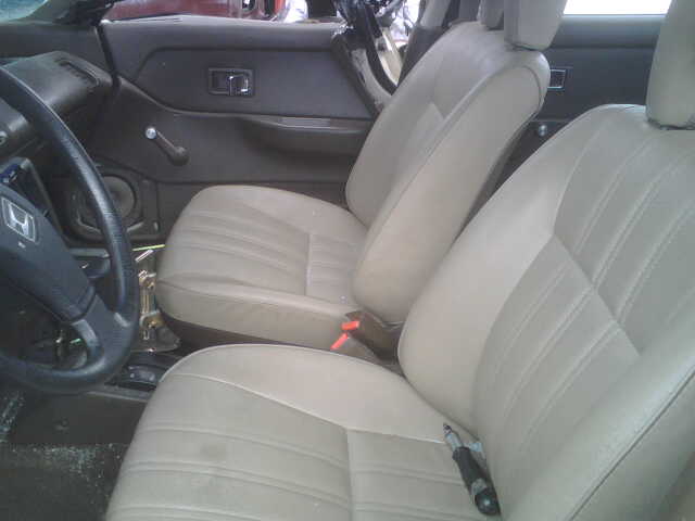

I guess this would explain to me why I've seen wagons listed as 1989 models with 60/40 split and clotch seats, and others listed as 1989 models had vinyl seats and the bench fold down rear seat.
Pretty cool stuff.

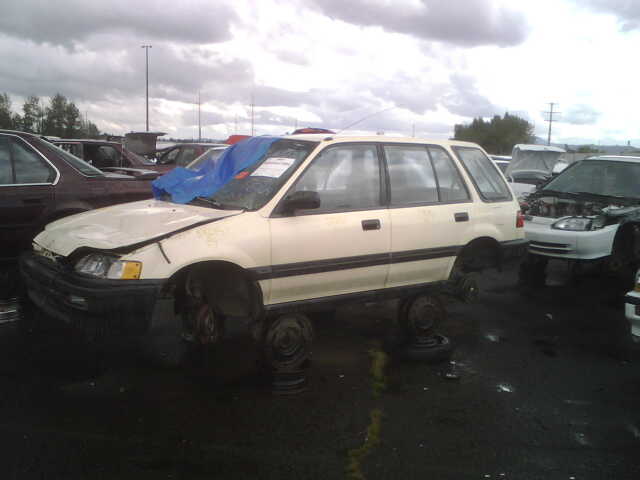

88-89 "Wagovan" rear seat:
88-91 "Except wagovan" rear seats:

ok, so i thought that the jailbars across the rear windows were wagovan only, but if wagovans were only 88-89, were they on all those years, or just wagovan :?
hey TIMELESSWHITE, does your wago have jailbars?
Yes, mine has them. I thought about hanging window treatments on them, but they are mounted too low!
