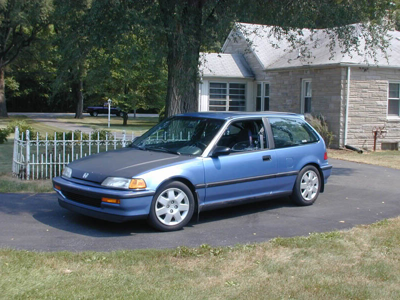

we have a project hatch and are wondering if we could use USDM headlights and bumper filler with a JDM Si-R hood....
  • they are quite different. If you only use your jdm hood, there will be a big ugly gap. If you get jdm headlights and filler, then use your usdm bumper, there won't be a gap.
    looks like this: (my old hatch)
