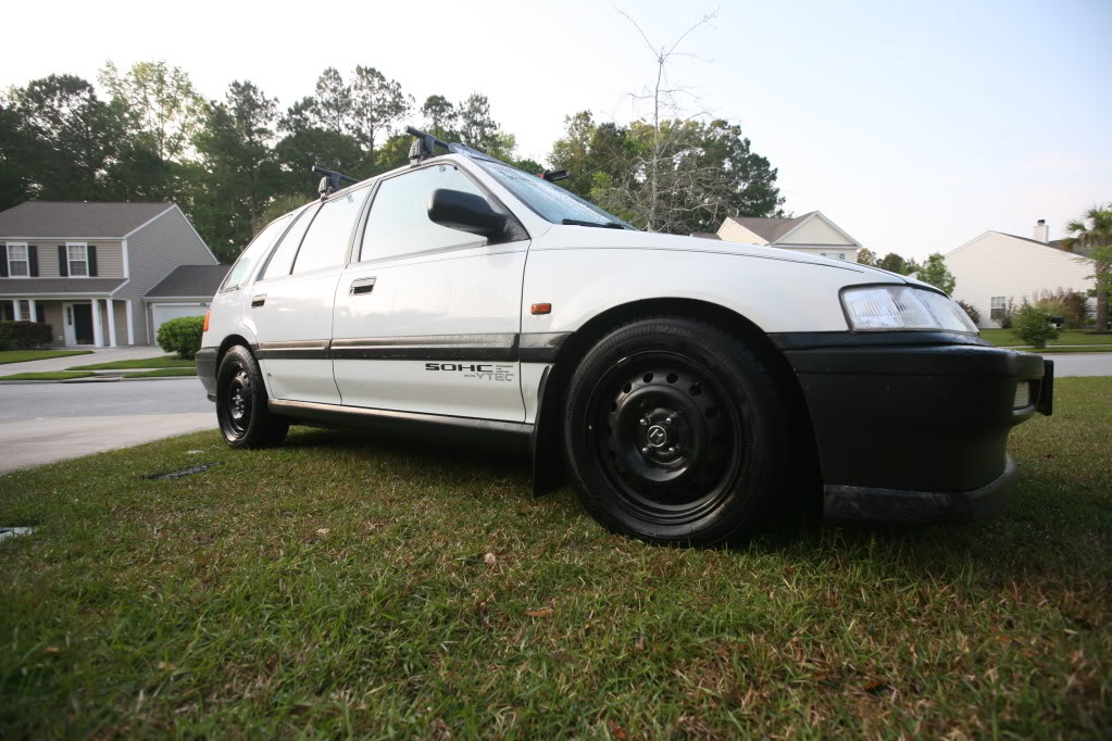

Im in the process of lifting my wagon, I really like the steel wheels look but dont want to buy Bassett steelies...... I found that 06-10 Chevy cobalts have a 4x100 15x6 steel wheel with a 65.1 center bore and a 12 or 18 vent set up. I figure with some hub rings you could have a 215/75/15. Has anyone tried this? I would also really like to keep my center caps too. Let me know!
