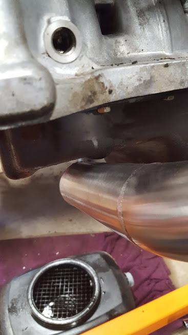

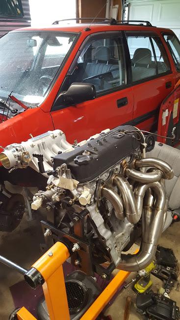

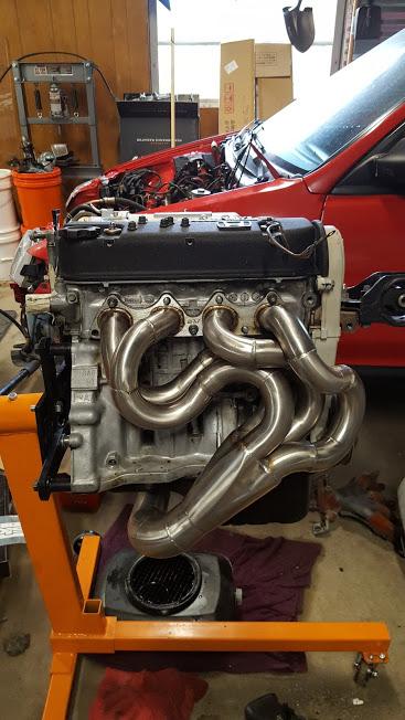

  • The PLM headers seem like they would work well and the ones I'm going with. Because the D-Series headers don't have a flange on them you need to do some welding work anyway, or have it done and the extra work won't be too bad I think.
    Here is how it sits stock:
    I'll have some more posts up in my build thread once the exhaust starts to get worked on.
    https://www.privatelabelmfg.com/category_s/50.htm
    They are $450 so you only need to go this route if you want to squeeze out max NA power, but it's another option that I think would work with minimal extra work. Oh...no PS or AC though. :P
